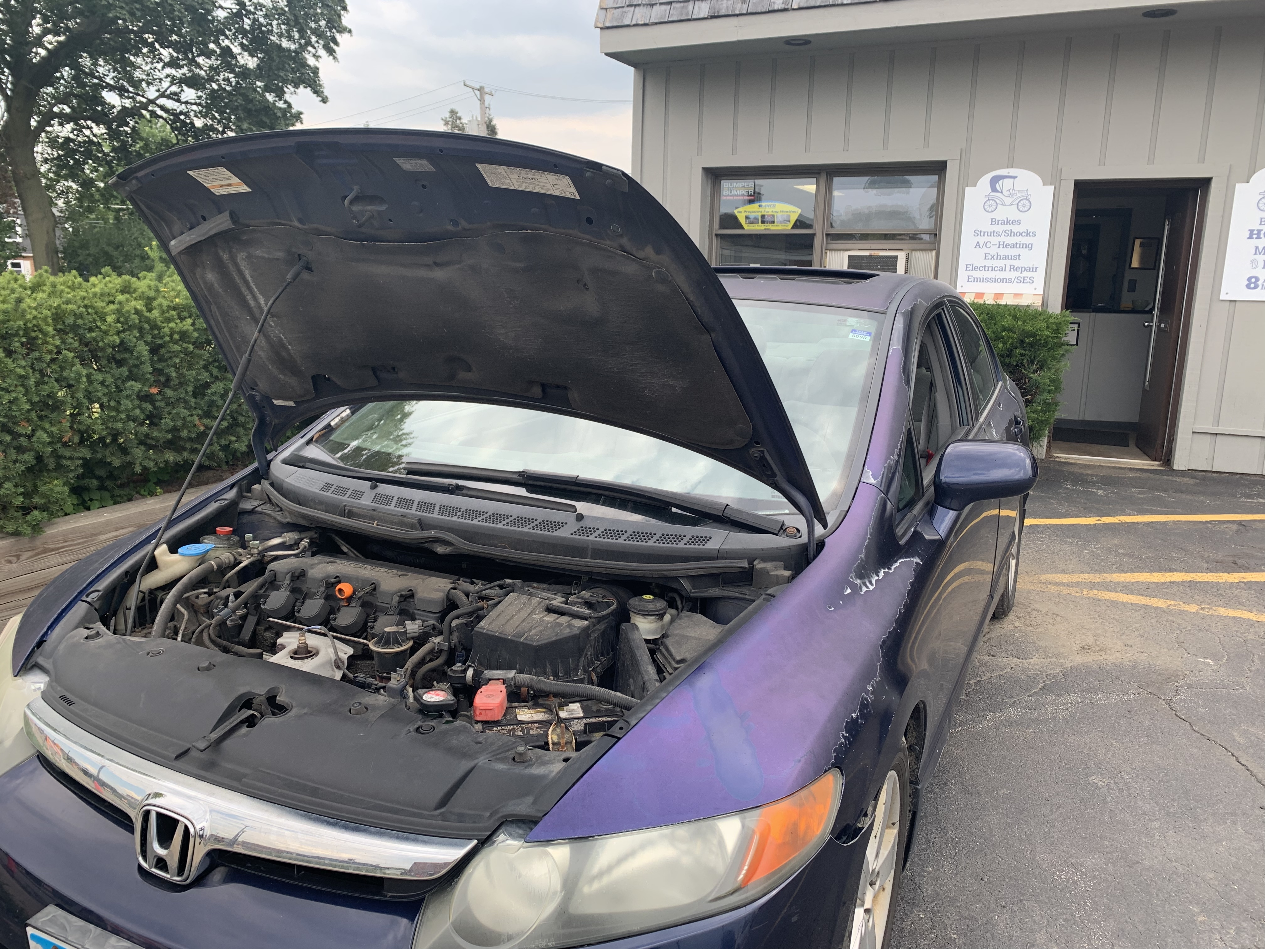

    not sure how it cracked. Saturday it started pissing coolant and i was able to limp it back home without it overheating too much (didn't hit the red). The thermostat was siezed so that got replaced and it seemed too fix the issue. No more leaking and no more overheating. Well this morning on the way back from dropping my friend off at work it started overheating and leaking again so i let it cool off and limped it to the shop which is where i am now. So now im looking for a cheap used car. Not opposed to going to a dealership and getting a more expensive cheap car and putting a sizeable amount down and have small payments for a year or two. Would prefer a manual transmission but I can't be picky in my circumstance. Just need a reliable beater that I don't have to sink money into.

    The blocks cracking and leaking coolant was one of the few issues with the 06-11 body style civics. And I speak as a former master Honda tech. Unfortunately you would be long out of the extended factory warranty for that issue (which was 10 years, or 125k (but possibly unlimited mileage; no joke - I can’t remember the specifics though).
    If you would get it fixed (only fix is a short block or used engine) the heads are pretty stout. They would rarely warp even if overheated due to coolant loss.

      Unfortunately it has wheel/suspension issues too so the cost to fix both would be more than the car is worth. It has a lot of other small stuff too so id just like to get something else. it has 147000 miles on it and 10 years have gotten behind it so thats a bust on honda doing anything free

              Sorry to hear about the suspension issues as well. I understand the situation though. The info I gave was merely for background. I had a strong hunch that the cost of repair would outweigh the value at the point even if it was just the engine. Just wanted you to know why the block cracked because that is generally very uncommon... except for those civics.
