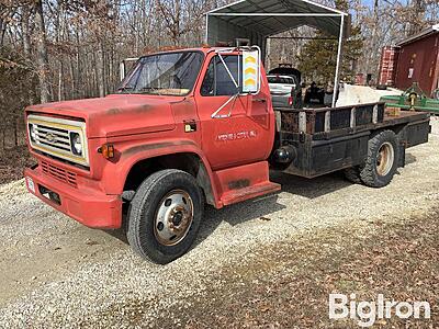

    Yes, you can tell me I am crazy. You won't be the first.
    Last year I bought a deckover trailer. It was shop built and balanced to far forward. No so bad, but I have yet to have a heavy load on it. This trailer empty had my Yukon rearend squatting low.
    I may be hauling a tractor or backhoe, so I wanted something that shouldn't have problems towing it loaded. Enter a 1980 C60 flatbed service truck. I am waiting on the bill of sale and title before I go get it. It's a V8 with Hi-Low 4 speed. I am not counting the cable winch or the 400amp welder to actually work... that would just be a bonus. Besides the obvious oil change and maybe a quick tune up what should I do or at least check on this thing?
    https://www.bigiron.com/Lots/1980Che...edServiceTruck
    1980 Chevrolet C60 Flatbed Service Truck on auction | BigIron Auctions

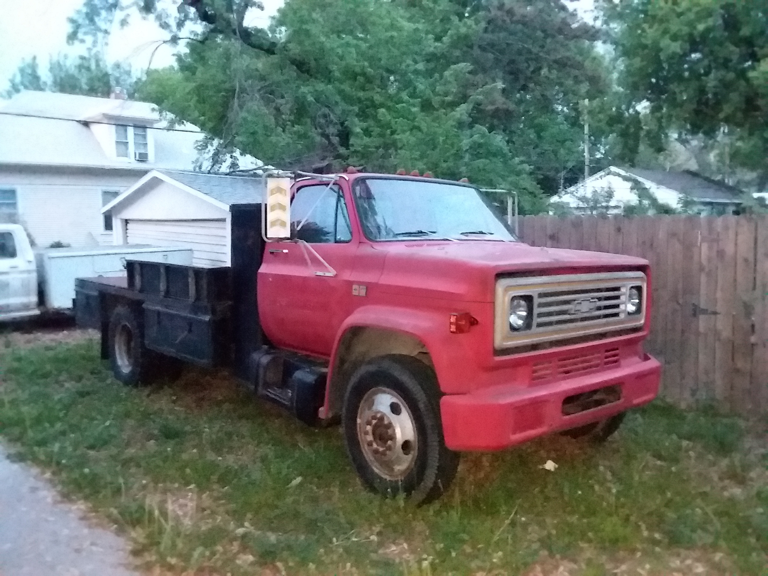

            Update: Many gallons of gasoline and a full day, the truck is now home. It was a five hour trip east. It took a bit more time going the other direction.
            The two spares we took would not fit. So off came both back passenger tires. An impact socket, long break over and a 6' pipe managed to break the lugs free. Out came the sledge hammer, pry bars, and even a front end tractor bucket. My helper for the trip managed to safely change a split rim even though he had only seen it done before. After everything was said and done the old tube held air. It may have just had a slow leak.
            Kyle drove the C60 back. During daylight hours we were sometimes maintaining an even 70mph going west on I70. Kyle really, really likes this truck. He said it handles just like a big pickup instead of a lumbering farm truck. I told him he cant have it.
            Have not checked either the winch or the welder yet. Also, the truck looks like it may have sported a jin pole at one point. It looks like it would be relatively easy to fabricate. One of the boxes holds the pulley and axle for the bracket at the front of the bed that is higher than the cab. There are pullies and some other things that might be able to rig up a snatch block.
            The body metal is mainly straight and relatively rustfree. Click image for larger version
ID:	402357 Looks like learning to paint a truck might be on tap this summer.
            While not new, the tires still have plenty of life left in them.
            Seat could use a little new foam and a new cover.
            All in all, this beast is in nice shape, especially for a forty year old truck. Will be doing an oil change before it gets driven very far. Will be having somebody more knowledgable than I check out the welder.
            Happy wIth purchase, but now have too many trucks. Anybody near Manhattan interested in an '88 Chevy half ton? ;-)
