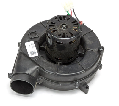

    I've got a Trane TUY100R9V4W4 furnace, that I just had the local HVAC guy come look at. He said the Inducer motor is on its way out and needs to be replaced. He quoted me over 1000 bucks for the part and replacement plus $119 travel charge.
    Being kind of handy, after he left, I took the panels off and looked at the motor myself. It looks like a pretty simple installation, 4 bolts and a couple connectors.
    If I do decide to do it myself is there anything I need to be aware of or is it as straight forward as it appears?

    Not an expert, but looked over the shoulder of a couple AC folks over the years... You may want to double check if your HVAC has a capacitor attached after you shut down the unit. Might get quite a shock as you try and dismantle the thing and the capacitor still has life in it.
    I might suggest getting a quote from elsewhere and save you the trouble.
    Edit, here's the part you could buy yourself... doesn't look cheap: https://www.repairclinic.com/PartDet...T16582/3276784
