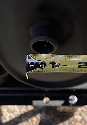

    Do you know what size the exhaust pipe is? That might be the easiest way. Find something like a moped or ATV muffler that's the same size, connect with house clamps.
    You might need to swing by a muffler shop to have one of the pipes enlarged slightly to slip over the other
    • Blackmagic71
      • 907
      Looks like it’s about 1”.

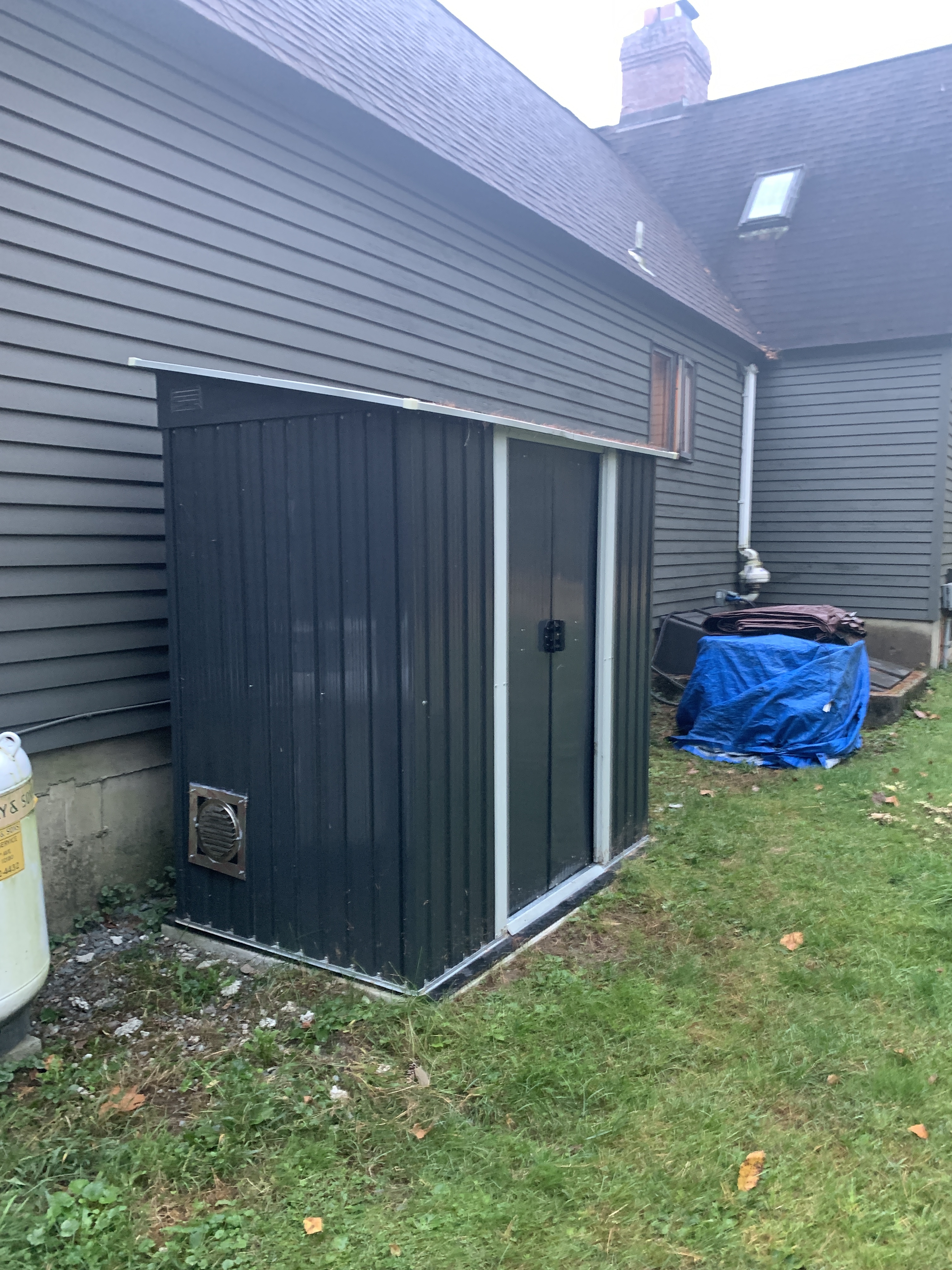

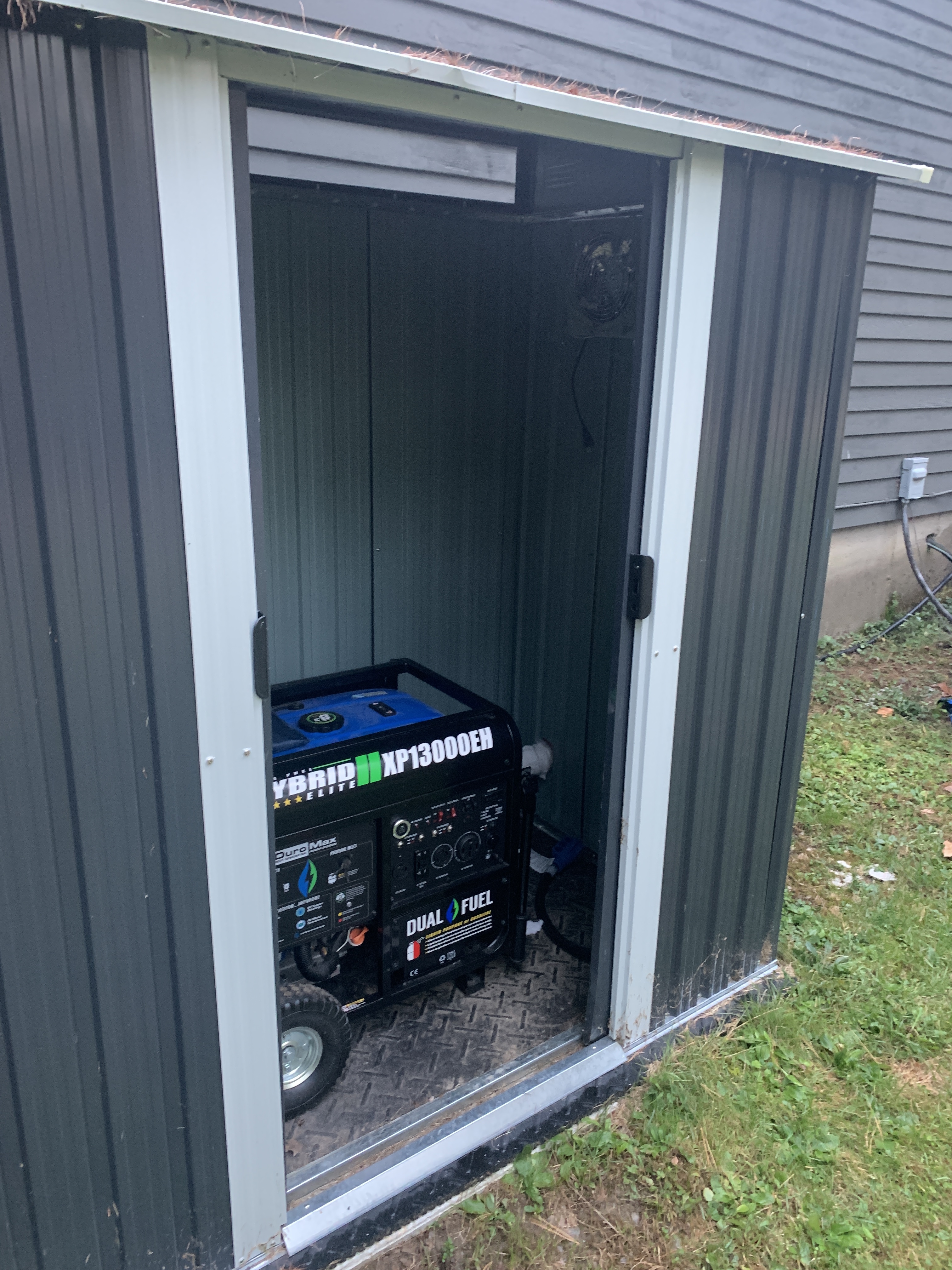

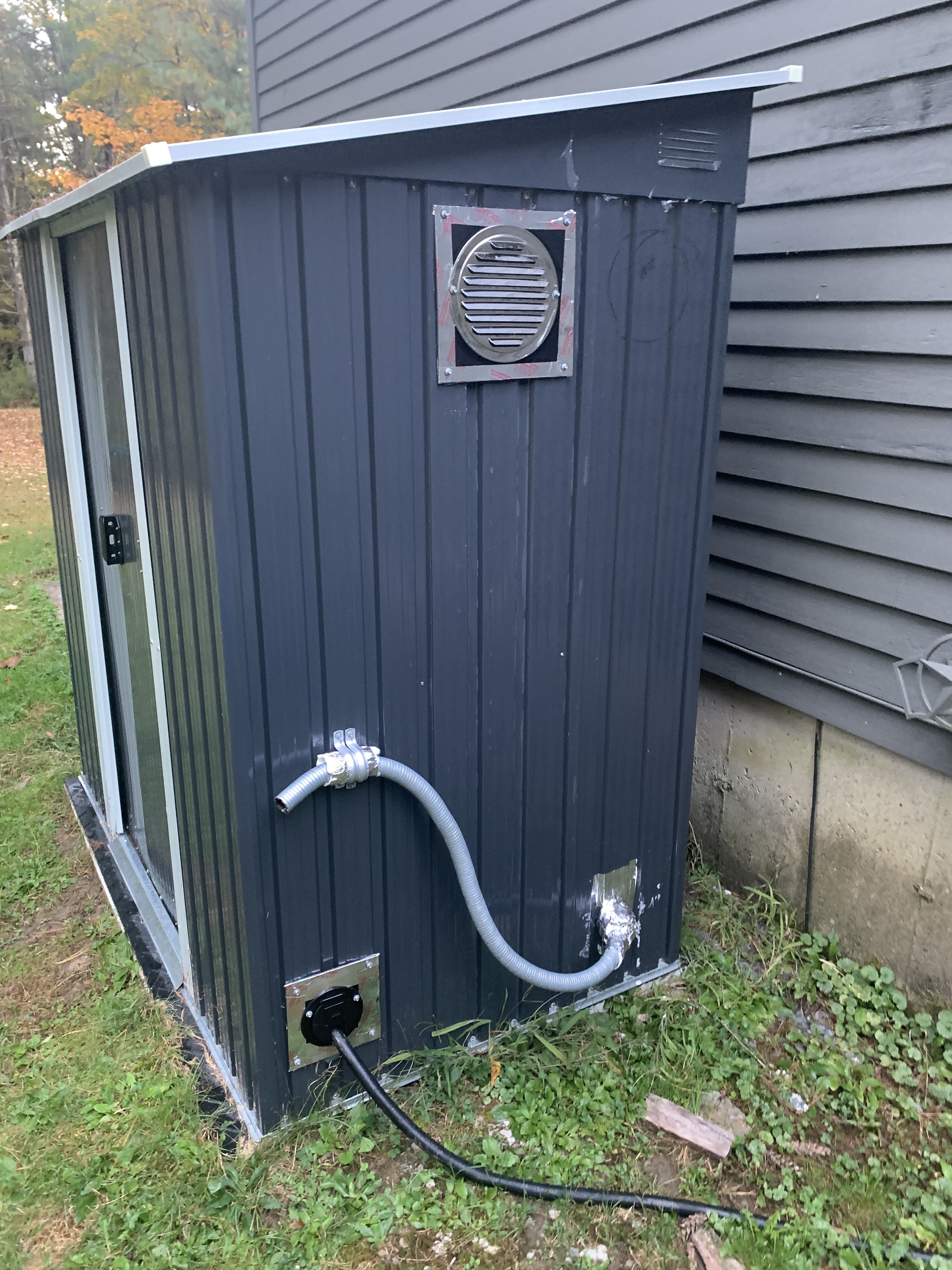

                I built an enclosure for my generator. It was pretty reasonable (the enclosure itself was the price of a nice used Phantom). I didn’t add insulation, but I did add an air intake to the shed as well as a fan/outlet to vent the heat (plug into the generator while it’s running) and a port for the exhaust. - that was another $100/$200 or so.
                I extended the exhaust line about 2 ft, and point it away from the house. When it’s running, i can hear a slight “drone” from inside the house, but the TV or a fan running will drown it out.
                All that said, I don’t live in a neighborhood so there are no houses to echo off and with the few times I need to use it per year. The sound is a small price to pay to be able to have heat and be able to flush my toilets.
                plus my generator has a permanent home, it is completely out of the elements, easy to get to, and I have enough room to keep all my “generator stuff” with it.

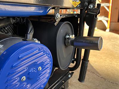

                    Just an update: I added this small muffler extension today. It maybe lowered the sound level 1-2 decibels, but it’s still obnoxiously loud.
                    Might just plan on building a generator enclosure summer 2025.
                    Or maybe I’ll sell it on FB marketplace and pick up a quieter generator.
