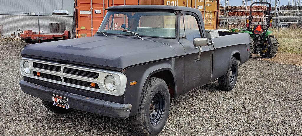

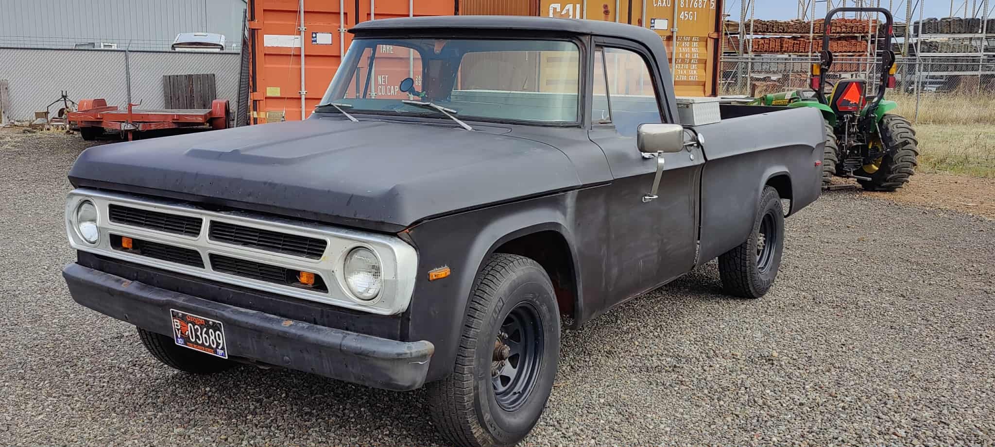

Classic cars/hotrods is my other expensive hobby. I have 3 Dodge trucks, two D100s (1967 & 1968) and one D200 (1970). I also have a 1970 Plymouth Duster. My D200 is my first project
Drove it back from San Fran up to Southern Oregon a year ago. Was going to be a nice driver while I built my D100, but it had a lot of hidden isuess that I didnt see. Has turned into a mild frame off build.
Long and short the 318 had two cyl that wert firing, was the distributor. Engine had been rebuilt, than sat for years and moisture got into it and rusted rockers, timing chain etc. Decided to just buld a stroked 360 (408). Then as I started addressing addressing some issues, I found more (rust), and it snowballed into a frame off build. Which is fine, it will give me good practice on doing body work and metal shaping.

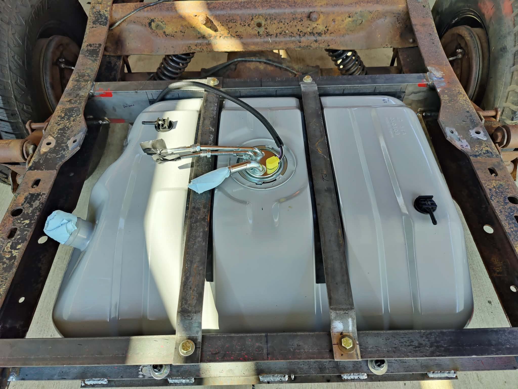

-Gas Tank Relocate under Bed. - DONE

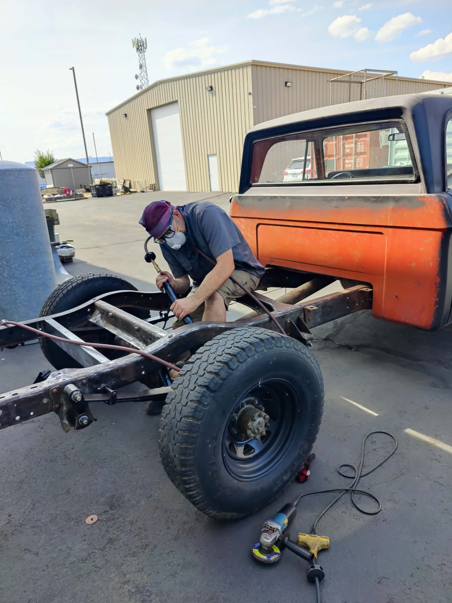

-Remove surface rust from frame and paint it. - Done

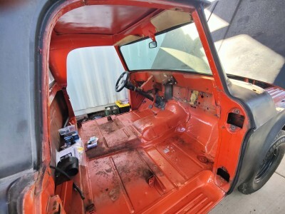

-Patch rust on floor in cab (Driver & Passnenger, and rear cab mounts .

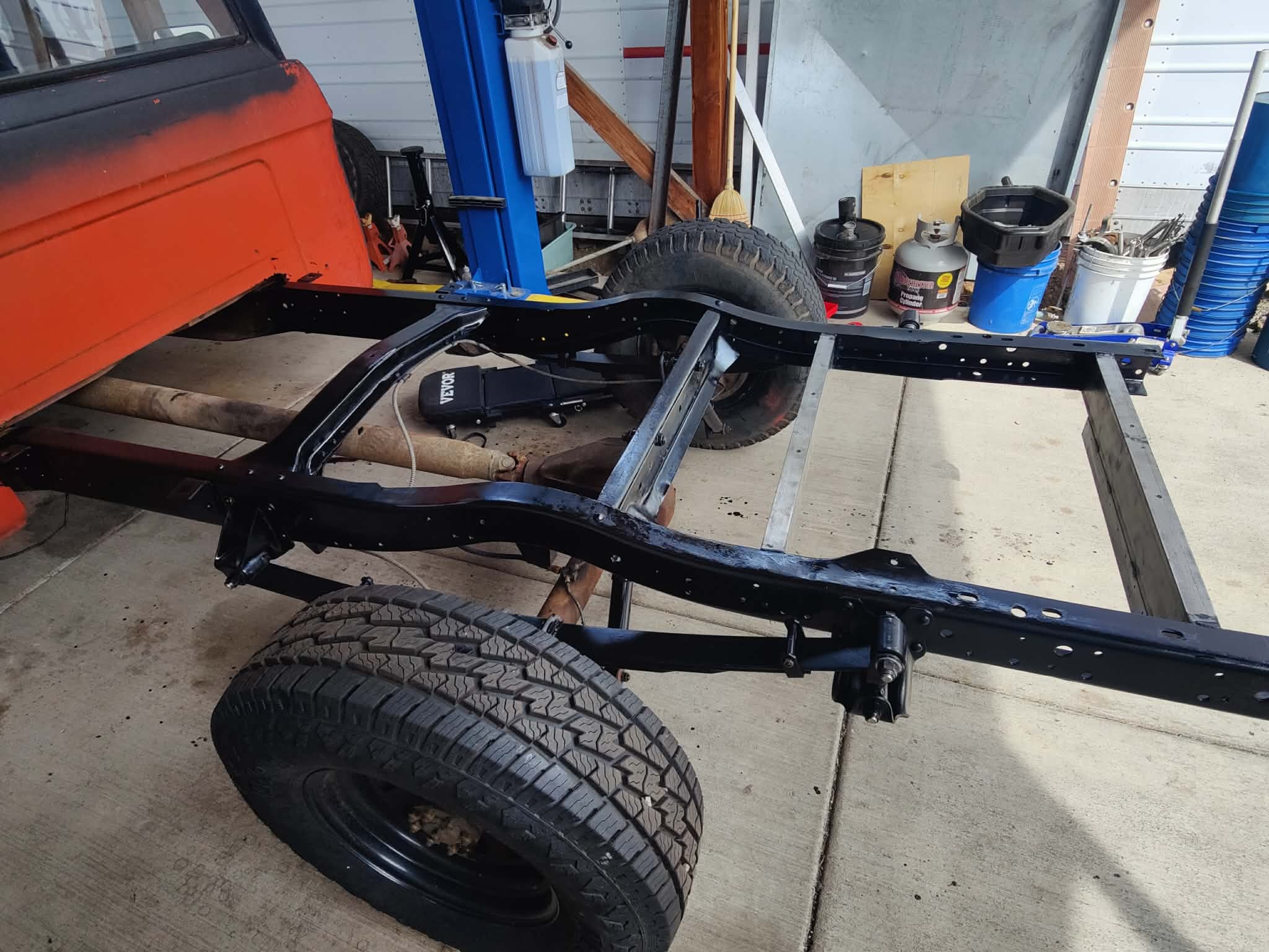

Got rid of the in cab gas tank, and built a mount for a 30gal Tahoe tanks in the back of the frame.

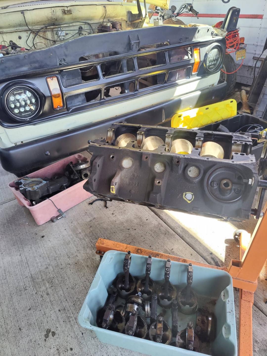

Magnuium 360 from a wrecking yard tore down an off to the machine shop. The 408 will be around 550-600hp

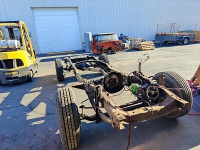

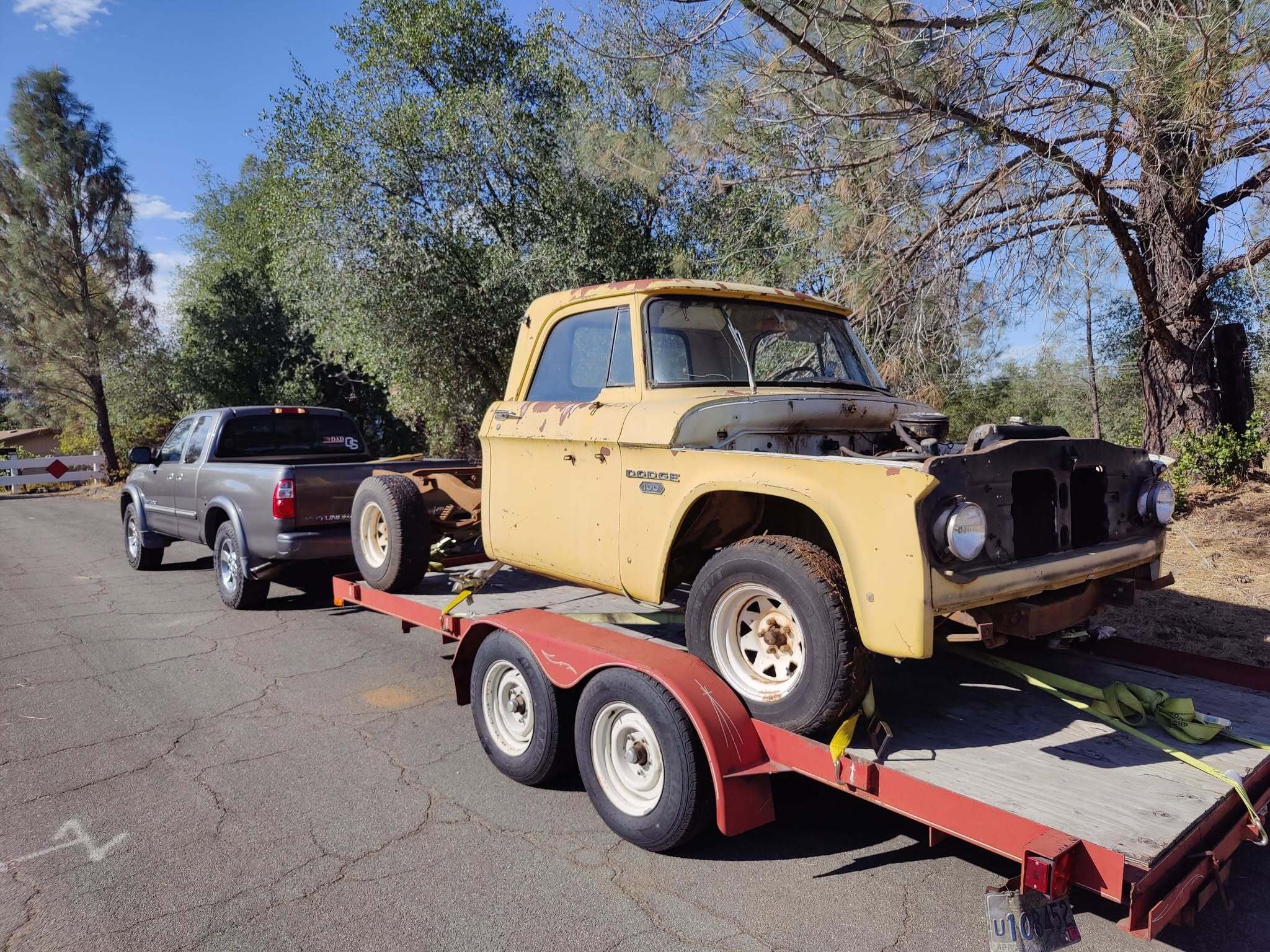

Yanked everything off the frame other than suspension. Have to clean, prep, and paint the front half of the frame. Cab, while it looks good, is a bondo-bucket. Picked up a parts 67 D100 this weekend down in Redding, CA. Going to use it's front axle, cab, fenders, hood, and grill. The 67 front end style is my favorite of all the sweplines.
Thats were i'm at so far. Egine and rotating assembly should be back from machine shop in a month. This is why most my paintball stuff is on hold, utalizing the good, albiet hot weather while it last. Hopefully over the next month I will get th is D100 stripped, my Ford 8.8 rear axle narrowed and rebuilt, front axle out of the D100 rebuilt, and all put under my D200 chassis. Then I can start on the few small rust spots on the D100 cab.
