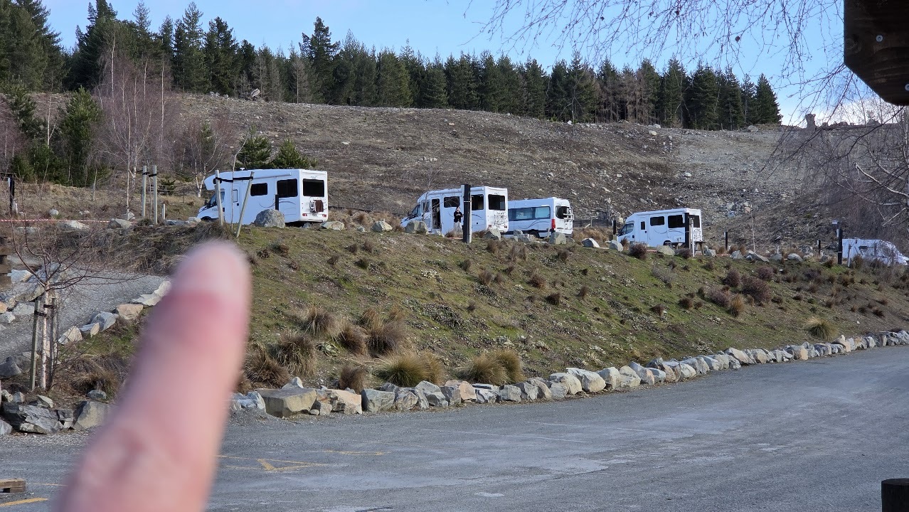

        Just got done taking this 6berth around the South Island here. (Recommended)
        Definitely always required to turn off gas when on the road. Fridge is 12v so can happily run the whole time off a big household battery.
