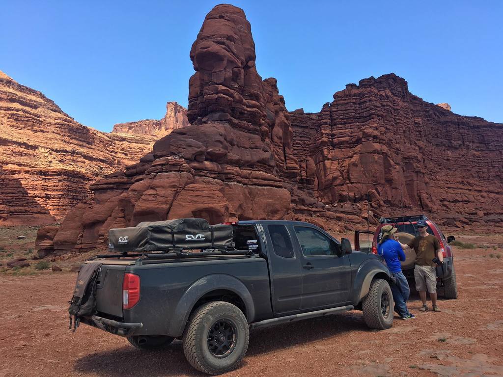

    Most of the non ARB tents are made exactly the same. I had a CVT and loved it, I saw a few Tepui tents and they looked the same, and I have had a look in a Smittybilt one too. Mine was a 2 man. Most tents will get you 8 feet of length ish and the width will vary, mine was 4 feet wide.
    An easy upgrade for your pro4x if you can find them is a second set of skid plates. You can stack the factory ones for some added protection, alone they are pretty flimsy.
    I can’t find a picture with the tent on on my iPad, I’ll look for one for you on the computer.
    Found one! It's on Putco bed side rails (made for something else, cut to fit, and bolted on) spaced up with some 3d printed blocks so my roll up tonneau cover still works, and the tent itself is bolted straight to some Thule cross bars. You can also see my Insain Fabrication front bumper, Calmini rear bumper, and Shrockworks rock sliders. In that picture it's on 33 inch tires with about 3.5-4 inches of lift.

        That's a slick setup. I miss my longbed SV, but I moved from Texas to Colorado, and 4WD is a necessity our here. I reckon I might have to get one of those tall racks that extend over the cab since I got the little shorty bed...

          A buddy had a setup like mine on a 5 foot bed, it’s certainly doable.

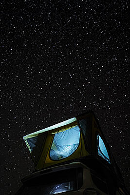

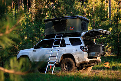

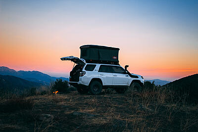

                  The first tent we had was a Tepui Hybox. We picked it up from REI for half off because it was used and the struts and hardware needed some work. The beauty about hardshell tents is they're very fast and easy to set up. When closed, it has a latch in the front and rear and pops straight up with 4 gas struts in all corners. With popping it up, opening the windows and installing the ladder it took about 30 seconds. The shell was made of fibergass resin and some steel or aluminum frame rails. It was super roomy inside for the two of us plus bags of clothes and it was advertised as not just a tent but also a cargo rack if the tent liner was unzipped. We had no problem leaving the mattress, pillows, ladder and about 6 blankets inside when we closed it. With everything inside, the tent shell was about 8" thick. Overall the tent was really fun for us and made camping so much less stressful. Later on we realized that style of tent had a recall because rivets were the only thing keeping the tent shell onto the bottom frame rails so people reported their tent flying off on highways. We've never had a problem even going 100+ in strong winds but we decided to contact Tepui anyway. They offered to send whatever softshell tent they make of our choice to us for free, so our Hybox got picked up and got destroyed.

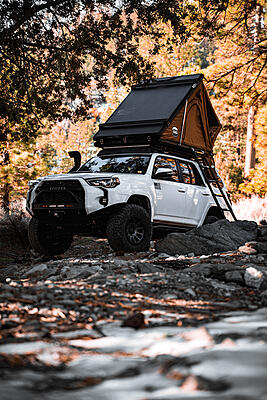

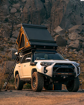

                  We had a brand new softshell tent sitting in the garage but we were already spoiled from benefits of a hardshell so we picked up a CVT Mt Hood. The Mt Hood is considered top of the line in roof tents. It's entirely made of aluminum and its super modular so I can mount a couple of bikes, kayaks, solar or anything else to the roof of the tent and still be able to pop it up for the night. It's a lot slimmer than the Hybox so the low profile is nice but we can't leave anything inside besides the mattress when it's time to close it. Because it's a clamshell tent, it pivots off the 2 front hinges and it literally pops up in 2 seconds with the help of the 2 exterior gas struts. Keep the roof towards oncoming wind and you have comfortable quiet sleep. With the tent being so modular, I can mount an awning, lights, shower, and pretty much anything else directly to the sides, back or under the tent making the truck on my rack useless. I'll be fabbing up some low pro roof mounts so the tent can sit real low. Also, with a ladder on my rear hatch or a tire carrier we'd be able to climb in the tent from the back so we can leave our tent ladder at home.
