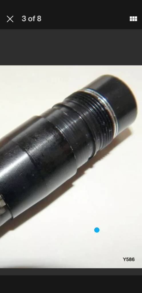

    Took a shot and bought a barrel. Hope it's icd threads. Haven't received it yet but could someone. Maybe confirm or deny what I will be receiving. Please
    Sent from my Pixel 3a using Tapatalk
    • 4288
    Looks like ICD threads to me. You're good to go.
    • What happened
      • 34
      Good. I was pretty sure but after purchasing started to doubt myself

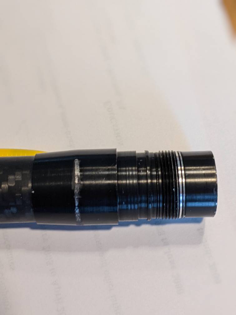

        Definitely not icd, but what do I have? didn't fit ion, autococker, phantom, A5, thundercat, trracer, spyder, or freak back. There is a rub mark that goes 1/3 way around like it might have been on a pump at some point.

        • Fubarius
          • 507
          • New Richmond, WI
          From that angle it sure looks like a freak front to me. And those threads can be surprisingly weird. I've had fronts that threaded in fine on one back, but had to be forced on to another.
          • DocsMachine
            • 2823
            That looks a LOT like a Freak tip to me, except the bore should have a shallow 'step' just inside the breech, and it doesn't look like that's got one.
            It not wanting to thread into a Freak may be because the first two threads are damaged, and won't let it screw in.
            Did anyone make a solid (no inserts) back that took Freak tips?
            Doc.
            Paintball in the Movies!
              • 4456
              Doc.
              Yeah... Smart parts all american barrels
                I. Am. Canadian. 🇨🇦
                • 3518
                True, but those barrel backs have a ledge inside them that enters the barrel front.
                  MCB member
                  • 3511
                  • Montreal, Qc, Canada
                  Can you measure OD and thread dimension with a caliper?
                  • Raleighpaintball.com
                    • 35
                    • Raleigh NC
                    I just taking a wild guess....but sort of reminds me of the original Trracer pump or tagmaster barrel threads from circa '94.....I am drink number 3, so dont blame me for being stupid
                    • Chaos
                      I'm Comin' To Getcha
                      • 878
                      I'd say Trracer
                      Sent from my VS501 using Tapatalk
                      • What happened
                        • 34
                        I tried it on my tracer and tagmaster. I'm sure the damage to the first two threads could be causing a problem but there is a good opening at the first thread that is good. I have a All American back I could try. And I do not have a caliper, I should get one I've been meaning to for a long time. The All American back I have I don't even know what marker it belongs to, also does not fit anything I have.
                        • What happened
                          • 34
                          Everything is identical to empire freak tip except the empire freak has finer threads.
                          • What happened
                            • 34
                            Found my AA back, no fit
                            • capitalpaintball
                              • 314
                              • Coventry, Rhode Island
                              Is it the for Phantom without the cci thread adapter. Im not home now but when i am l'll take a pic. Its a 2 piece system.
