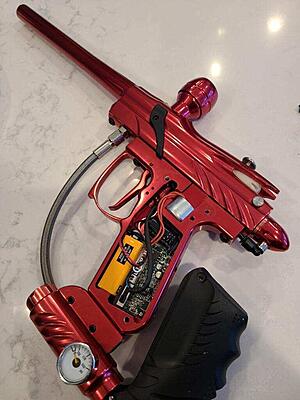

    What is this marker?
    Any idea what this is?

    Odyssey RPM.
    • kevin qmto
      King of Low End
      • 245
      Odyssey RPM (old style). You can tell the "old" from the "new" (all relative terms considering the guns are now like 15 years old lol) from the white delrin bolt and little curve on the trigger, and the feednecks are different. Besides that the guns are identical.
      Just a budget version of the Diablo Wrath, without an LPR. Still can be fiery little shooters. I recommend running one ball detent nubbin instead of 2. Had less barrel breaks that way, they were always a little stiff.

        Any idea what it is worth in the condition?
      • kevin qmto
        kevin qmto commented
        In good working order they usually bring in the 50-70 range these days. Usually a little less than the Wrath.

      If you didn't know, that bottomline is a reg, but the way it adjusts pressure is by using very fine incremental adjustments to the tanks pin to allow only a certain amount of psi through. Don't just crank it down and expect goo results lol. back the screw out each time you put a new tank on and gradually screw it down until you reach around 200psi.
      https://www.paint-supply.net/wp-cont...dyssey-RPM.pdf
      this is a great info source.

        I had read about the reg and how you were not supposed to used a remote with it due to something with the pin but that was not clear. I don't own this marker, just saw it for sale and thought the the combination of a solenoid, air ram, bottomline reg, etc., was too interesting to not investigate.

      So it actually uses the tanks pin valve to adjust output pressure? Pretty novel.

        Novel, but I'd classify it as a bad idea. You better not have a slow leak on the tank pin valve or you'll have really bad pressure creep.
        That reg (if you can even call it that, it's more like half a reg) would be dumped into the spare parts box immediately if I was setting up that gun to actually use. Replaced with a bottom line stabilizer or I'd thread a spyder vertical adapter where that hose is.
