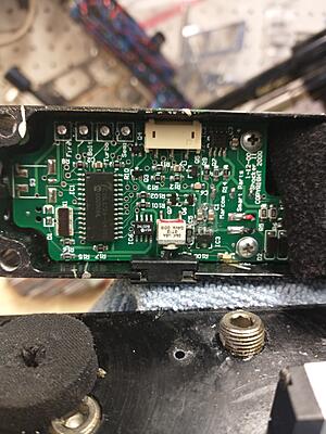

    Also, this board. Im used to seeing the dip-switches Whelp. this one appears to be a turbo , however doesn't seem to be ramping up. any thoughts crew?
    note. the board has to have been replaced. Front two holes for the original on/off are taped up.

      That's an LS Turbo board. Try turning the potentiometer next to the 'Turbo' label and see if that gets it going. The trigger needs to be moving at 5 bps before Turbo kicks in, so make sure the trigger is not being hindered.
      Most splash ano Shockers would have had a DS (dipswitch) board, so that is likely a replacement (not at all a bad thing).
