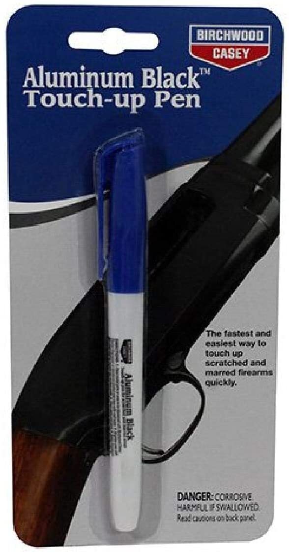

                I have not tried yet but just order some off of amazon for 8.00
                Birchwood Casey Aluminum Touch-Up Pen
                Click image for larger version  Name:	61zrPKWZ2nL._AC_SL1200_.jpg Views:	0 Size:	78.7 KB ID:	111374
                • WORR13
                  • 374
                  ^ works really well actually. ive been touching up ano with that for a while. it comes in flat black and a gloss or semi gloss. i have the "super black" version- its like a paint pen, metal tube.
