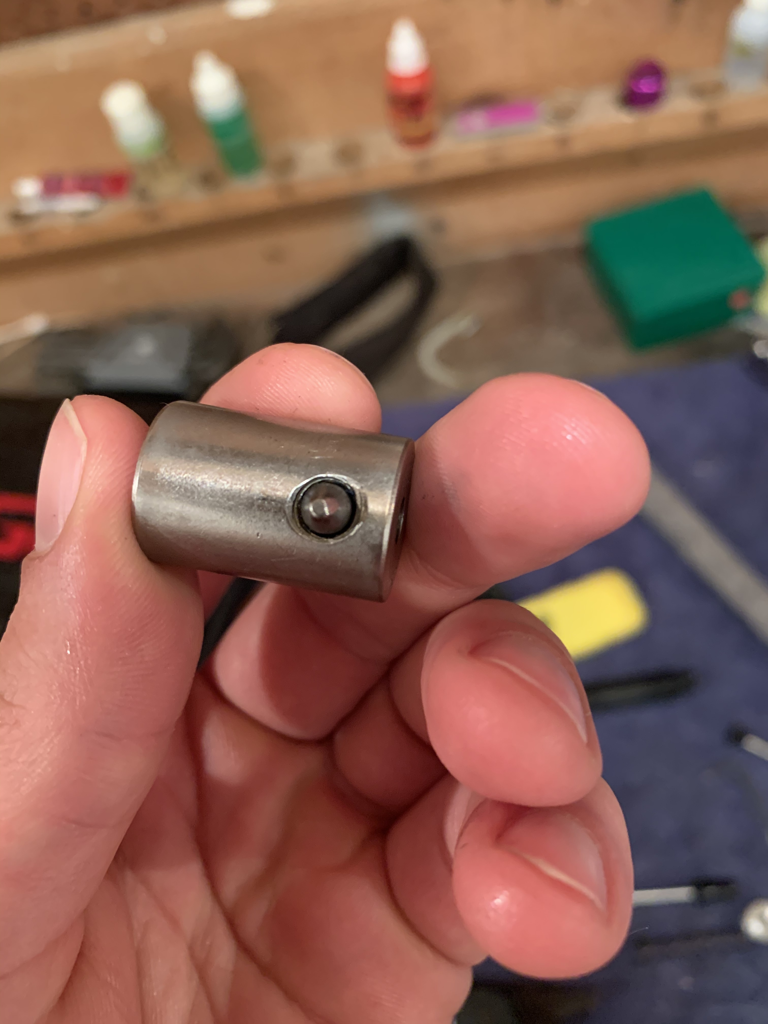

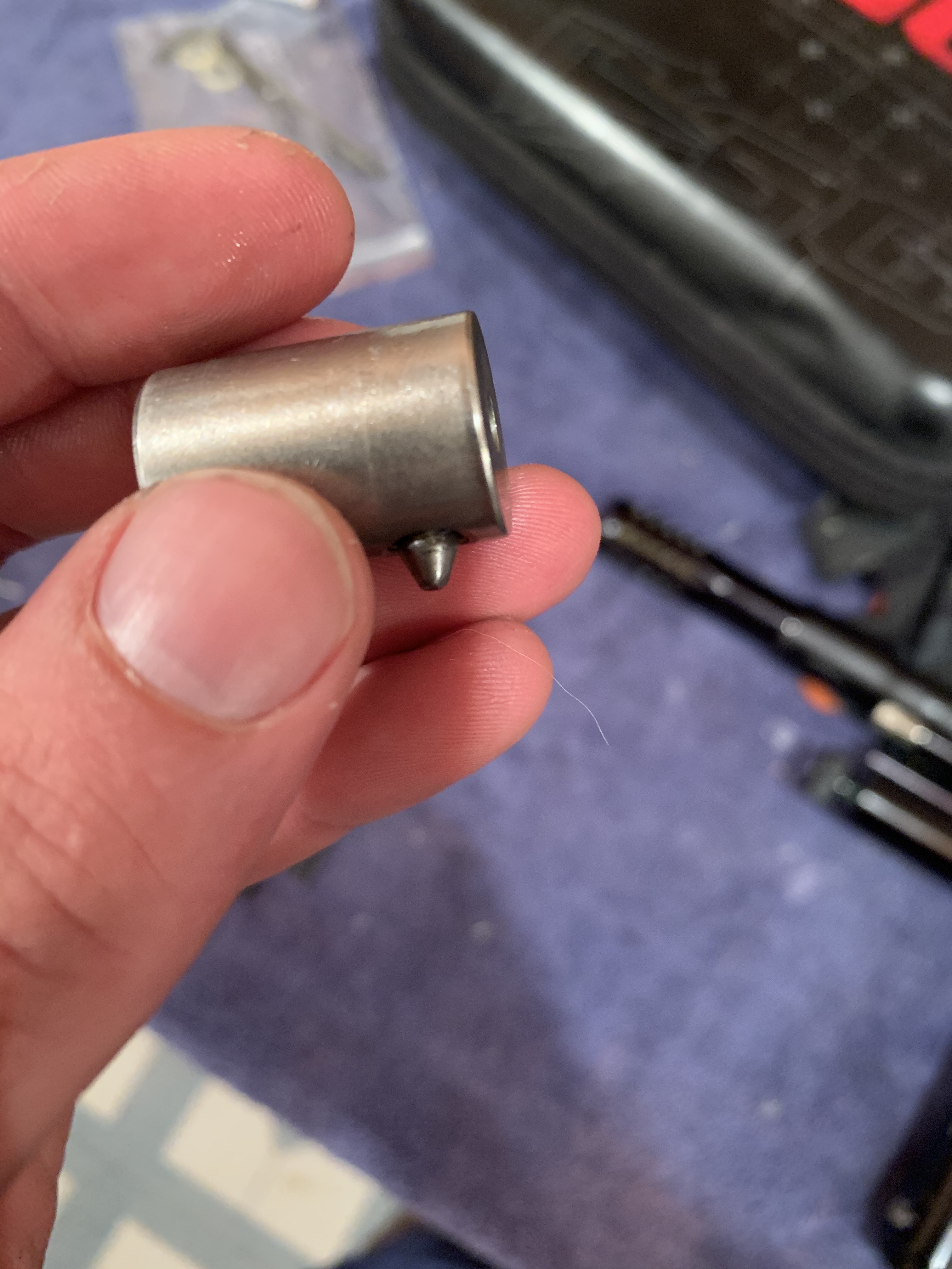

    Well, I thought I’d seen about everything, but I was having what seemed like sear slippage and pulled out the hammer to find this dagger.
    B5582558-902A-470C-A3F8-7C7F064FE3E5.jpeg B2398AFF-ACEE-4D04-B621-88E5A7D749B3.jpeg
    it looks like it’s that way on purpose, have you guys seen a lug like this? I haven’t checked out my sear yet, but with the cone shape and some significant wear on that cone I’m confident I found the culprit.
    Feedback!
  • WORR13
    • 374
    yeah those are a thing, seen em and tried em. the sear trips lighter but tends to slip when resetting.

      Looks like a shocktech, they did/do put out lugs with different profiles like that.
      www.armorypaintball.com
      • Hellion360
        Power Lurker
        • 2519
        Yup, just a cone shaped lug. Round and cone lugs are available regularly from Shocktech. (Not that this is necessarily a ST lug, other companies have made them too)
        Cone lugs are recommended with their Gunfighter frames and I actually like them with some hinge frames.

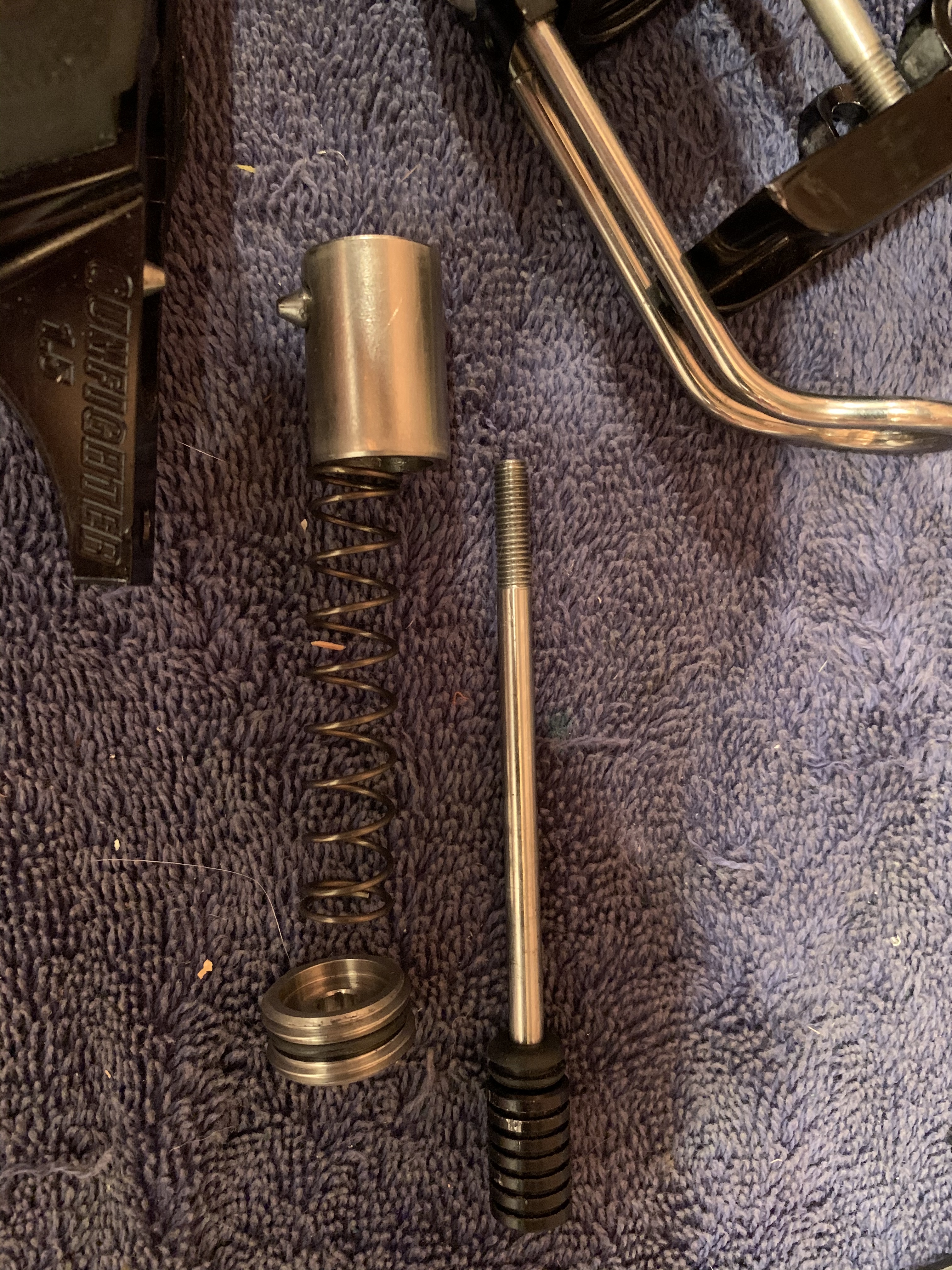

            Might be that you had turned the velocity up via the IVG and are now overpowering the sear spring.
            The lug looks a little dirty in your picture. I would clean everything thoroughly and then reassemble. You could add a stronger sear spring if needed. (unless you have a gunfighter frame?)
            Might be useful to see the whole setup.

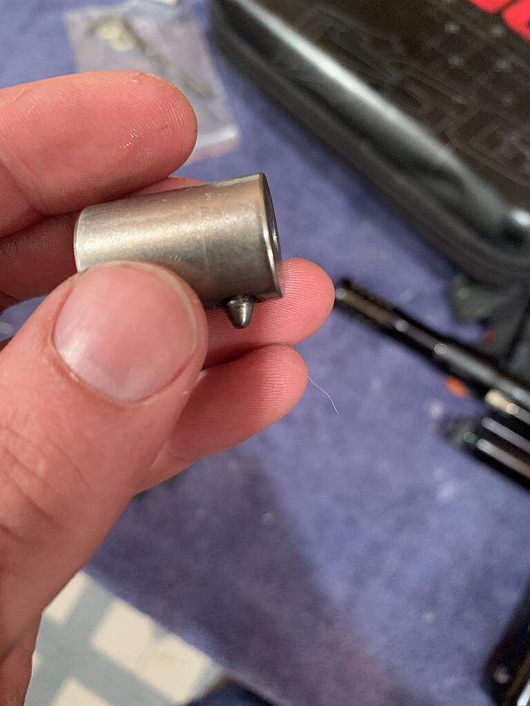

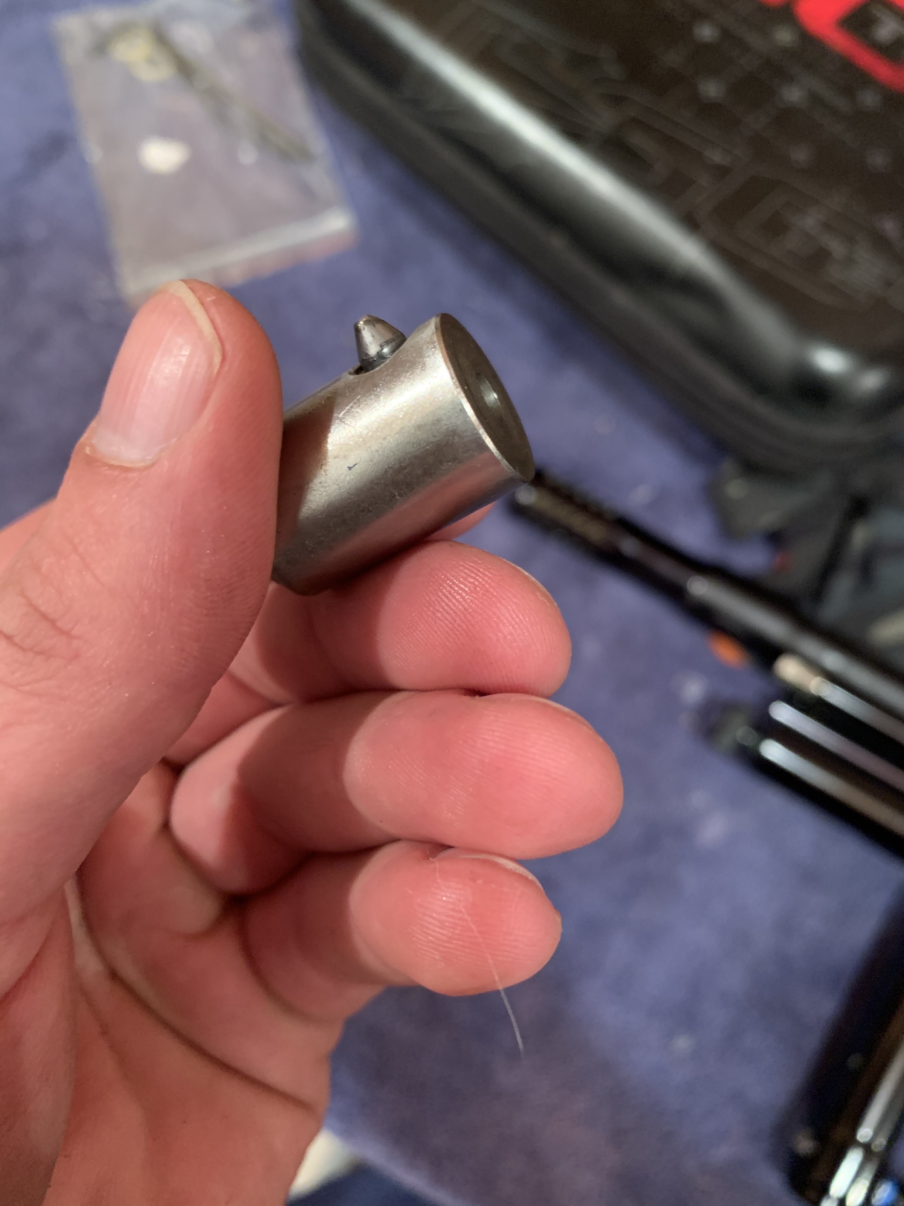

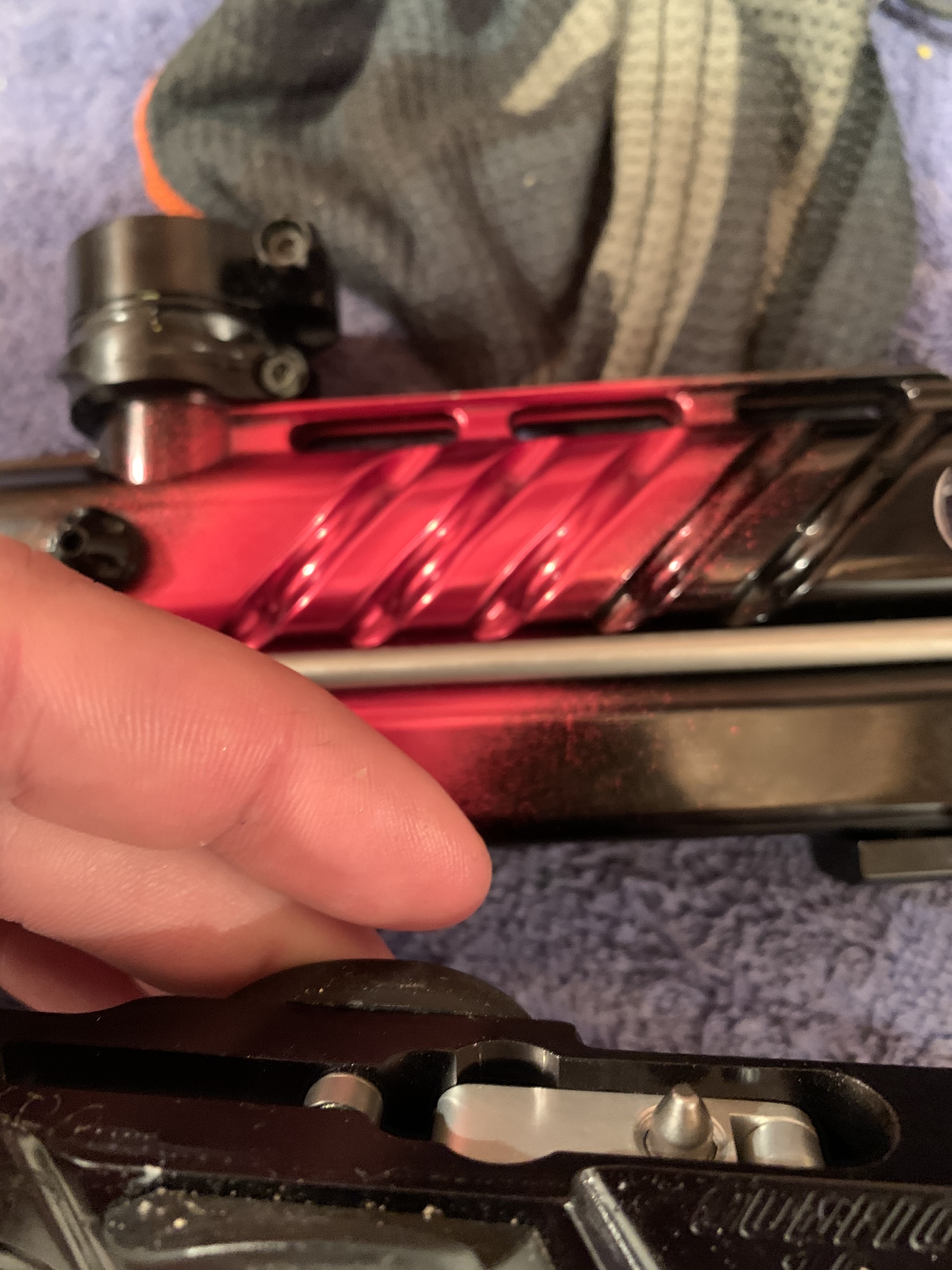

                It looks like it might be a combination of things.
                Hellion360
                I actually was trying to squeeze an extra 10 FPS out of it when I first noticed the problem, but it was intermittent.
                Looking at these pics it’s kind of tough to see, but there is a flat spot on both the sear and the hammer that looks polished up and I’m pretty sure is wear, and likely the cause of the slippage. I’m going to rotate the sear and see if it goes away after work.

                  Yep, it’s crazy what changes were made for the sake of small improvement on these high end parts, but it all makes sense how it should work. In your experience is there a flat spot on the sear (as in the second picture) or is that more likely to be wear?
              • Hellion360
                Power Lurker
                • 2519
                That looks like wear to me.

                Going to send this to the top again so that if anyone runs into it in the future, they can know that the sear was worn out and rotating it resolved the issue.
                with some more investigation I decided to stick with the spring, as it didn’t feel excessively strong. I’ll put a couple cases through it and recheck the sear for signs of wear. If it is, I’m gonna say the springs are too strong.
