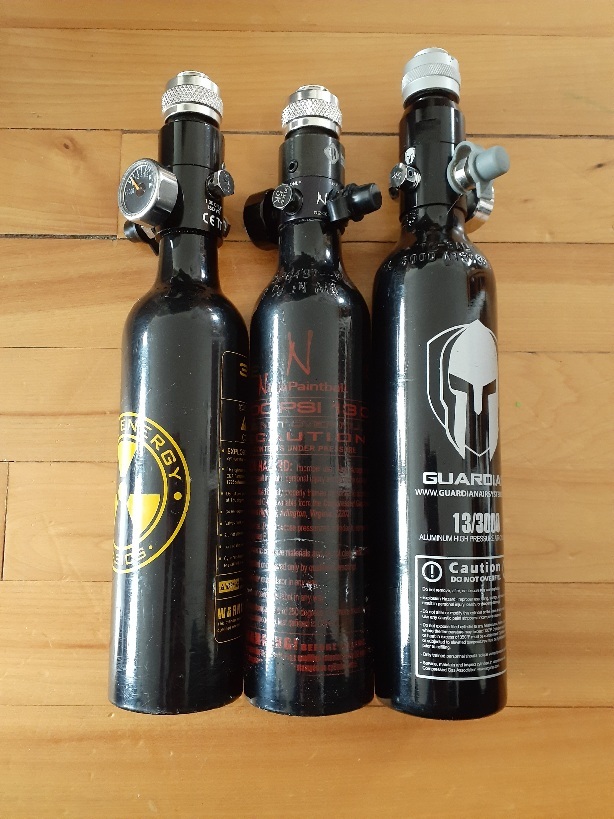

      Click image for larger version  Name:	20210427_110251.jpg Views:	0 Size:	171.4 KB ID:	121494
      here are some measurement using a Mitutoyo caliper at the base of the tank
      measured at 68F
      Pure energy : min 2.009" max 2.013"
      Ninja : min 1.963" max 1.966"
      Guardian : 1.980"
      Last digit is not that acurate but that give you an idea
          measured at 68F
          Guardian : 1.980"
          Alex!!
          This is perfect, good sir! Thanks a TON!

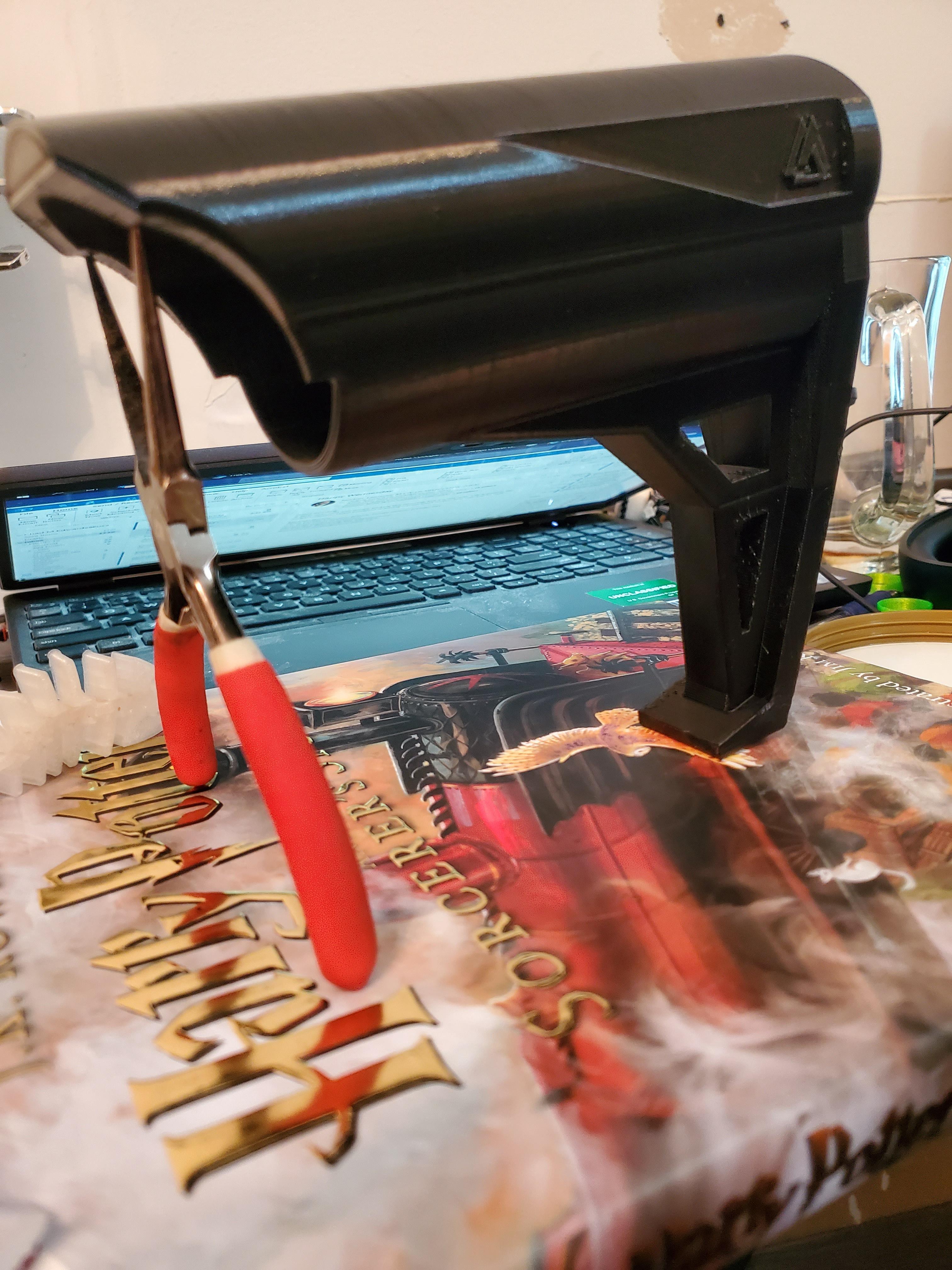

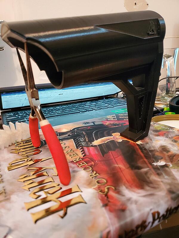

          Here it is. Not my design, but it came out pretty good.
            Alexndl commented
            Nice!
            PETG?
          • Rainmaker
            Rainmaker commented
            Yeah, PETG
            I was worried about stringing, but it turned out ok. Just a little inside the tank hole, easily cleaned up with a file
