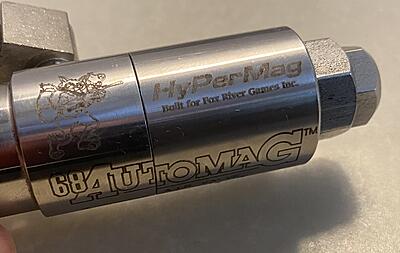

    Looking to part ways with a hyper valve and wasn’t sure on the value. I know I won’t be using it so let me know what you guys think, thanks !
    I can provide more/better photos, and even rebuild it if it leaks, just looking for a ballpark amount

        I don’t know much about mags, but didn’t Centerflag make a hyper frame for them? Maybe it came with custom mags??

        I want it to be from a centerflag hyperframe equipped automag but the hyper lettering makes me think not.

          These things had a smaller dump chamber and operated at a higher pressure. This increased air efficiency. Otherwise, they're standard classic valves with an 8 hole mod.

            I think Oh Pawlack promoted these for a while.

              so this would have a stiffer trigger pull and be worse for a hyperframe due to the higher pressure on the on/off valve?

                I'm pretty sure the magic number on these were 20%. So yes, 20% lower volume, 20% higher pressure, 20% more efficiency, 20% heavier trigger pull.
              Technically... Yes

                  Necros be damned, didn't hyper frames have their own on/off that lightened the pull?

                    Yes they did..the electro frames didn't work with the stock on/offs
                    They will work with rt or ult on/offs

                  Maybe I missed it the first time but didn’t the rental valves have lower volume as well or did they have a lower pressure blow off in the reg?

                    Restricted power tubes, from what I remember. I think they need to be drilled out to use a lvl 10 kit.
