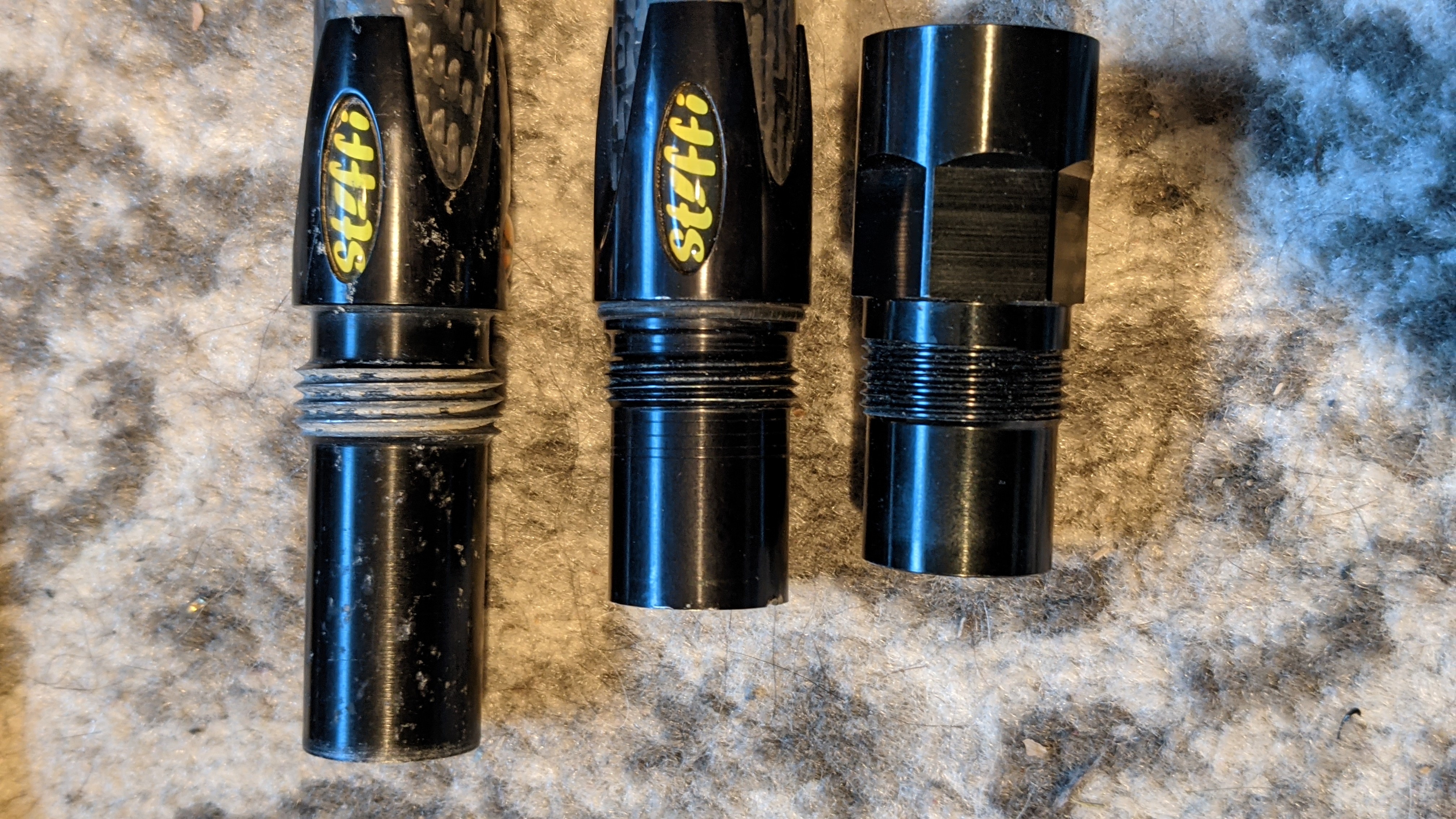

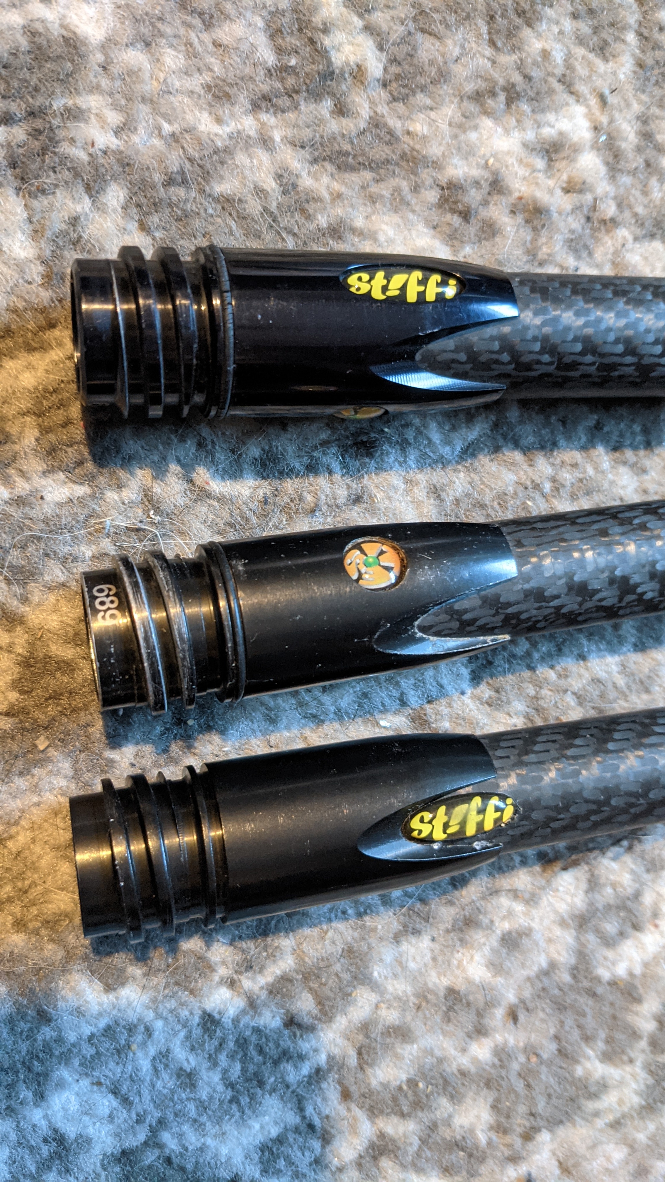

    Doing some cleaning I found my stash of spare barrels ... And one of them has a thread I don't recognize, so I'm hoping someone can help ID it ...
    Here it is, next to some references:
    Left: angel
    Center: unknown
    ​​​​​Right: A5
    And here it is by itself:
    Thanks for the help,

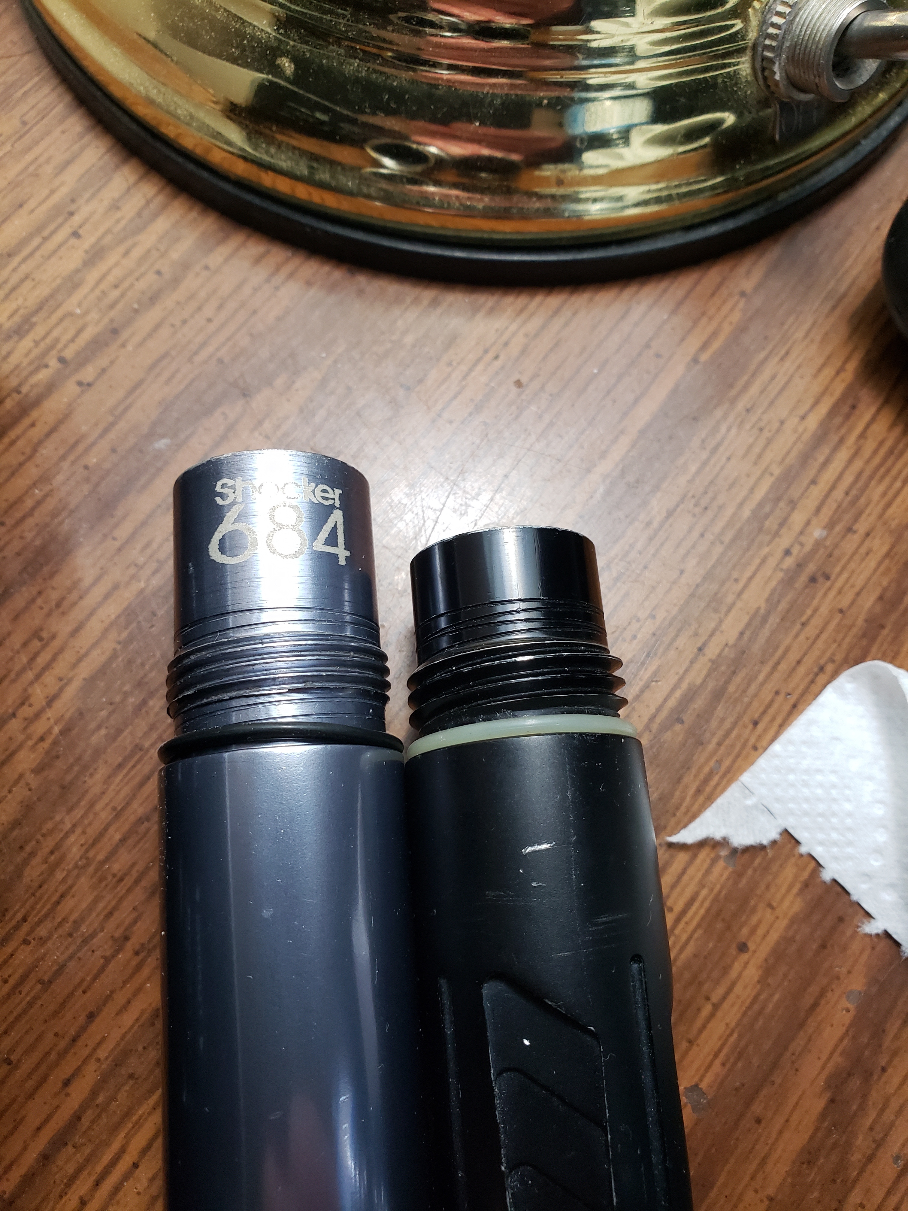

                        Shocker Sport/SFT are not the same thread as Impulse/Ion/Shocker NXT. An Ion thread barrel will not thread into a Shocker Sport.
                        Left is Shocker Sport, right is Ion.
