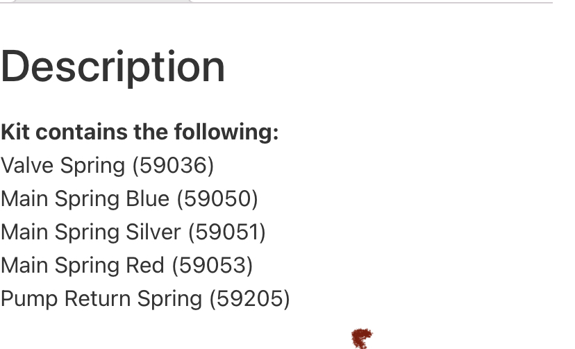

    • 6378
    (I did find this I wonder if those numbers are part numbers. I’m going to dig tonight)
    I would love to find a place I could order the exact springs CCI uses for there kits. (Particularly the Silver ones)
    I would buy a bag of them in bulk they weeken over time and there is nothing like fresh springs to keep them performing perfectly. I only got a few kits left and I have used most of my Silver sets fixing and tuning Phantoms.
    I just don’t know how to even go about finding the right ones. Is there a standard way of Measuring them? Like a tool or something? Count the coils, measure the length, width and gage of material used? How do you even find them it can’t be expensive to buy in bulk. But I only use two springs out of the kit for everything. I would love to find the exact ones. Like I did for the under cocking kit bolt and washer that often gets striped out from people over tightening and not using a dab of locktight.
    Its definitely an off the shelf item just got to figure out what shelf it’s on…lol

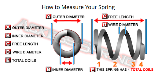

        Actually... there is a standard way of measuring springs. All you need is some calipers and some time.
        I figure most of our springs are stainless or mine would have rusted by now.
        You can also use Spring Rate to narrow the search. This is the lbs of force required to compress the spring "X" inches (I used 0.375" of compression)
        Rate = LBS÷X
        You also need to know what kind of ends the springs have - I think we use "Closed and Square" or "Closed and Ground" mostly.

          I just pulled my spring and measured it. Closed and ground. 1.840" in length, .048 in wire diameter and .463 in OD. Looking at Lee Springs nothing really falls exactly like it but I'll check the force soon and see where that falls as well.
          Rate: My measurement shows a rate of 9.8 lbs / inch
          If you were really interested in getting them duplicated you could send a new spring to a manufacturer to duplicate. There would likely be an NRE charge but it probably wouldn't be too crazy cost wise.
