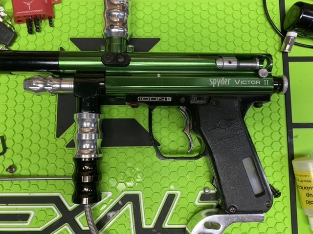

    I’m working on fixing a Spyder Victor 2 with an Icon E frame. Did a total disassembly, everything looks good, but when aired up the sear doesn’t always release. To the solenoid clicks but the bolt doesn’t cycle. It will shoot the odd time, or is fine if so shoot slowly but and remotely rapid fire results in a click but no shot.
    Any ideas? My air tank is at 2k, is a standard 3000psi tank.
    • 4472
    Solenoid looked to have had a piece of tape on it at one time. It looks like it connected the two pieces. Maybe a sort of cheap way to prevent over travel?
