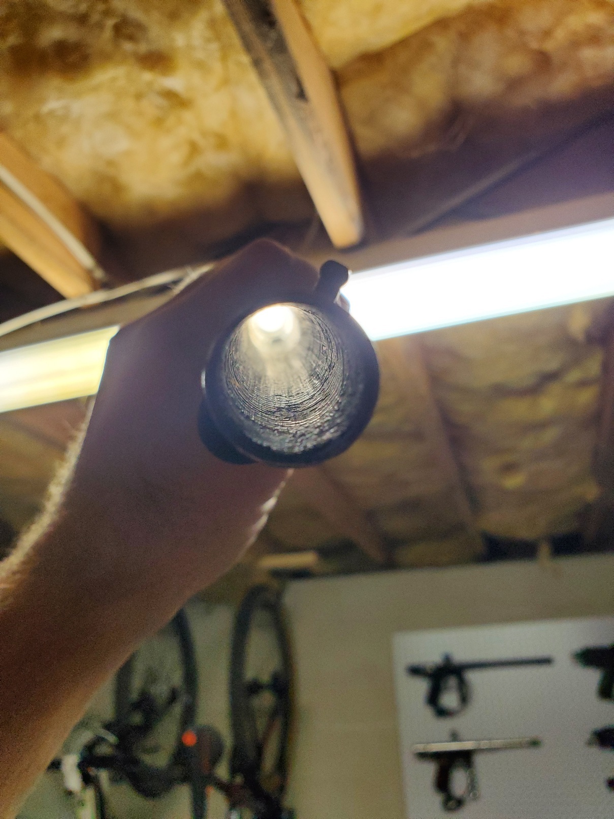

            I will try to get some pics. It is possible they broke a bunch of paint in it 25 years ago and let it turn to stone, or it could be some sort of corrosion from something. I used quite a bit of warm water then alcohol and any other cleaner I could fine with squeegees and barrel swabs assuming it was just old paint but it didn't cut it at all. That is why I am assuming something abrasive is in order.
            Whatever is in there is definitely a positive growth rather than a removal of material like like deep scratches.

              This should give a pretty good idea of what I am dealing with

                Wowwww. That's crazy looking. I've picked up some ugly brass but that's a new one to me. Almost looks like it's delaminating... which doesn't even make sense. I can't think of a corrosion mode that would make brass look like that, it almost has to be gunk of some sort. Dezincifying normally looks a bit different. Was it green before you cleaned it up? Black? Pink?
                I'd try something like acetone (if you haven't yet) before going at it with abrasives either way. Soak it good. If that doesn't get rid of the crud then maybe a scotch-brite scrub and the alumina hone? Don't use any cleaner that has ammonia in it though. That's bad juju for brass.
                Maybe we can get one of the old-hand brass wizards to chime in here with a positive ID...

                  Yeah, I have done my share of clean ups, but this one is special. It has always been pretty black. I haven't done the acetone yet, but will give it a shot

                    wow pretty nasty. looks like gunk to me. prolly old paint grease oil dust etc. give it a good soak in soapy hot water and nylon brush scrubbing, hot water and dawn works best. heat deff. helps alot with brass

                      That scaling inside the barrel looks like someone tried to coat the inside of the barrel with something like shellac or some other viscus coating that hardened. I've never seen brass have scale of its own like that and I've seen and cleaned tons of brass in my life time (ex-Navy enlisted ) There was some talk on the old forum about some players trying to add different things to the inside of brass barrels to build up a layer to close the bore. Ty and I both tried to use brass shim stock but both of us were unsuccessful fully. It being that bad I try a brass shotgun brush (16 gauge) with a drill motor to knock some of that down if I could not loosen up with a solvent like acetone or MEK.
                      • Knuckle Dragger
                        Necropost enthusiast
                        • 567
                        If it’s some coating, have you tried a propane torch? Maybe get that stuff to coke up and fall off. Not sure if the front sight bead is soldered on though.
