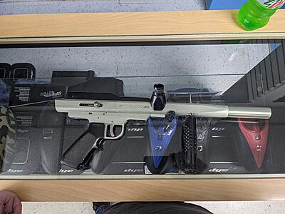

    Anyone have any information on this? Quick Google search found nothing.

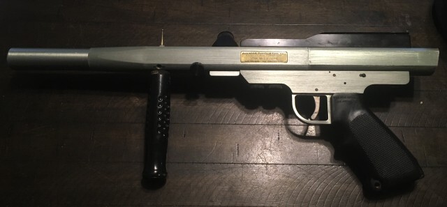

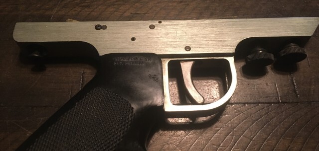

            I didn't think much about it. "Just another clone". But it actually had a few neat features.
            The grip, for example, all the screws are CAPTIVE. Maybe I have watched too many episodes of "forgotten weapons", but it was such a cool thing o see. I'm not sure I've seen another paintgun where nearly all the screws are captive. (meaning, they do not fall out when unscrewed). The sear is removable and fixed with a setscrew on both sides. The trigger is wider then the montneel version.

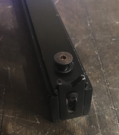

            The receiver is mostly Montneel style, but it has 2 hardened steel pins for extra stability. All the screw holes have STEEL INSERTS. Such a good idea.

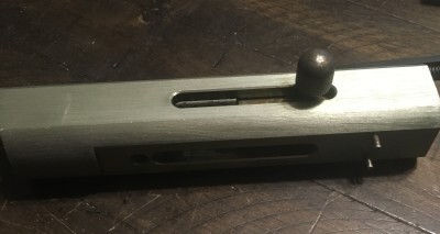

            Adjustable iron sites. hilarious. I've never seen this either. Pointless, for sure. Just weird and cool.

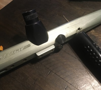

            The forward receiver is also pretty neat. All the screw holes also have steel inserts. It has a double thumb-screw for the barrel, and a 3-way foregrip (foregrps briefly popular in the early 90s). Knurled feed block. Lastly, the body not annodized, but a brushed nickel. Brushed nickel... so weird.
