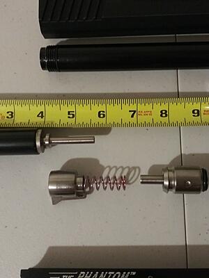

    I am relatively new to phantoms. I bought one last year and finally got around to using it.
    It pumps fine without air, slide just fine without air. However when aired up it pumps back fine, but the pull forward is much harder.
    I took it apart tonight and it looks like the issue is when the bolt attaches to the hammer pull each other crooked on the power tube and don't slide easy.
    I looked at the phantom manual and I don't see anything I am missing or looking out of the ordinary,.
    Can you let me know if there is something I am missing or should do to fix this issue?

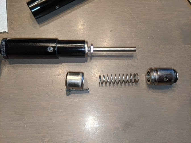

    Those definitely look like older internals(might even be Nelspot guts.. 🤔) Upgraded internals: Bolt, hammer and new valve stem should fix you right up. You also could try loosening the grip frame screws, just slightly. Then giving the pump rod/pump just a little bit of a shimmy/shake/wiggle/pump back and forth.. a bit and then tighten it all back down. That may fix your issues.. But, it's probably the older internals binding on you. 😉
    Here's a picture of my valve stem/hammer/bolt...

      Your bolt and Hammer are early first gen non anti+kink type.... Basically you have to replace the bolt the hammer and the valve stem if you want to get rid of the drag. Otherwise it is what it is. Nelson's are a fun bit of design.
