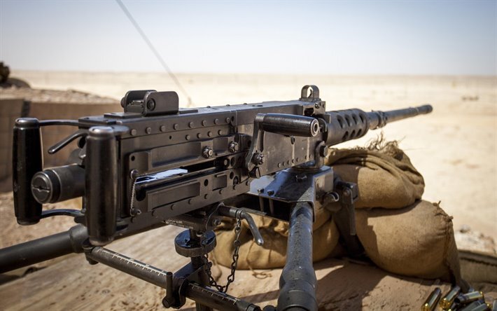

          How do real steel open blowback machine guns slow their bolts down? Like the WWII grease gun.......?
          • DocsMachine
            • 2820
            Big heavy bolts. The big .50 Cal M2 Browning machine gun is blowback- bolt weighs something like 15 pounds.
            Doc.
            Paintball in the Movies!
