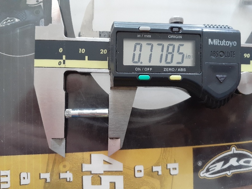

    Bough a NOS in box Dye single finger spyder frame

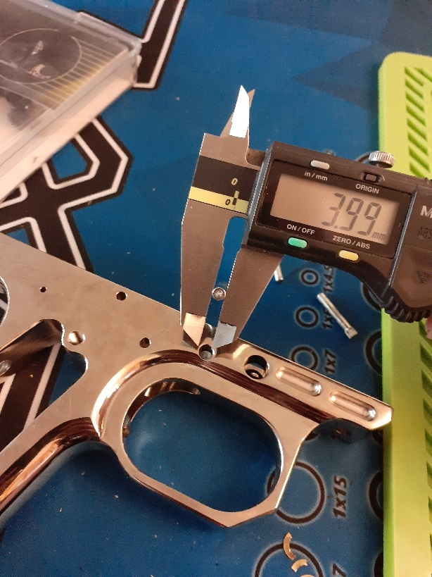

    Remove the sear, trigger and springs from another spyder frame and I realise the trigger pin is smaller than the hole on the frame...
    checked 2 spyder trigger pin and they measure similar
    trigger pin is 4mm (.1575") and frame hole is 4.5mm (.177")
    the other pins seem better but somewhat a tiny bit looser than the original spyder frame
    anyone using DYE single finger spyder frame?
    wondering if I got a deffective one with tolerance issue
    Picture show OEM spyder pin measurement, you can clearly see the pin is smaller than the hole next to the opening
    Safety hole is also bigger but less critical

      They are sized for very early frames...... It's annoying. Generally no just make a new pin

      I'll need to grab my calipers from work, but I might be able to find something for you, if you haven't found one yet. You want a roll pin? Or a dowel? What's the minimum length you need?
        Alexndl commented
        I have a preference for dowel pin but could use roll pin too.
        Min length is .778"

      I don’t remember for certain but the last one I had I think I used a spring pin
        Alexndl commented
        Good idea, will look at those if I cant find a standard pin

      That one, which I have on a build, has some janky o-ring retained pin thingy. I will eventually just go find brass rod stock of the appropriate diameter, and drill the hole in the double trigger a touch larger to make things better.

        I dont mind drilling the trigger but want to find a pin with the appropriate size not to drill the chrome frame (its the only non flaked one I have)
