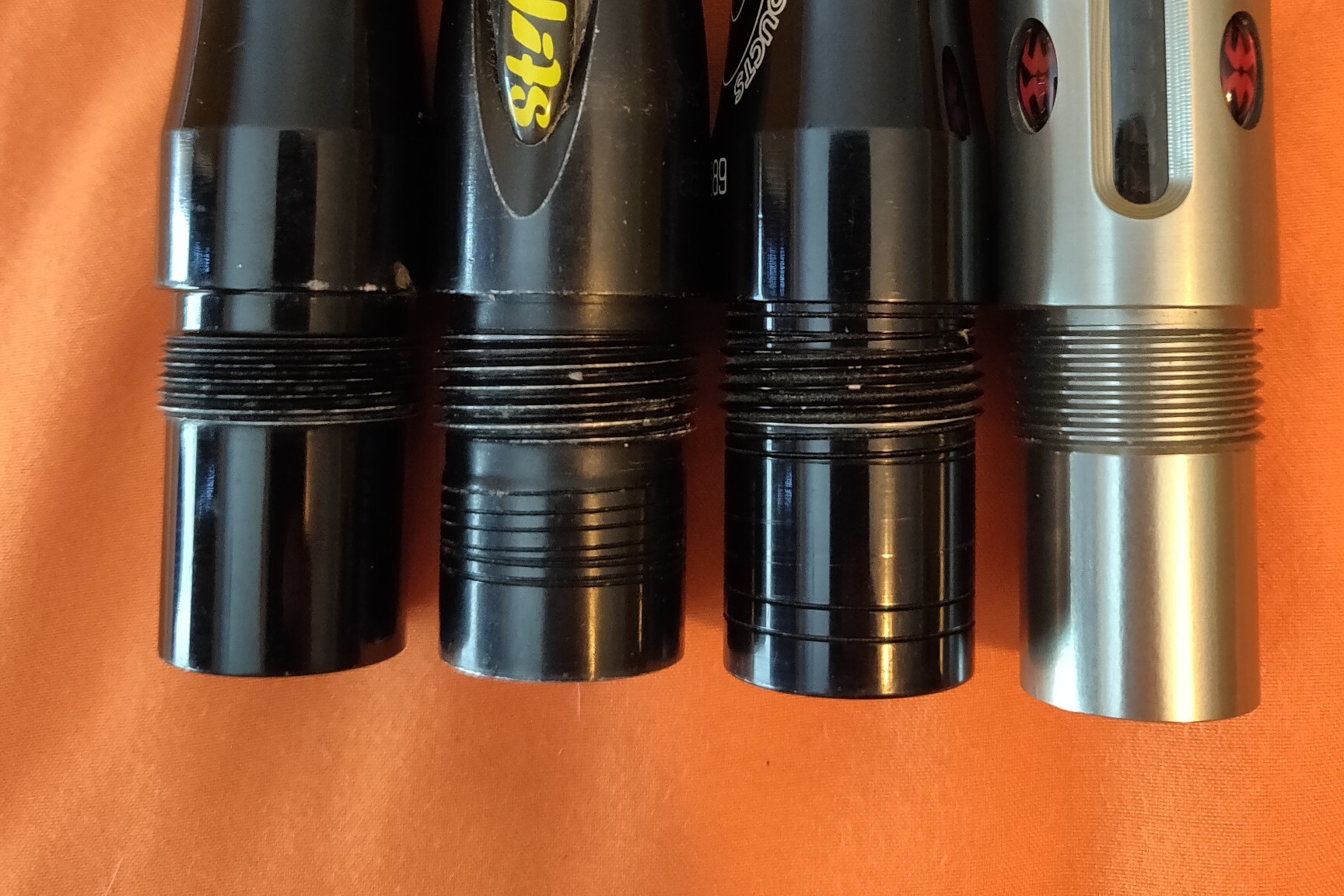

    What threads are these?
    Left is AC threads , right is Spyder threads, two in the middle are the ones in question. They have the thickness and set up of a AC thread but the thread turn is like that of a Spyder. I tried to put these on my ICD 2000 and would not fit either. Any ideas?

    Almost certainly 'shoebox' and SFT-era Shocker.
    Doc.

      I have both of those markers at home so I will test that later. I remember buying these as AC barrels though
        Doc.
        Shocker sport someone was right.

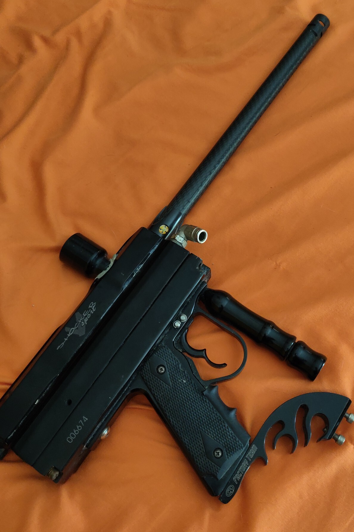

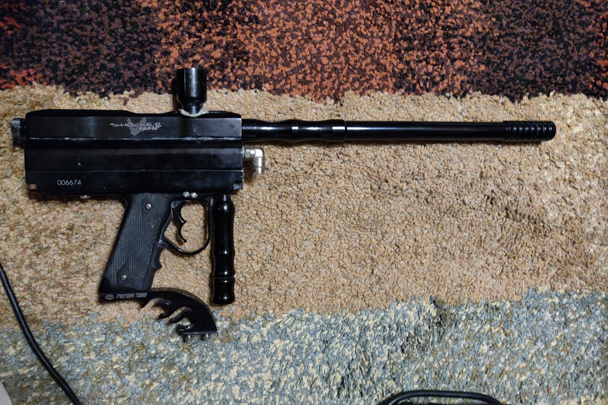

          What is going on with the feedneck of that poor V Sport?

            It's how I received it actually.
          -Smarty Parts used a feed neck thread even smaller and thinner than the original Angel feed threads for their verticals. They rather chronically stripped out, and JB Weld and other epoxies were commonly applied to fix them. SP never bothered to improve them, as the vertical shoebox was only on the market for a year or so, before the '03 single-tube model came out. (Which also rather stupidly used the same thread, but at least offered a bit more support for the "shank" of the neck.)
              Doc.
              Oh, I'm well aware of the idiotic thread they used (makes WDP's look robust), but that looks hideous. However, if it works, it's a minor point, and then Nxt needs to ride it 'til it don't ride no more. And Nxt: that Stiffi actually looks quite nice on there.
              Didn't V Sports come out in '98? I seem to remember seeing one the first time I went to an actual field, which would have been in '99.

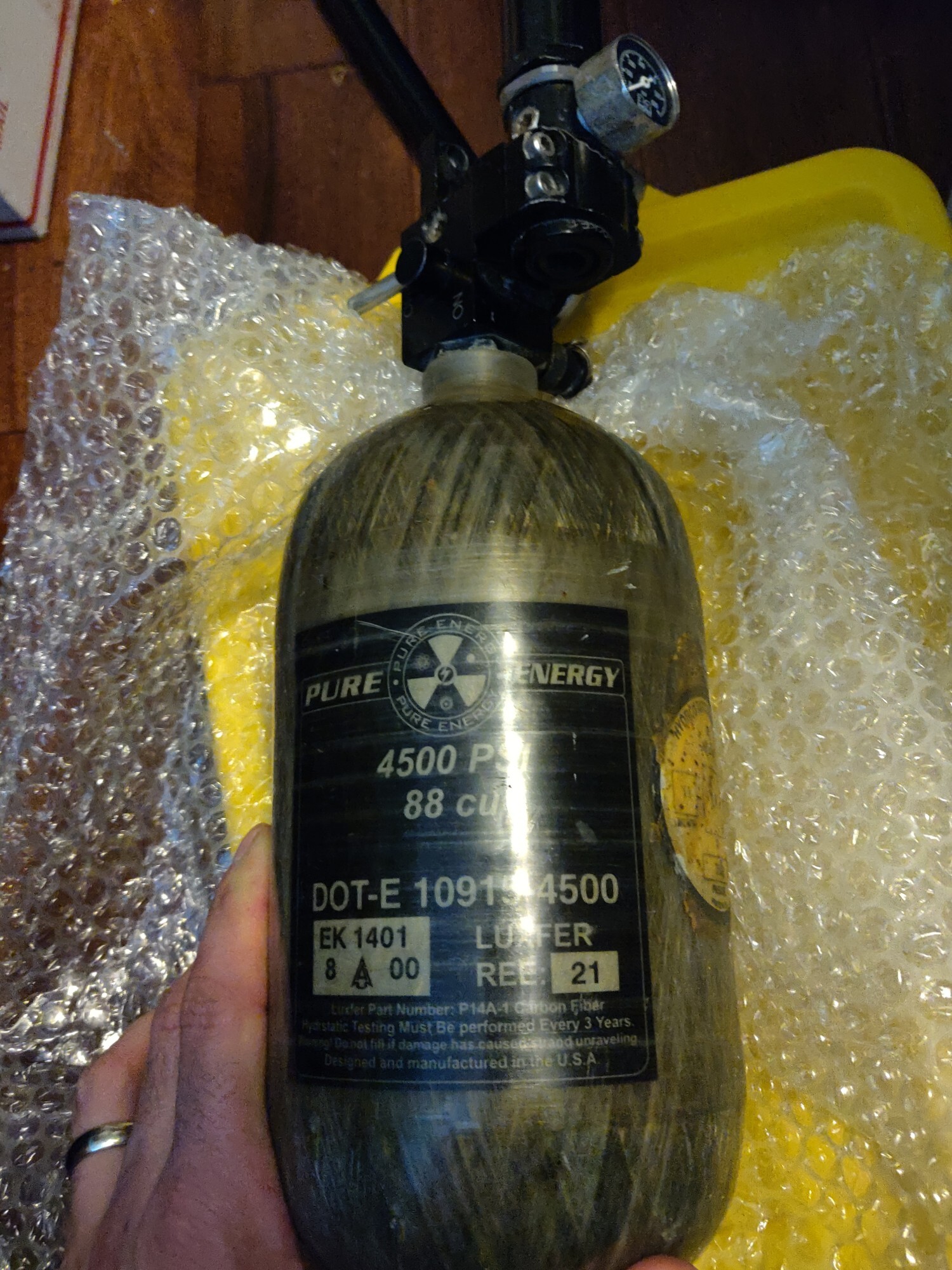

                I have one of those old CP's in Cocker thread. 16", and i really like the way it balances. I've never seen one in Shocker threads.
                How about the tank that was in the box?
                • lew
                  Devious Dirtbag
                  • 1035
                  • WY
                  I have eleven or so of the various iterations of the manifold Max Flos, but I've never messed with a tank-mounted reg before. Should be as solid an bomb-proof as any other Max Flo, though. Except for the addition of the on/off lever, the internals are the same.
