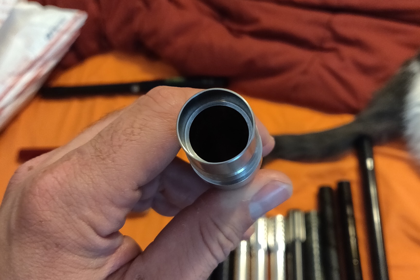

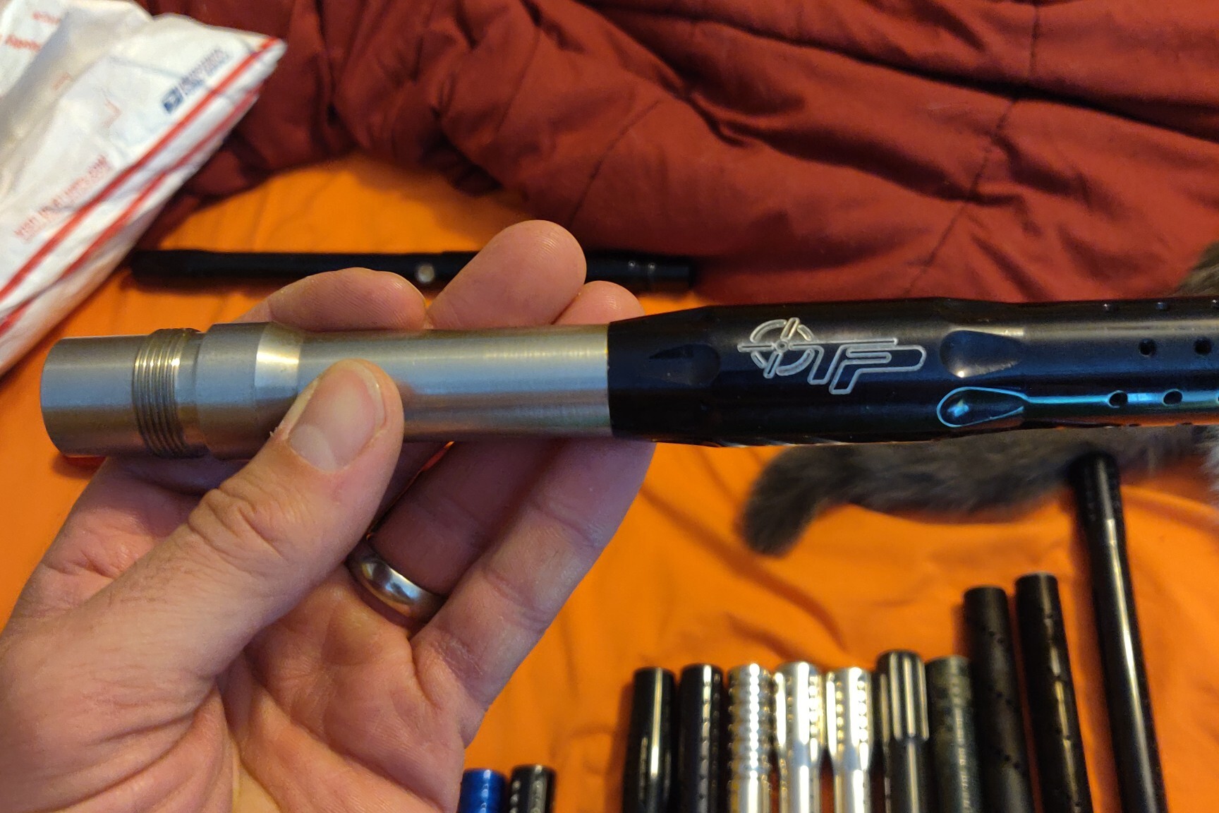

Why is this gap here? Am I missing something?
OTP barrel gap?

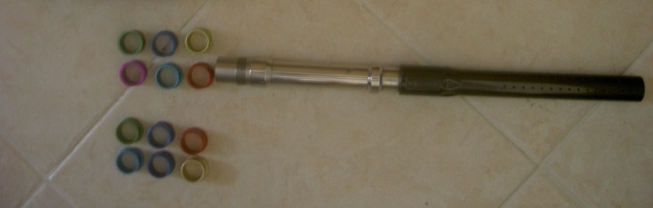

Yes, you are. The OTP barrels came with little short 'sizers', kind of top-hat shaped, and in red, blue and green (and maybe a couple others, depending on the generation.)

Not quite. The Flash barrels were mis-designed and the breech behind the threads was too short.
The OTP barrels in question use little ring sizers that fit in the breech. They are colored to distinguish the ID.
