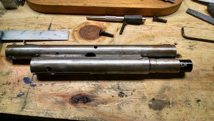

      Something like this?
      That last one was a semi-failed custom attempt. I liked the space between the tubes, but that messes up the feeding pretty badly- the second ball in line has a hard time getting out of the way of the bolt.
      I had some pics of finished ones around here somewhere, one nickled and the others Cera-Koted. I loved how they came out, but I'm not sure what I did with the pictures.
      I have two or three partially-converted bodies, I think, still in the bins. Been meaning to finish up one for myself, but it's hard to find the time.
