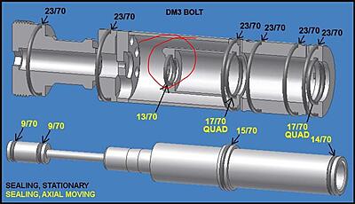

      I regreased my matrix (with exalt hater sauce), and was doing some test firing after , slowly increasing the LPR, and a bad leak developed after 6 or 7 dry fires. The leak is straight down the bolt center. I degassed the gun, and turned it off, and now as soon as the gun is gassed up, the same leak occurs , straight down the bolt. The bolt is the back position
      I'm assuming an oring or more is bad. Do you have intuition which oring (s) have failed?

        Inner tophat oring? Where's the air coming from, bolt face or around the bolt?

        Figured it out, it was the inner 13/70 oring.....see pictured below. It had become unseated. Since I had the spool all apart , i replaced the oring with new and leak went away. BUT....I still cannot tune this d#mn matrix for the life of me!!! The first shot drop off off is still terrible.

      Found the leak, 13/70 oring had become unseated. Replaced it , and leak was resolved.

          Tracker , you're a genius! that beer can piece (called the Cylinder as per DM3 manual) was backwards! i flipped around and re-tested and the first shot drop off issue is fixed. i was able to turn my main reg down a lot too. i'm pretty happy that i don't seem to have damaged anything.
          this also means that zdspb diagram above is wrong in terms of displaying the orientation of that part. Future Matrix newbs like me should follow official matrix vendor guides, and maybe only keep the zdspb diagram for the orings specs

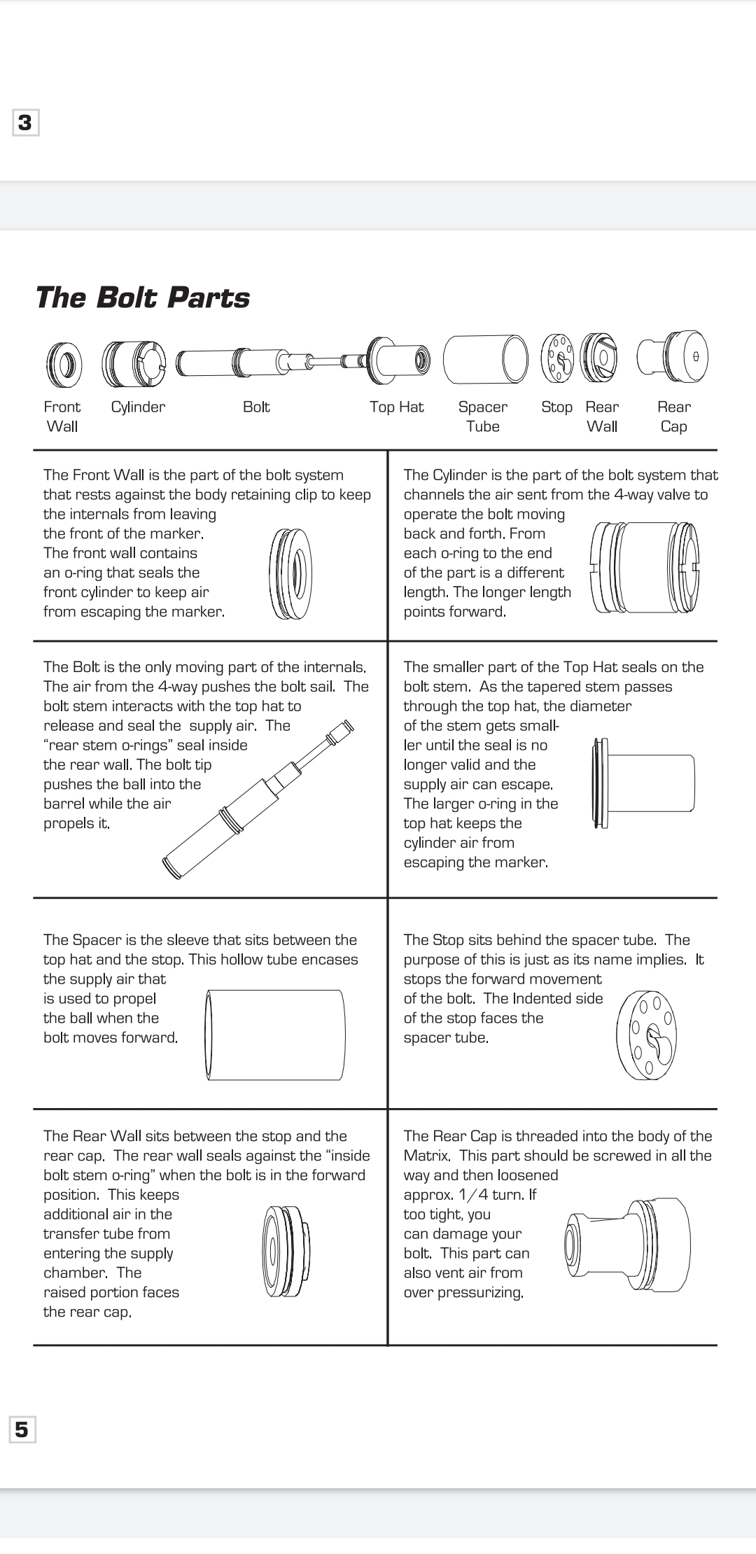

            Screenshot_20210814-121727_Drive.jpg I grabbed this screenshot from the Dye manual... it's a potential troubleshooting guide AND it tells you what way everything goes. I did the same thing on mine and had the beer can in backwards after I greased it.

              that's a good idea to cap off this thread with the proper Bolt Diagram!
              If I had found the proper diagram when I first started trying to tune my Matrix , I would likely have never needed this thread to begin with! But i am pretty happy its resolved, because I can add the Matrix back to the rotation for Wasaga!
