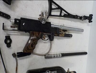

    Hey everyone, a friend is looking at this old cocker and just wondering it's approximate age.

    do you know the serial #? looks like around 95
      What he said, definitely pre2k. Looks like a sweet shooter that probably feels really good in the hands

        Find serial number - https://pastehtml.com/view/c9halptdq.html this was community created and compiled many moons ago by Thumper but has a pretty good track record. WGP did not keep good records and serialized asynchronously at times depending on the specific version so there is no Holy Grail for serial number dating.

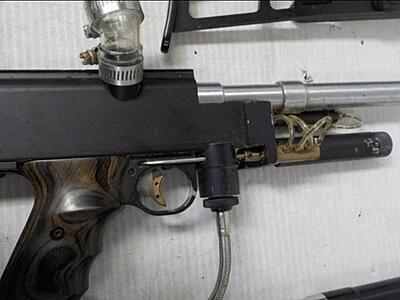

          Good parts on this one, look like shocktech bolt, smart part wood grip (really confortable grip), pot metal slider (might need cleaning/polishing on the trigger plate to run really smooth but I like them). Its setup for CO2 so could use a HPR and new spring and would be a really good shooter

            It's at least a '97 body, probably older (straight sight rail, no rounded body corners).

              Thanks everyone, I thought it might be a around a 97. I'll see if he can get me the serial number on it.
