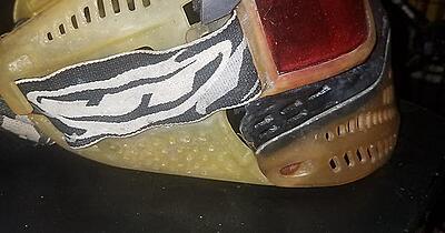

    Is there a way to clean the mask?
    Also do they still sell the red tinted lenses? They were my favorite.

    Take it all apart, use microfiber or damp cloth. Q-tips for tight spots. The yellowing can't be undone.
    Red lenses aren't made anymore but clean examples so pop up for sale once in a while. The Proflex BST group on the stupid facebook is a good place

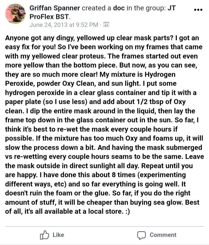

    Flex soup you can get the yellow out. It’s on the flex BST pages under saved files on BookFace. It’s a combo of soap and UV light.

    It works gotta follow the process it will clean that mask up a lot.
    The lens looks shot sadly.

      I’ve got some OG clear bottoms, ears, and a thin frame from ‘02 that need to be de-yellowed. I looked at the Files section on the Flex BST group, but there aren’t any files. Anyone have a link to the flex soup recipe?
        Is this it? This is the best I could find. FB files tab called it a "doc", but it appears as just a normal post. I don't see the pictures that Spanner is referring to anywhere.

          Excellent, thanks! I will give it a shot once the weather clears up.
        • jokers
          jokers commented
          If you have it you can also use a UV light rather than the sun. They make them for grow lights, nail polish and epoxies.
