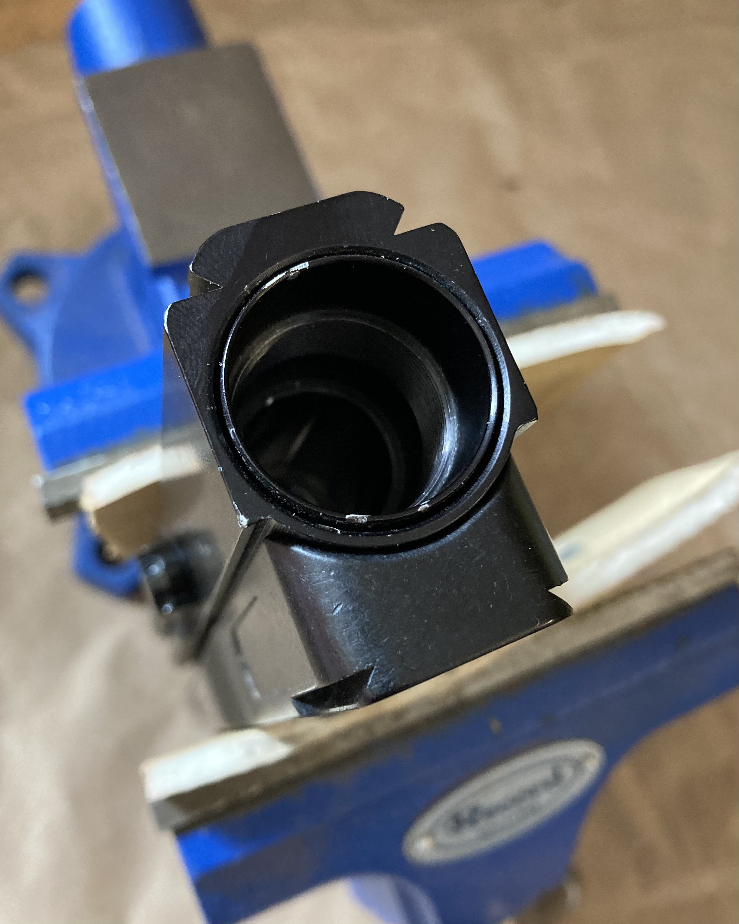

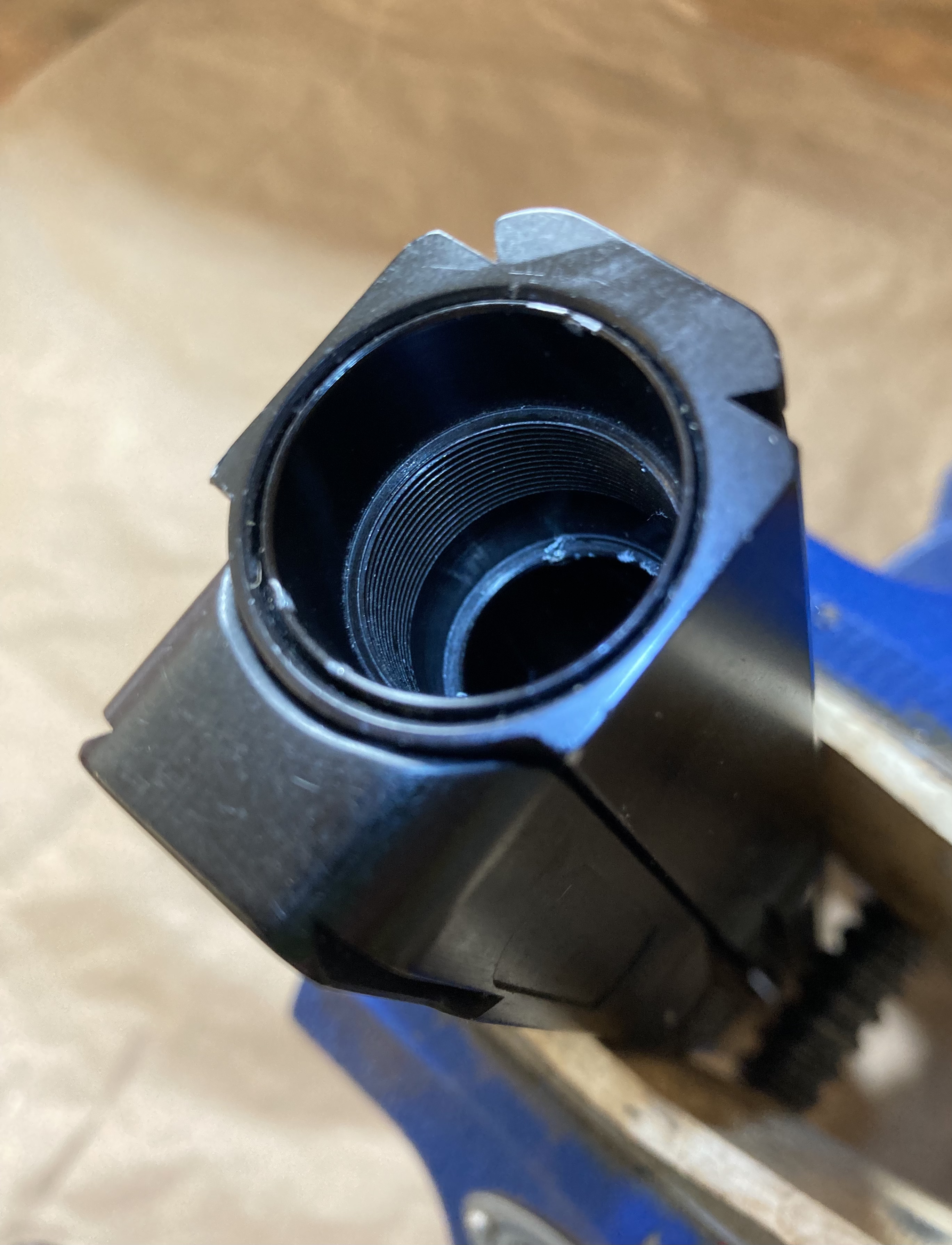

    I’m hoping someone on here might be able to help out with this. I purchased a Tac-One last month off of Kijiji. The guy failed to mention it wasn’t AC threaded and now he won’t respond to any messages. So as you can see it has some sleeve installed and the thread appears to be either 0.8 or 32 pitch according to my thread gauges, they are so close it’s hard to tell them apart. I have tried all barrels I own that look somewhat similar without luck. I think a freak front is 32 pitch, but double lead, so it won’t thread on.
    I have sent an email to Sandman, but probably won’t hear back till Monday.
    Anyways, anyone recognize these threads?

    Cocker to A5 adapter?

      If it’s an adapter, then it’s really stuck in there. I tried my Carbine barrel, but it didn’t work.

      Are there 4 leads? I see atleast 2 in the one photo. Id guess ICD threads than.
      Amd i dont know tac one bodies specifically, but could there be a retaining screw under the rail making it stuck?

      Not ICD threads, at least not the ones that fit my Fox or my Panther. Tried both. No screw underneath holding it in place.

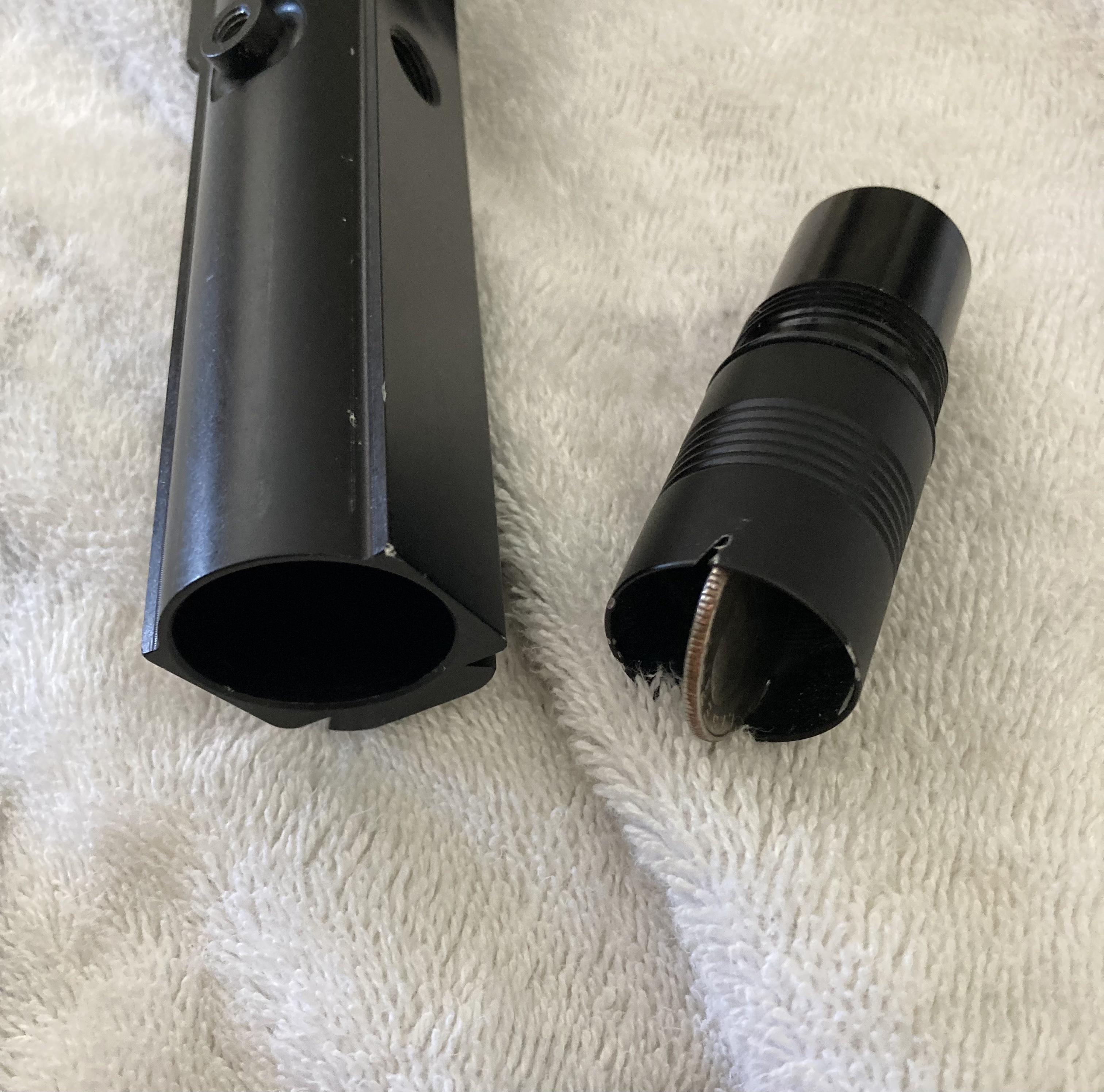

    I thought about using a taper drill bit, I had it out on the workbench. But I went a different way. Carefully cut a couple small indentions on the the sides and jammed a quarter in there. Then used some vise grips and it came right out.

      Jordan commented
      Nicely done!

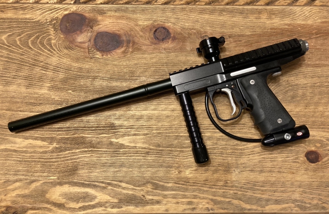

    Back up and running. 😁
