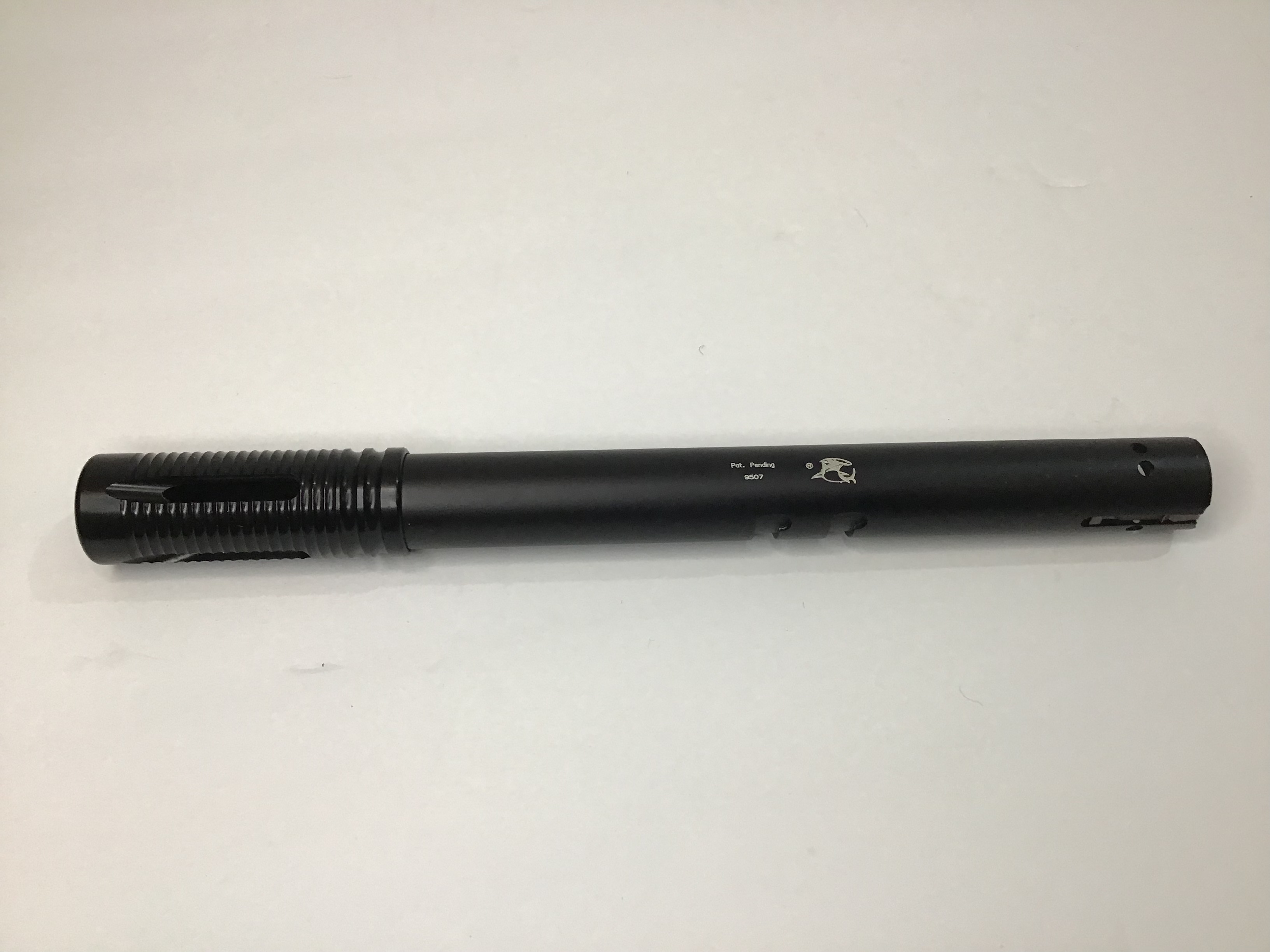

    I’m not very versed with the Tiberius guns.
    What does this barrel fit? It came to me in a lot.
    Thanks!

    Sure looks like a T8 or T9 barrel.
    Does it have double indexation for bottom and side feed?

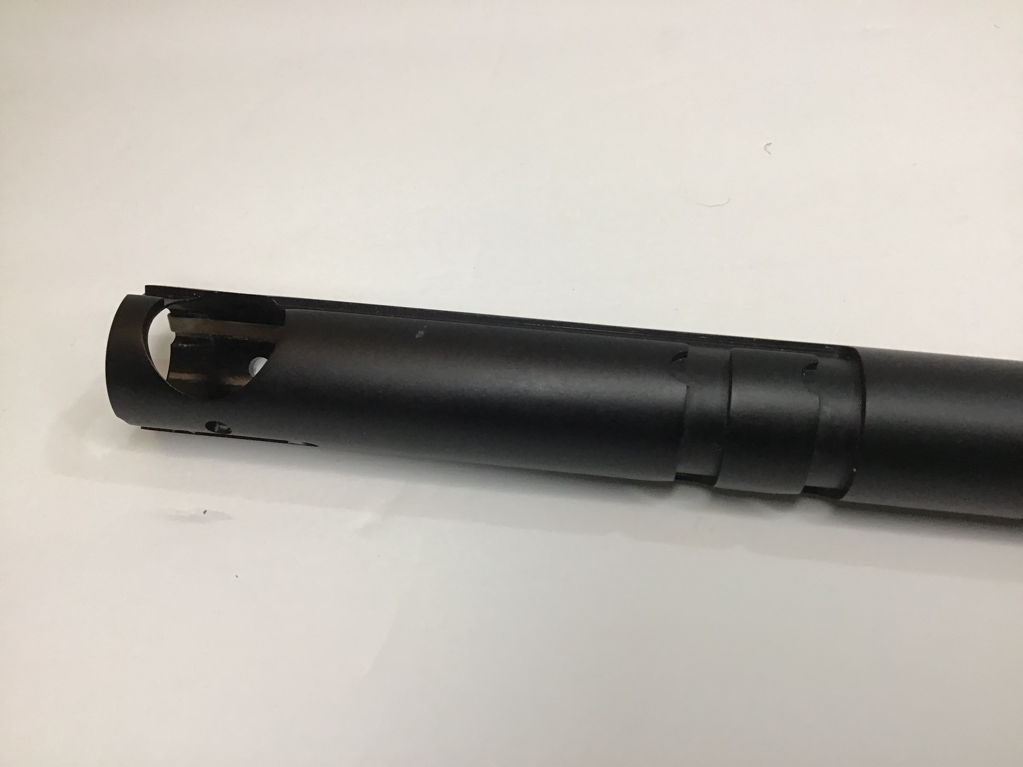

      The double slots are what’s making me question what it is.
      The cutout slots are identical, one is just further up than the other.

        So it does have double indexing ...
        it's for the (I believe) T9 one index is for mad feed and the other for hopper feed.
        They should also fit the T8 ... (I think ...)

          These are for the T8 and T9. Those had the metal detents. The slots are where they fit, you could remove them, clean then, replace them, modify them. It is indeed double indexed for the T9, as you need the breech to be turned one way for magazine feed and turned differently if you are using the hopper attachment. Another give away, is that the T8 and T9 barrels are cut for roundball only. It was not until the .1 kits and the 8.1, 9.1 release that you have barrels cut to allow feeding of both roundball and first strikes.

            T 8.0 and T9.0 barrel. Won't fit 8.1 or 9.1 or anything else. Cool Hammerhead.

              Seajay is absolutely correct. The T8.0 and T9.0 barrels do not fit the .1s at all.
