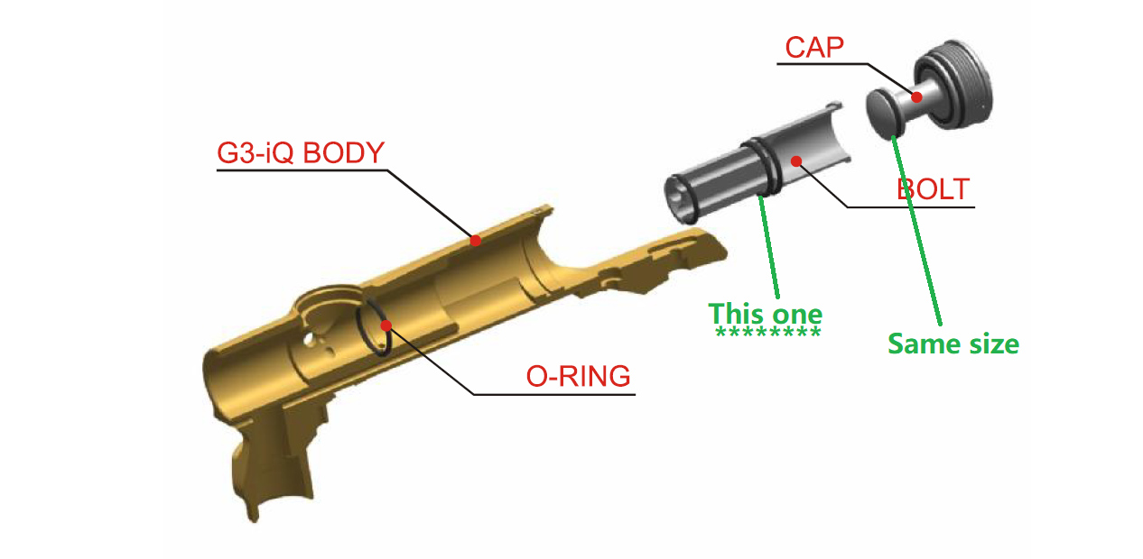

          Click image for larger version  Name:	qzwlCJM.png Views:	0 Size:	169.7 KB ID:	180123
          It's this one here (or at least it was for me). This oring being bad and leaking-by created kind of a bolt lock up, IIRC, and kept the bolt from cycling.
          If you don't have a fresh oring, I think the one on the bolt tail piece is the same size. You could try swapping it and see if your problem changes to a leak-down-the-barrel...?

            On Rainmaker's picture, there is an o-ring inside the body. You might as well replace that one as well, when you're replacing the bolt o-rings, since that o-ring also causes drag on the bolt. However - you might also want to replace the bolt o-rings first, to see if the problem goes away. The o-ring in the body is a real pita to get back into place. Or possibly I was not smart enough to do it the easy way.
