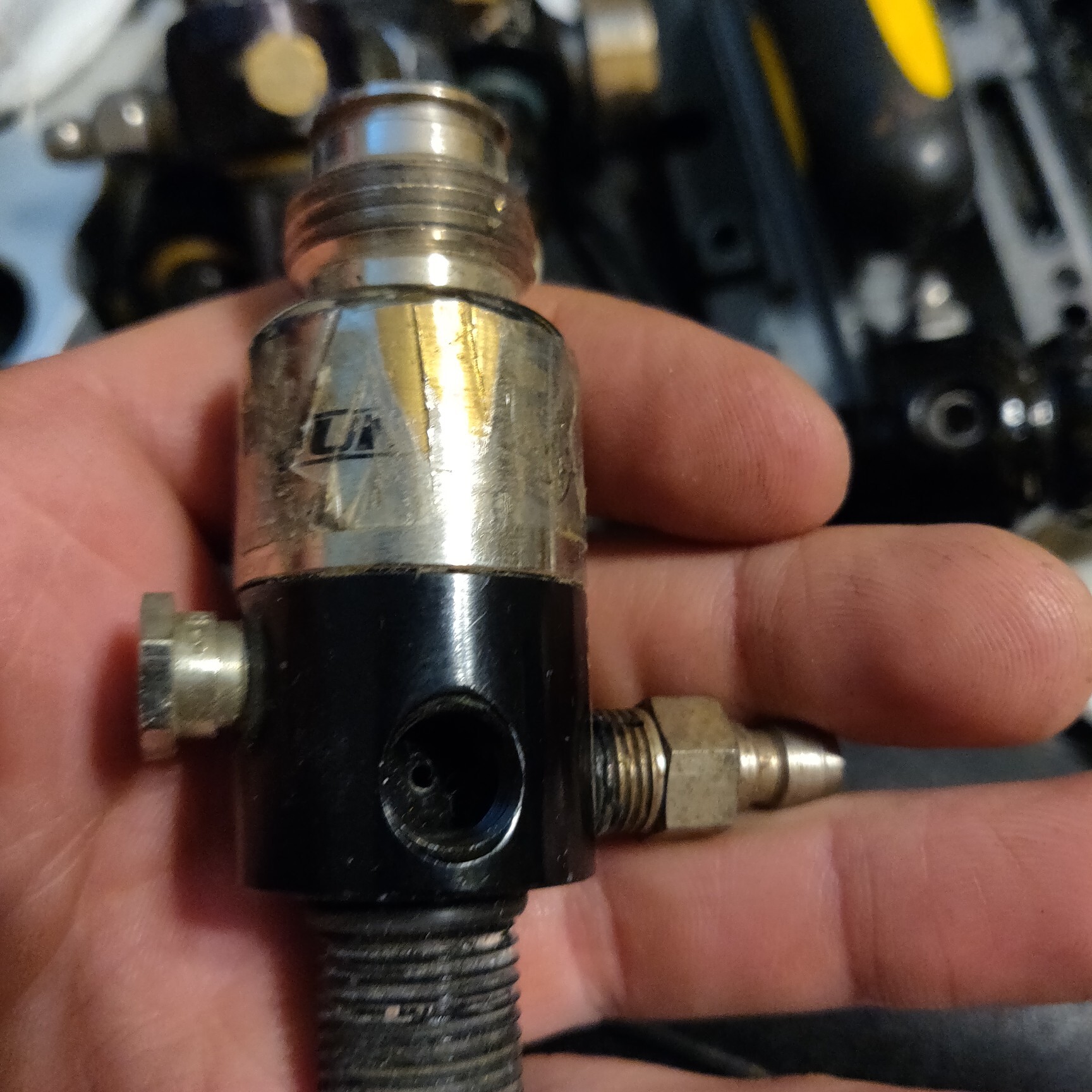

    How do I get these top hats off? Vice grips?

    I would try a strap wrench before resorting to channellocks.
    Maybe hit the bonnet with a heat gun, or stick the bonnet in boiling water for a minute. There might be some sealant used if they didn't intend for it to be rebuildable.

      If Heat serviceable permanent loctite, so ya need to heat it. Probably a plumbers propane torch quick & easy , might take quite awhile with a heat gun.
      Looks like someone used a pipe wrench already, a new Reg can be found for $40 +/-

      Don't forget that it opens really easy since it's reverse threaded.

        Are you messing with me? All the regs I've had so far are in regular threads.

      I bought a couple boxes of regs a while back for dirt cheap I'd like to make as many good as I can.
