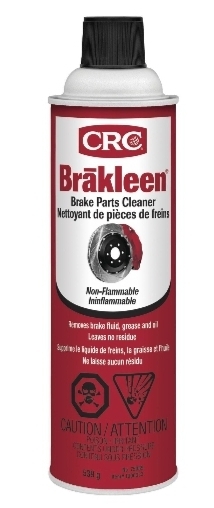

    I have two ULE body with the standard feedneck Loctite in place (dont know if its red or blue). Tried strap wrench and heat gun and it did not worked (strap wrench slip more than grip).
    I have seen a video on youtube of someone melting red loctite with chlorinated brake cleaner. Anyone tried this method?
    He also mentionned it was not affecting anodizing (will try it on a cheap part before to be sure).
    Here is what he used in the video
    Click image for larger version  Name:	Screenshot_20211031-083631_Canadian Tire.jpg Views:	0 Size:	51.9 KB ID:	187406

    In my experience (industrial and commercial) brake solvent chlorinated or not hasn't had any noticeable effect on red lockers.
    You're on the right track with the heat gun probably just need to heat longer .

        That CRC is tetrachloroethylene, I think. I wonder if Henkel publishes compatibility charts.
        They recommend a solvent called "Chisel" but it's methylene chloride-based.

            chlorinated brake clean will probably affect the ano (dont think it will loosen loctite). using a heat gun or hair dryer is a safer method for anodized aluminum - gotta heat it till u smell loctite melt, see smoke, or bubbling near threads

              I’m %99 sure the brake cleaner claim isn’t real. Brake clean doesn’t dissolve much of anything, that’s sort of the point. You can’t have it attacking everything it touches when mechanics basically spray everything with it all day.
              Heat is what you need, guns…may not be enough. Fire works real good.

                Go test it. I don’t think it will do shit.

                        Localized heat greater than 550° F is the only way. It’s the Devils sauce! It’s meant to be permanent. The bolt or feedneck will rip its threads out before the Loctite let’s go without heat. BreakClean won’t touch it I don’t care what the YouTube video says.

                          Even if that does "work on loctite", there's no way that stuff would leach into the inner threads of something that's screwed in tight.

                            Brake Clean might Clean the loctite... but it won't penetrate into the threads.
                            Heat is the only way.
                            Brake Clean is amazing at removing oils.
