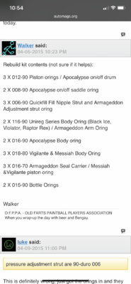

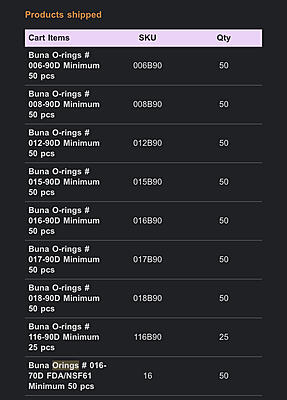

      I rebuilt mine a while ago but that seems to be the right size. I may have put 90 durometer in there tho but can’t remember. Here’s my notes from when I did it…screenshot of post from Automag.org and my oring order list. Sorry can’t be of more help.

        Hi,
        Thanks I took a screen shot of that same automag.org post and made my parts lost as well.
        In your parts order--the 017-90 orings, what are those for? The reason I ask is that I saw a post in that same thread about the 017 being the outer seal oring.

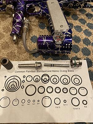

                  Advanced sorry for the delay, finally got a break from house projects. Yes very smooth with no wobble. Checked the oring size and I used a 017 90D for sure inside the carrier. Put it back together and still regulates perfectly fine with fast recharge.

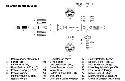

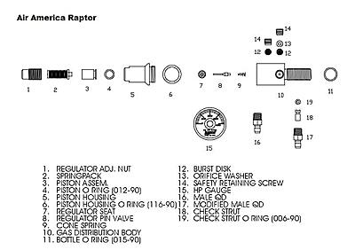

                      Hmm, I wonder if they slightly changed design halfway through manufacturing the Armageddon. Either way 90D seems like a good idea. Here's from a couple of their other designs and they use 90 durometer for all the rings. (This might be a good depository for Air America info for individuals in the future).
