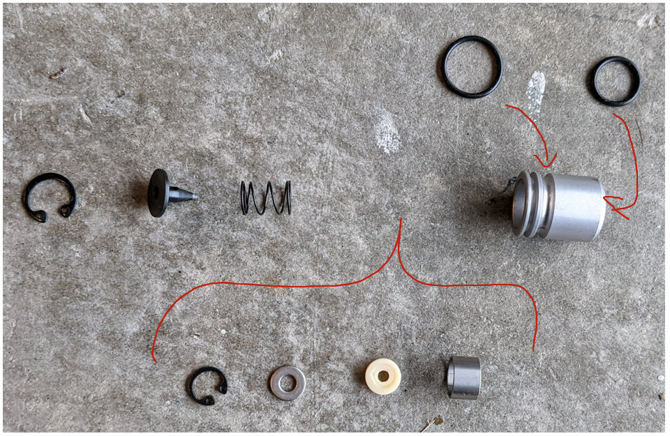

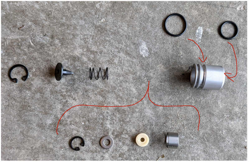

              I don't know about #2, but my SA-17 stays aired up all day ...
              I'm a bit out for the seals, but I'll send you a few to try out when I print them.
              There are a few orings on the assembly, maybe another one?
              the one inside is a not static, make sure it's well oiled/greased.
              Here is a pic of the entire assembly: Click image for larger version  Name:	fetch?id=208430&d=1640112816.png Views:	0 Size:	1.31 MB ID:	213862
