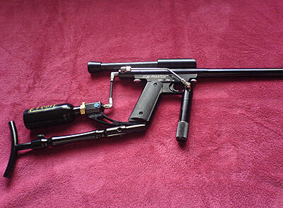

          Doc makes a P Stock you can add an ASA and tank to. Most people just use the tank as a stock and mount an ASA direct. But if you wanted to use a tiny tank and still get the length you need out of a stock it’s always an option.
          I always thought this setup looked well thought out. Small Co2 bottle or even a 9ci/10ci tucked out of the way on the inside. It’s not hanging off the bottom and will keep any additional weight toward the back. I bet it handles well. Always thought it was a ingenious way of using those big old drops nobody uses much anymore. I probably would just remove the Vertical ASA and plug the valve on the side run it like that. He just ran it directly to the back of the valve threw the gaged port in the VSC valve.

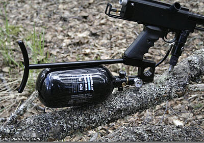

            So my idea was to take my Spartan with the 12-gram changer, and run a constant-air dummy in it. Then mount the L Stock to the grip (that I just bought off the BST area), with a 13/3000 mounted to the stock. On the tank would be a remote adapter, with a stainless line running from the dummy 12 gram to the remote adapter.
            Here's a pic off Doc's site showing a similar set-up, minus the tank (and on a Phantom instead of my Spartan, but same idea). In Doc's write-up, he mentions the "california style constant air" by mounting the tank to the "arm" of the stock like I'm envisioning.

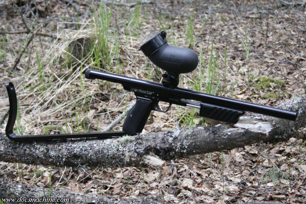

              When I run the Phantom open class I mount the P-stock I got last Walzmas...thanks Carp! It's a nice setup and easy to shoulder. At one time I put it up to trade for an L or T stock but once I used it, I changed my mind. Bought a T-stock for the stock class setup instead.

              -As the others have noted, the "underslung" tanks, mounted with a ring or clamp of some kind, was called "California Constant Air", or "California Style". Started, of course, back in the days when a "big" tank was one of the long 10-ouncers, and with a hand-knob "thermo" valve, you couldn't screw it in like a back-bottle. So they hung it underneath, in a style popularized in California.

              -I've made both. The very first P-stocks I made back in the day were basically a copy of the Marksmann style stocks, as shown on BigRed's Phantom above. Except mine had a round hole in the "P" section, as I was hand-making them, rather than cutting the sections from extrusion. Later, I had blanks water-jetted, and they had a smaller trapezoidal hole, and then when I started remaking the P-stocks a year or two ago, I went back to the round holes.

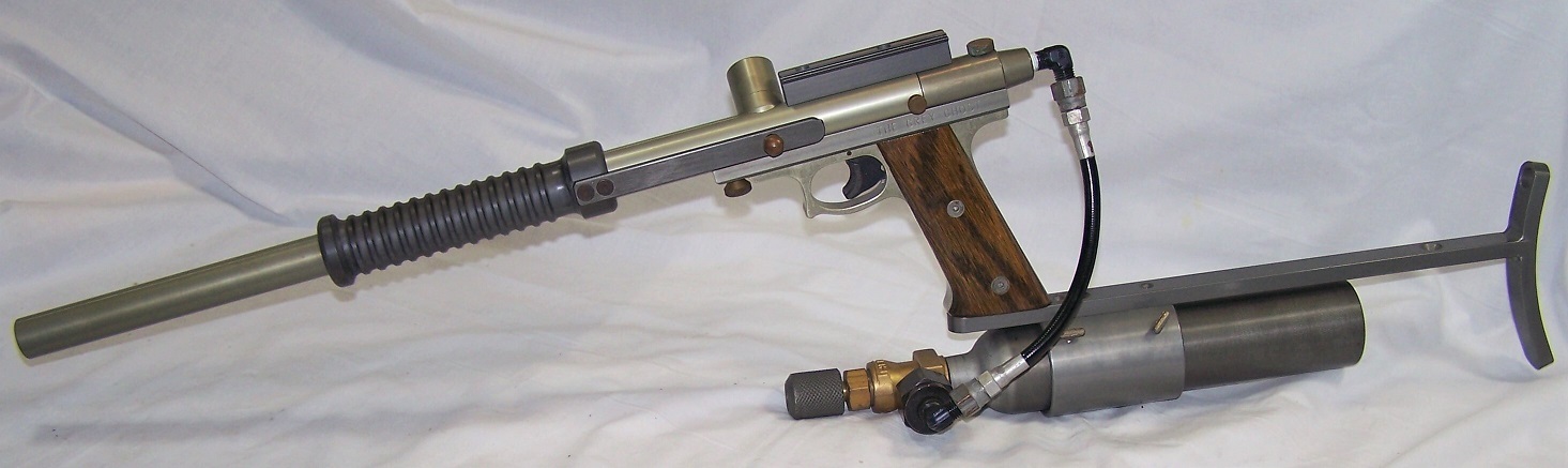

              When I brought back the L-stocks, just before the Big MCB Crash, I was also working on a batch of Carter-style tank rings, which, when coupled with a modern (albeit a bit hard to find) 22ci HPA tank, does a great job in emulating the original 10-ounce 'California Style' setup.

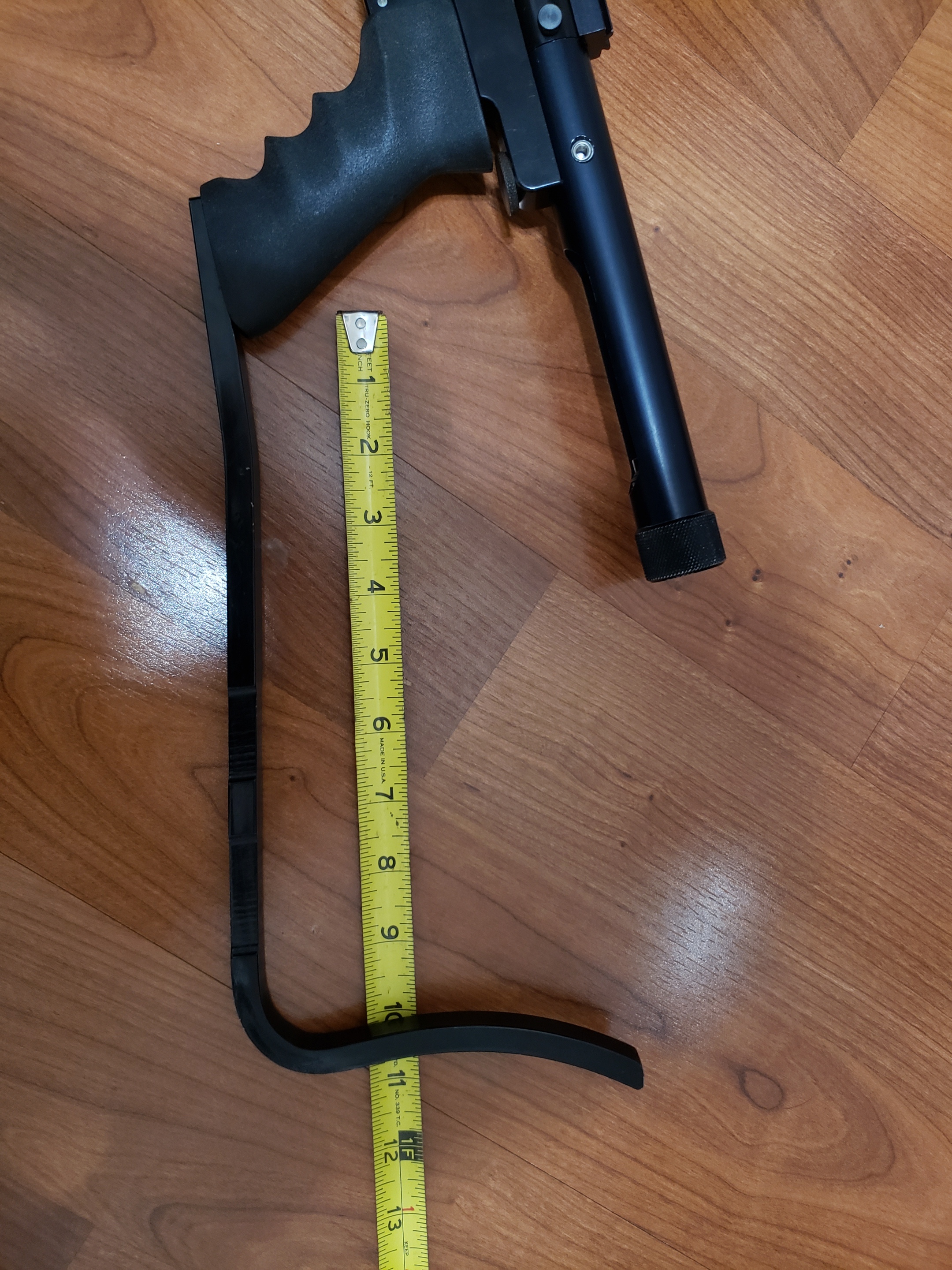

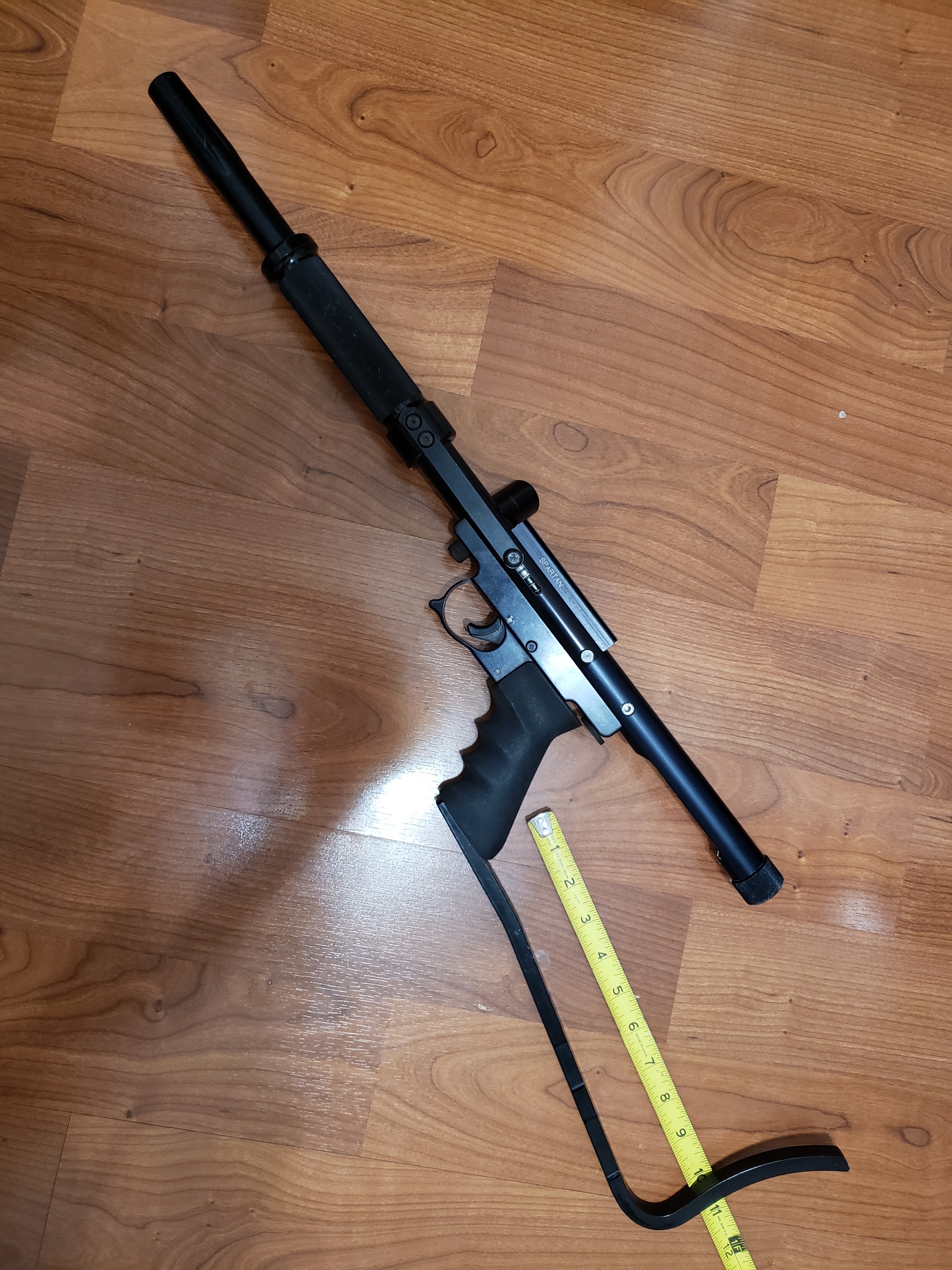

                  Got my stock in tonight, thanks JeepDVLZ45
                  After its mounted, I don't think I will have room to mount the tank between the stock and the 12 gram changer. I have about 10" of clear space right now, but realisticly, that usable space is less as I need to get my thumb around the grip.
                  I could be wrong, but I think a 13/3000 + regulator + fill adapter (on/off ASA) will be too long.
                  ANS gear lists the OAL of the Ninja 13/3000 at 9-3/8" (with regulator) leaving no room for the on/off ASA.
