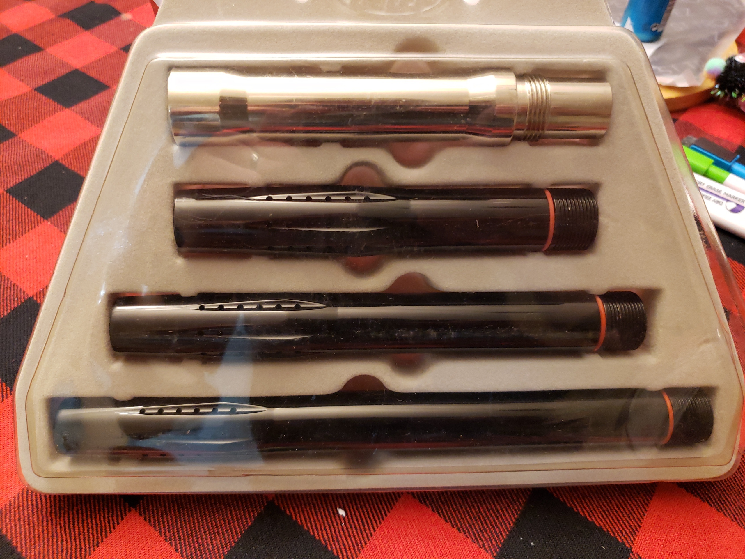

    So I just got my brand new WGP "Tripple Threat" barrel kit in tonight. Was super excited to try it out on my pump gun.
    Well, went to thread it in, and the shank dropped right through the breach. The threads didn't even catch or anything.

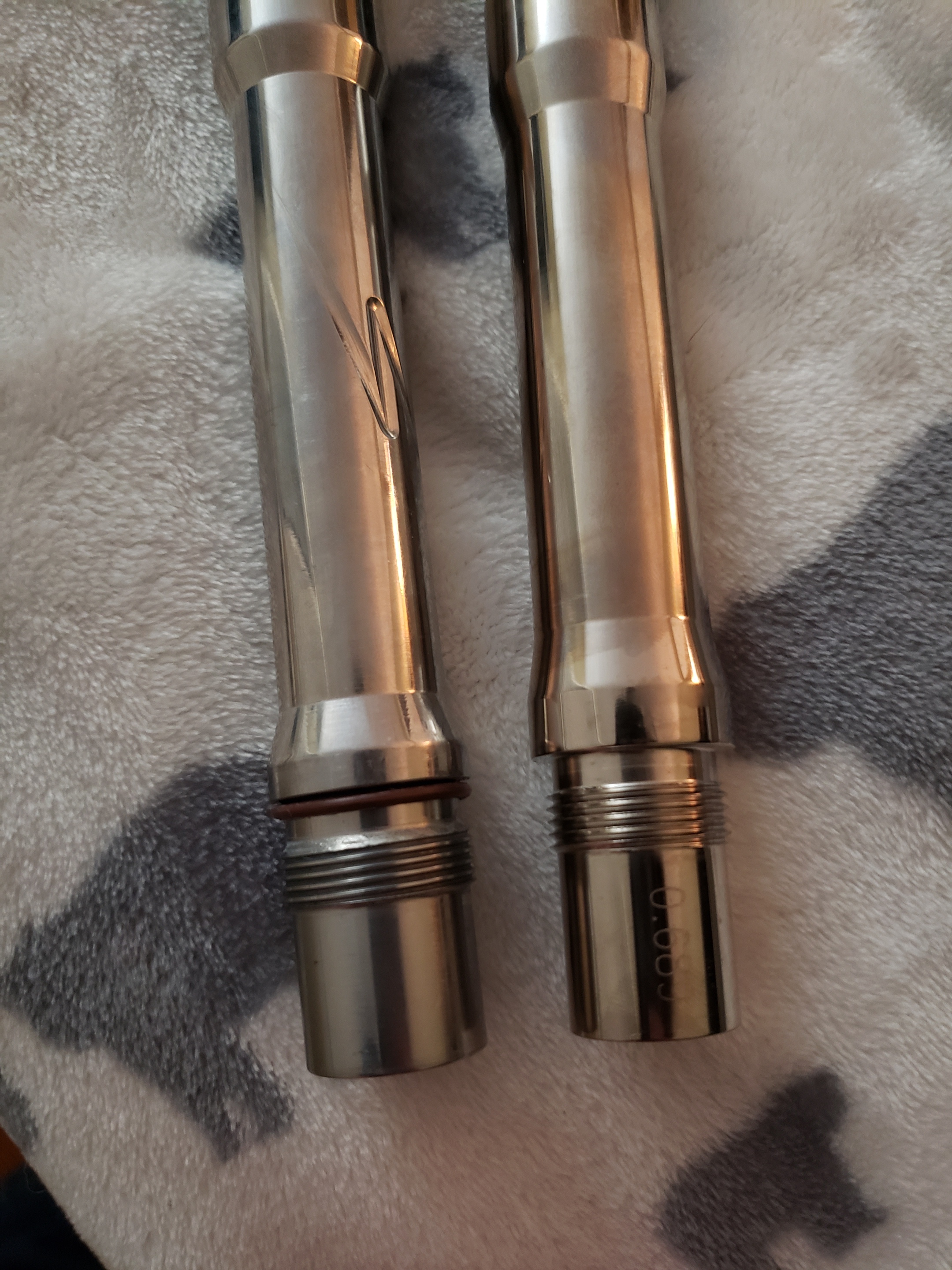

    Upon closer inspection, the threads are much smaller than the AC barrel I have shown next to it.
    I'm wondering if these are Spyder threads or something. The one marked .689 is the thread in question. The other thread is my AC barrel.
    • 4408
    This looks Spyder-ish...
    Don't forget Budd had a few Spyder clones in the latter days stable
      Alexndl commented
      Not sure if all WGP spyder clone had spyder thread thread barrel. I have a WGP T-ranger (STBB spyder clone) and barrel is cocker threaded

    Spyder. Looks like cocker until you compare them side by side.

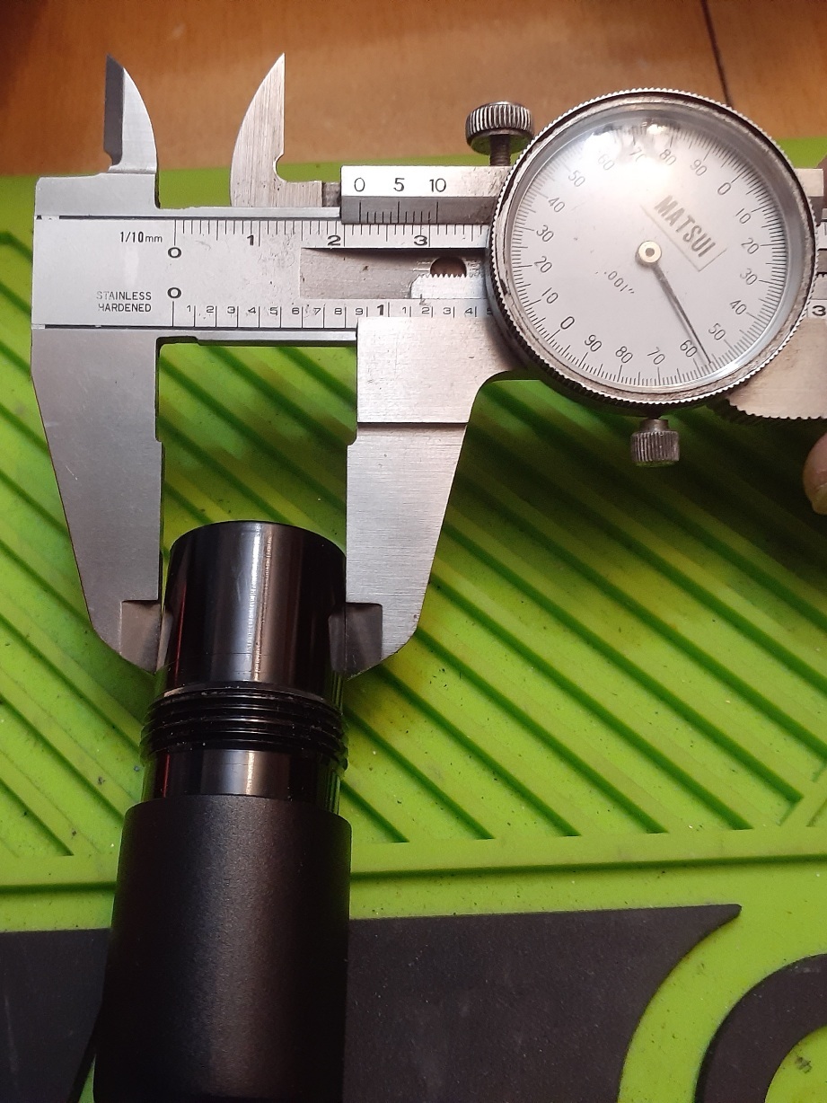

        Okay, got a question.
        Will these tips work with my other AC barrel? i didnt try them yet, as i didnt even think about it until just now.
        Here's the other AC barrel that came with my Shocktech Vortex.
          Ecapnation commented
          No, that's a J&J barrel

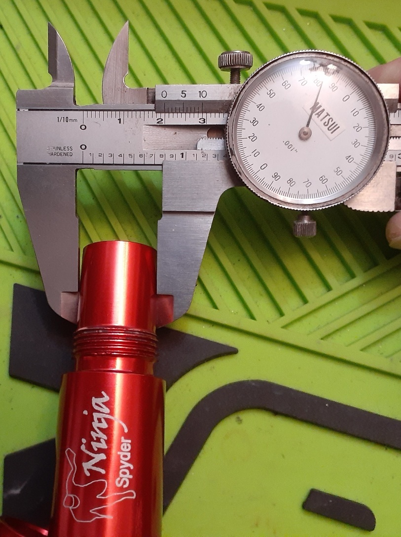

          If you have a dial caliper,
          the diameter under the thread for a spyder should be 0.785"
          For a cocker its 0.857"

          Shank measured .785 diameter. Looks to be spyder thread.

            So fun fact, the black tips from the WGP kit DID thread into my J&J back. However, the did not reach all the way down. The J&J tip has a smooth longer section that is un-threaded to reach past the threads in the ID of the back, where-as the black WGP tips do not have this un-threaded portion.
            While they do technically thread in, there is a small gap between the back ID and the tip ID.
