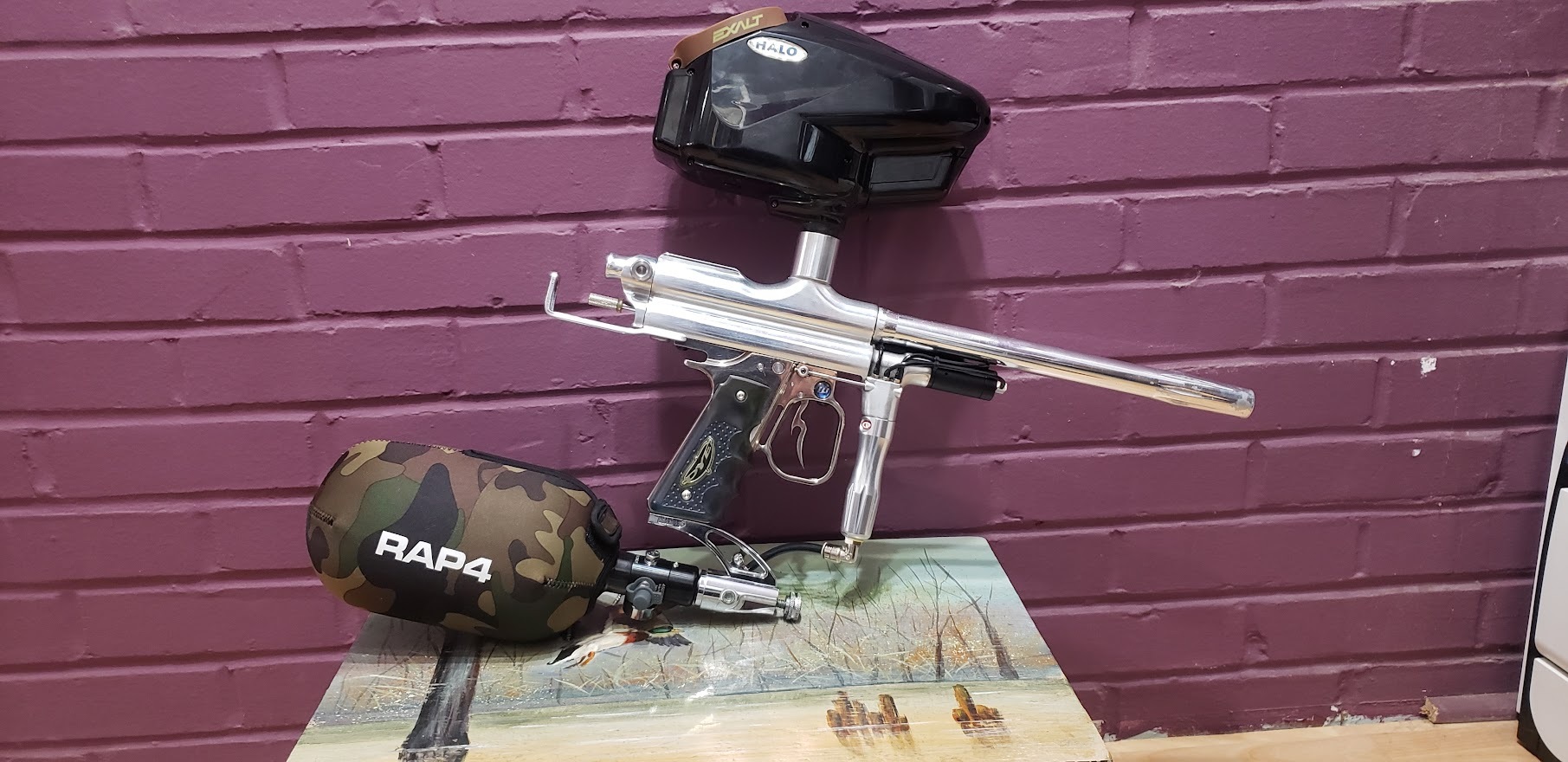

    Hey guys, I bought a Trilogy Sport not too long ago. OK, I get it... it's not a REAL autococker and all that (I've had cockers before so spare me) but for my purposes it will do. I'm an old school baller that is just looking to get out on the field and keep it as cheap and simple as I can.
    OK all that noise out of the way...
    I want to put an HPR on it, but I believe It needs to have lighter springs. There is a set of lower internals on eBay for the Trilogy "Pro" which had an HPR instead of a gas through grip. Is there a difference between the two sets of internals (Pro and Sport) or is it all the same on the Trilogy and they are just throwing hype with the "pro" moniker?
    Thanks in advance for any advice I can get.
    Oh....It was blurple and I stripped and polished it. Pic just cause I think it came out pretty good.

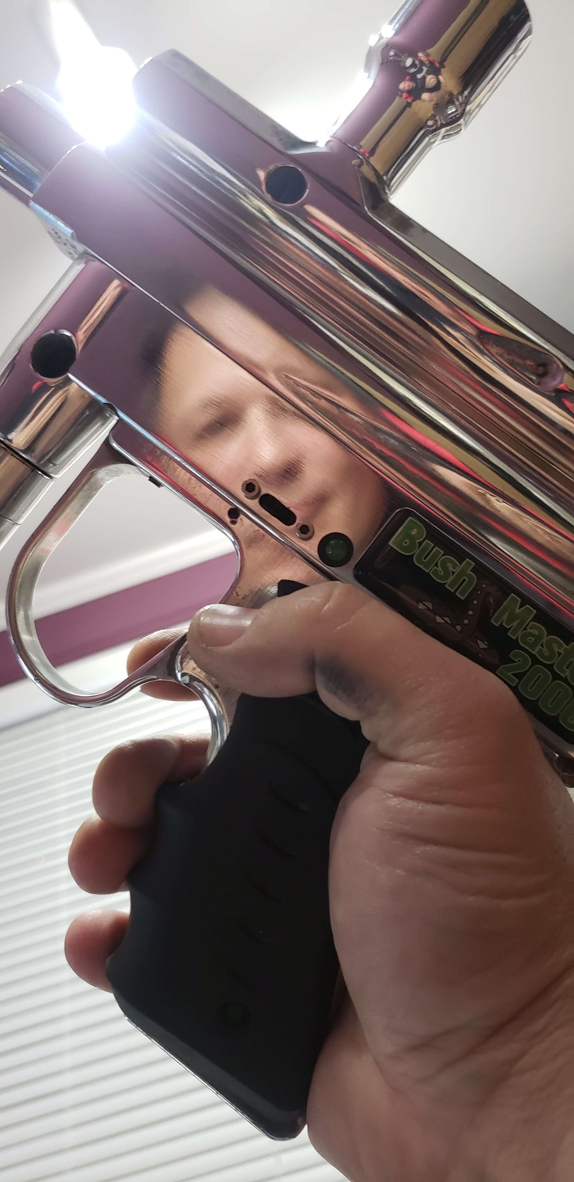

            Thanks man. I'm going to hit it again to get the mirror finish I was originally trying to get. I've got a few new tools for the job that will do a better job at the final finish. I did a B2K more recently and was really happy with the outcome.

            Thanks man, labor of love. I;m going to rip it all apart again and get those lines out where my reflections is. It’s just… bugging me. I’ve got a few other spots that need to be cleaned up on the feedneck and the teardrops in particular. Going to be out of town for the next week but when I get back I’ll be working in that and talking to a machine shop about a possible run of 15 degree ASA’s for the B2K if I can get enough interest.
