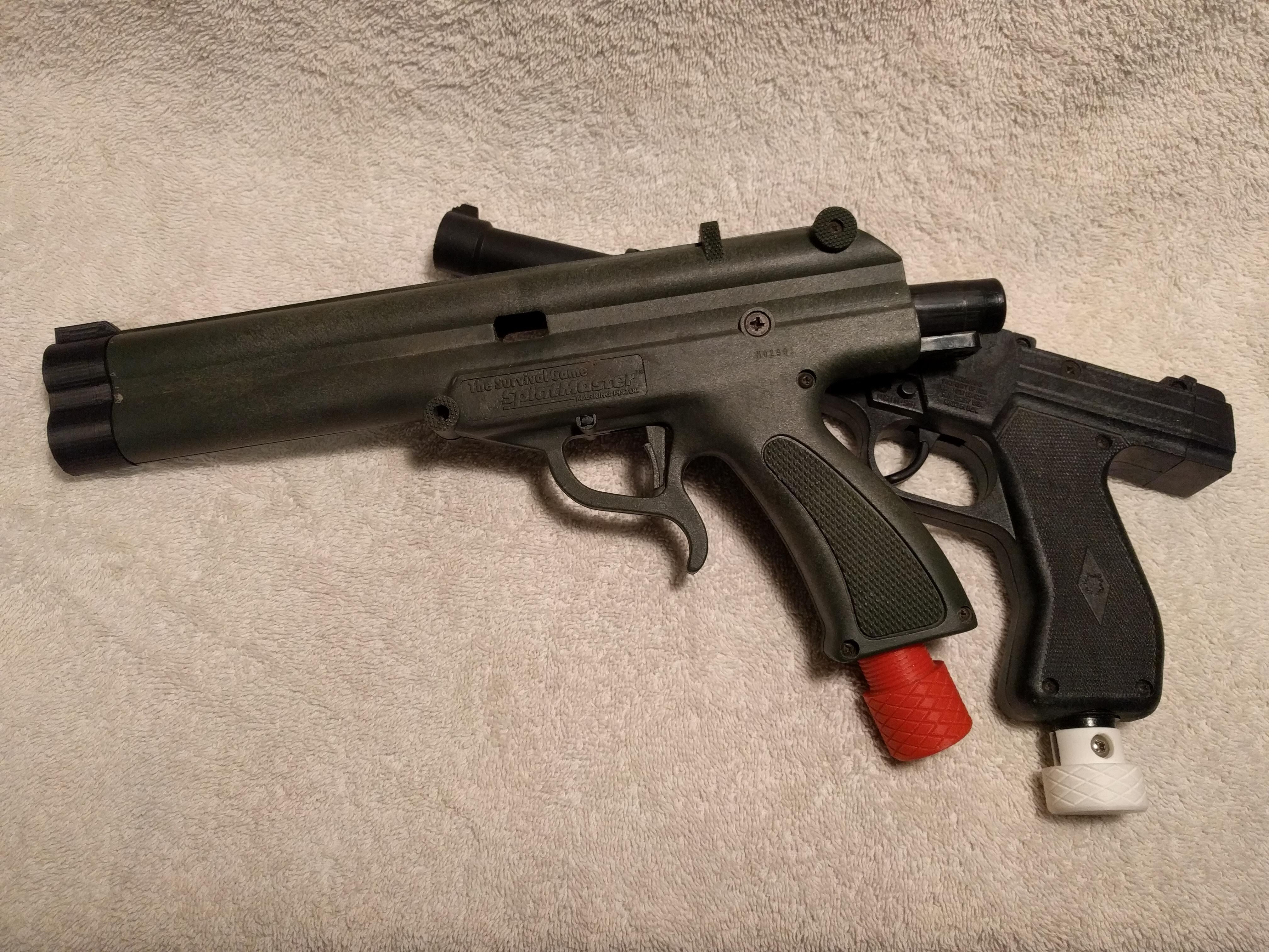

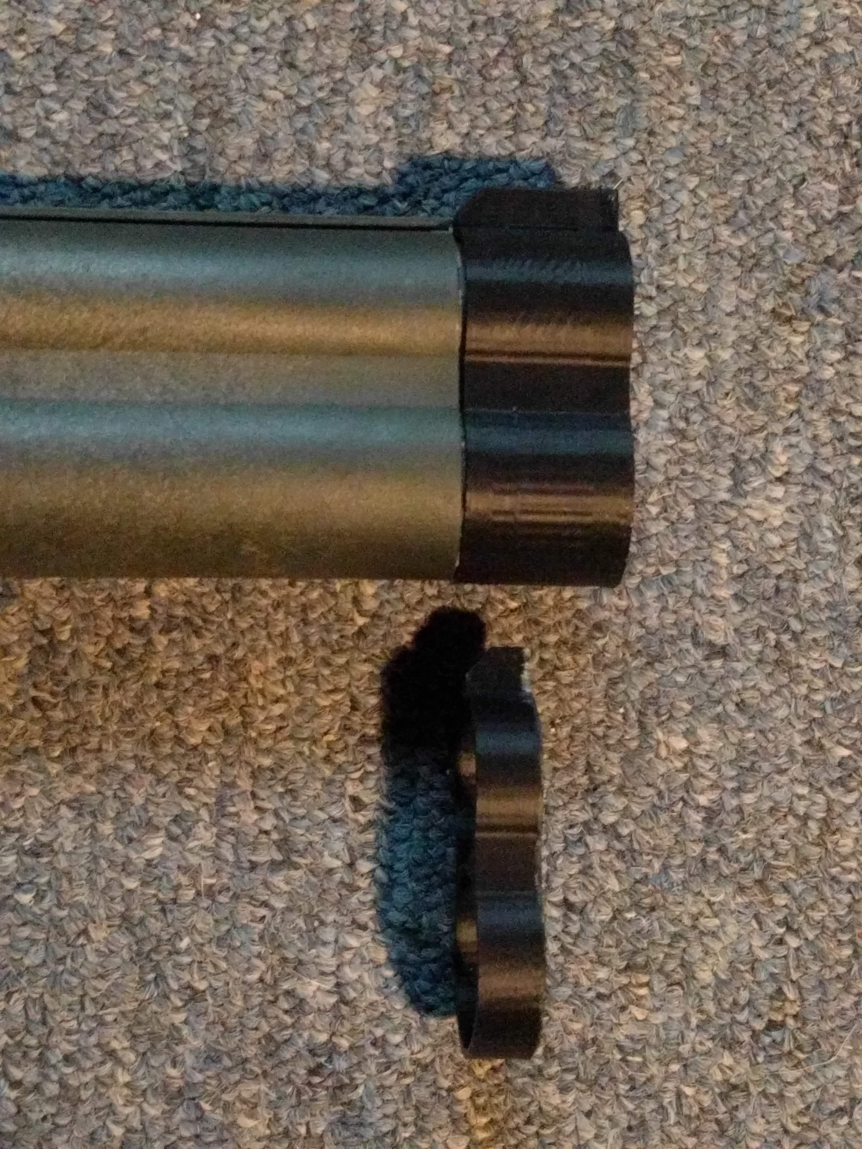

          I made those a while back, if there is interest i can make a few (when i have the CCI feed done (which should be in the next couple weeks ...))
          The standard figure 8 is a nice fit, the long one has a Tippmann detent so you don't have to shove the tube down the body.
          PS: looks like i was also working on one with a top rail (picatinny), but i never finished that ...

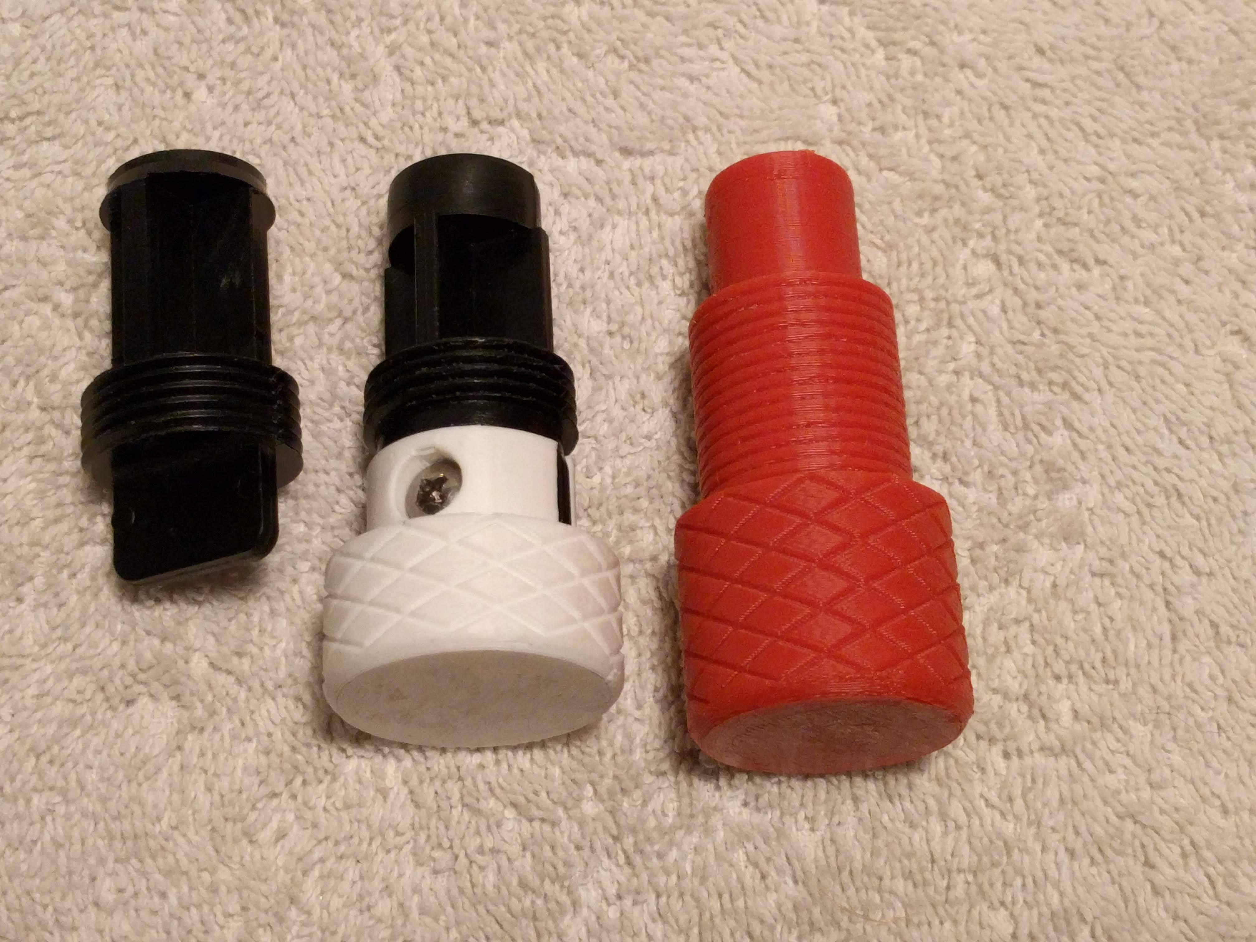

          Speed wheel with complete 3D printed plug (only fit the "regular"):

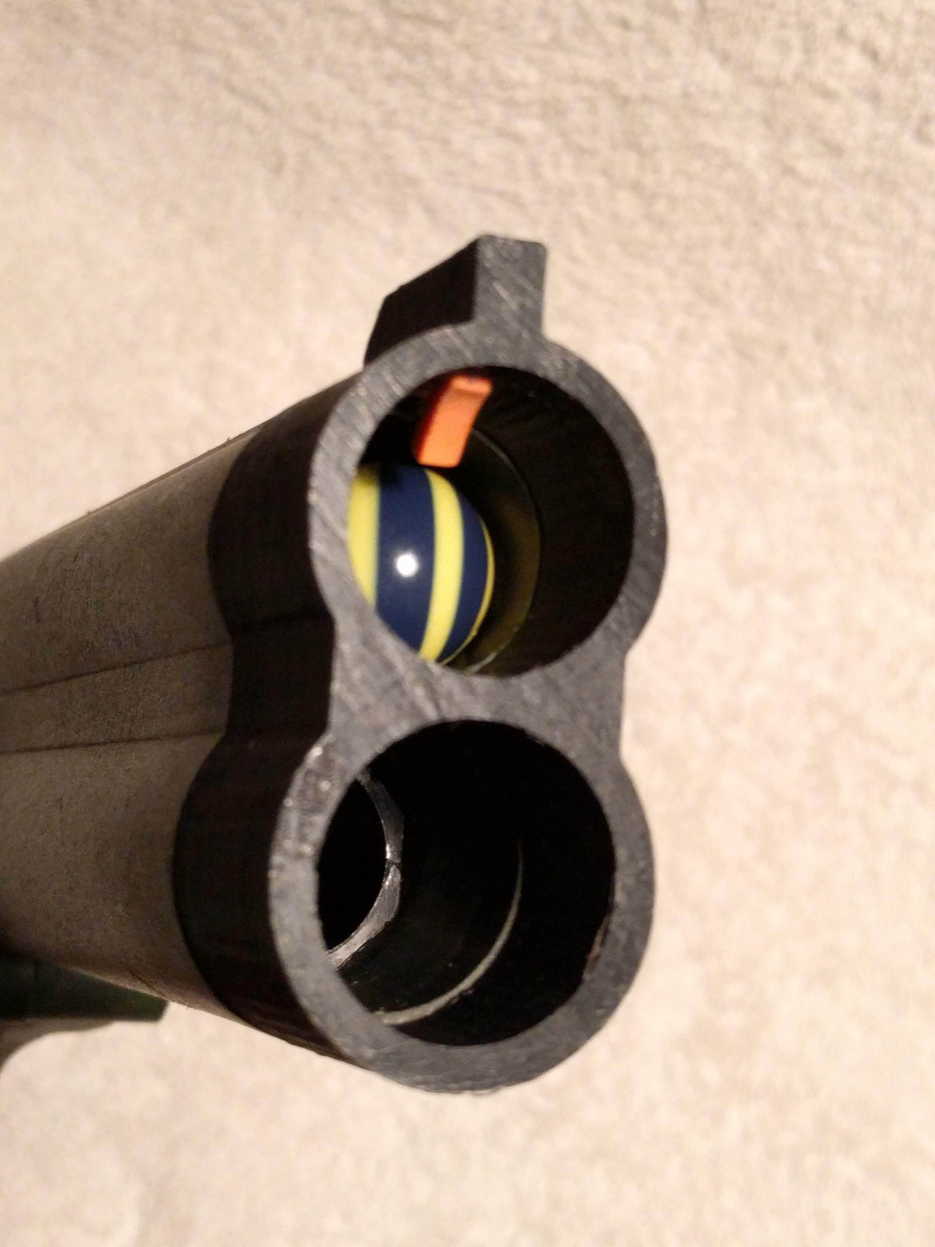

          Detent holding the paint:

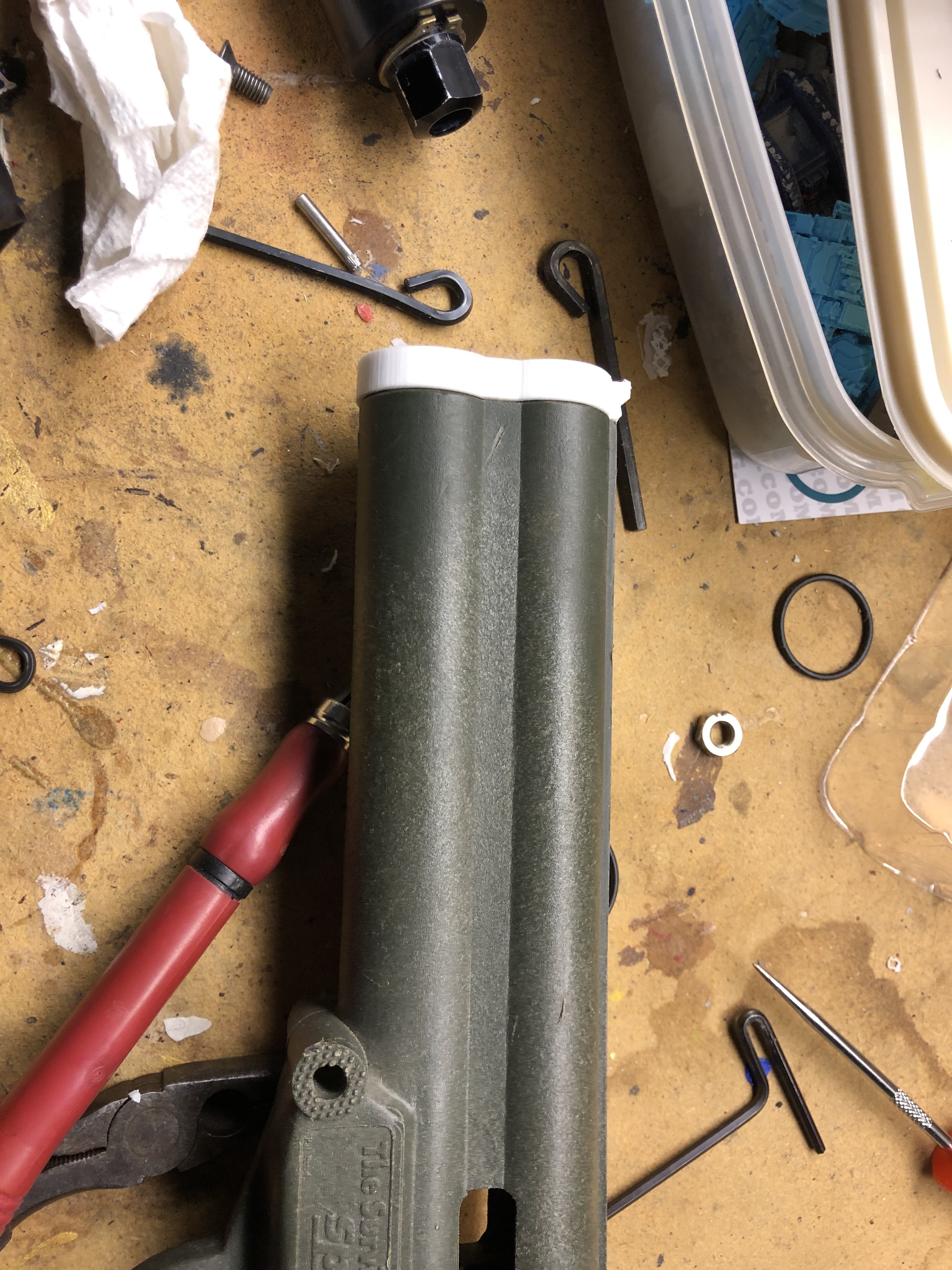

          Here's a file for the standard figure 8, no frills or detent or anything, just stock replacement piece.
          Splatmaster Figure 8
          • Raven911
            • Nov 2021
            • 431
            That worked great. Thank you!

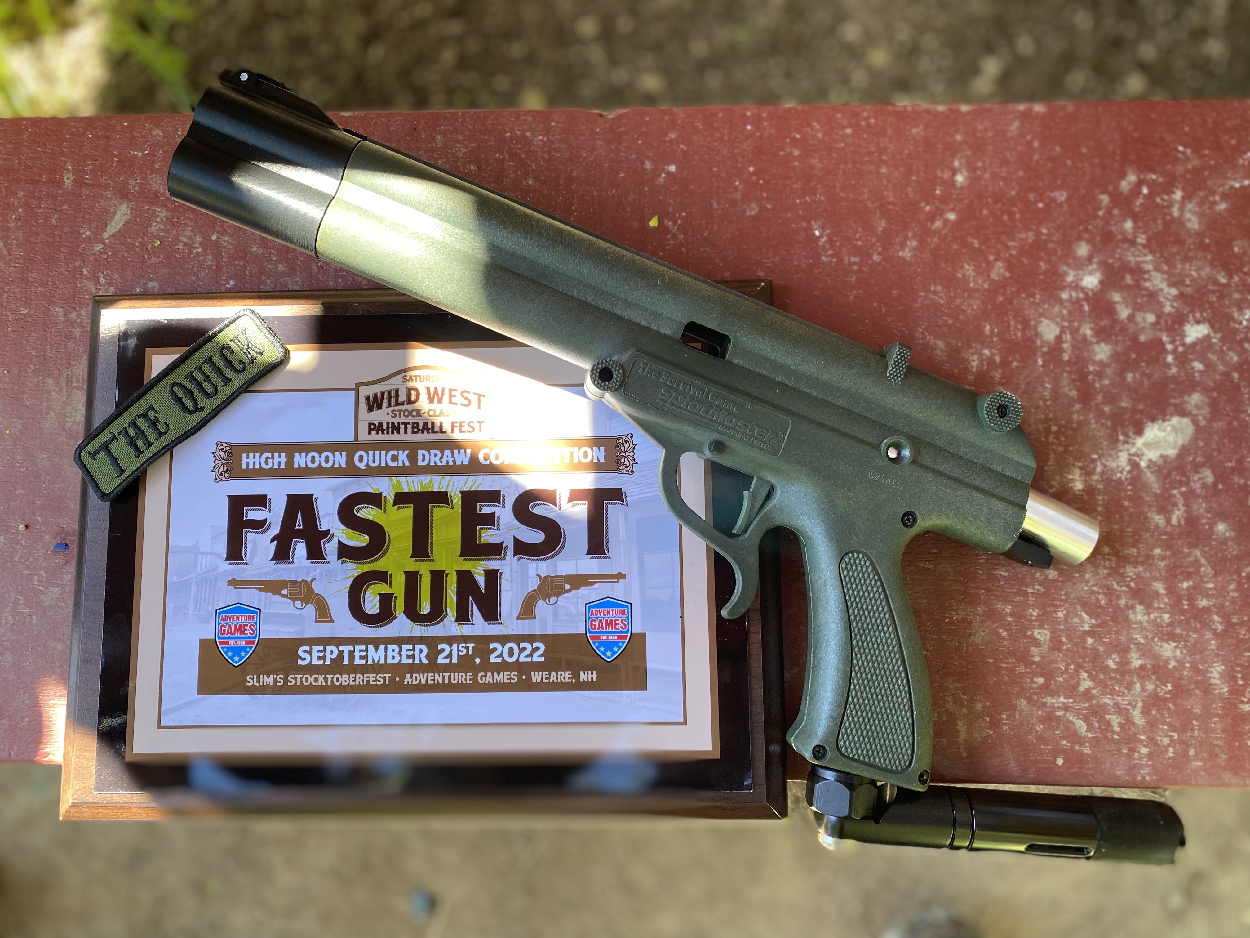

                Worked well for me…
                • ShaunFullerton
                  ShaunFullerton commented
                  I'm new to the NSG splatmaster scene. What and how did you get the bucket changer and what looks to be adjustable velocity on the marker? (Forgive my ignorance, I just ordered my nsg today)
                  MCB member KIT produced them. It replaces internals with all metal internals freak bore barrel and lighter springs and the bucket changer in the grip is Asa threaded. I put a palmers 90 on mine so I can use an ICD lever changer off the back.
