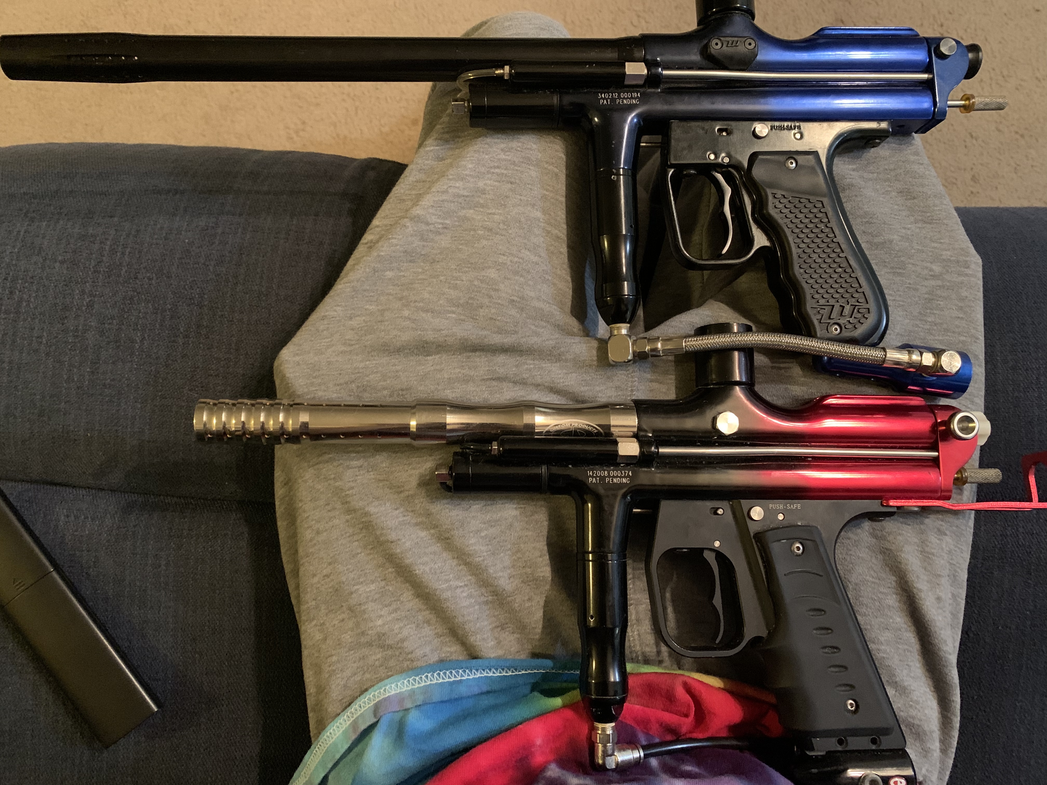

    How do i use this thing? Any info on setting it out of fast mode and into classic would be appreciated. Setting the bps cap would be my main concern right now though. Id also like to know how the eyes work (whats the point of eyes in a closed bolt?)
    also how do i release the hammer? Id like to store it not cocked.

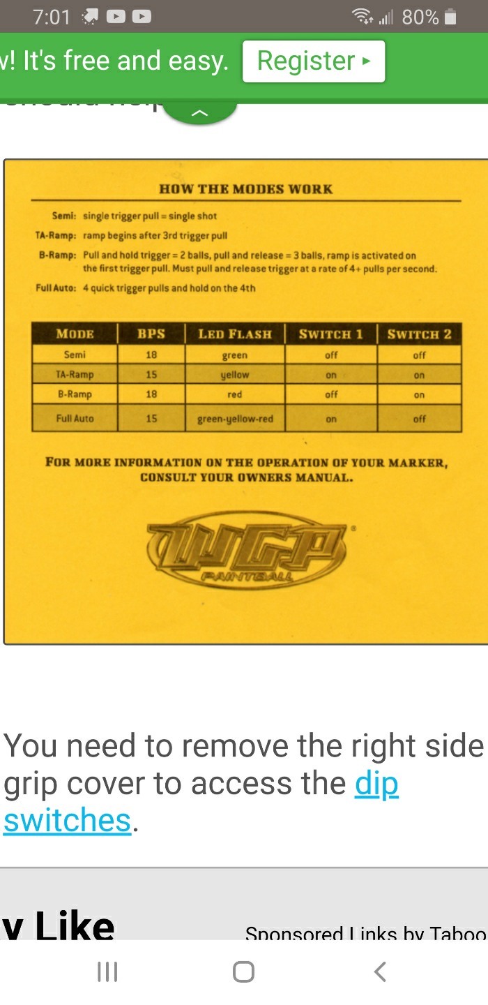

    Take the right side grip off - you'll see two dip switches
    Eyes turn on automatically on startup - you need to hold the button for a second or two to shut them off.
    ROF is not adjustable to my knowledge, just capped at a maximum. There is no "classic" mode like an Eblade.
