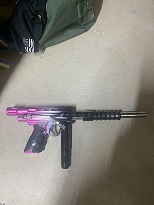

    Need help with the barrel threads. Any input is greatly appreciated

    All the Buzzards I have owned were Cocker threaded. But they tend to be semi-flat threads, so often new barrels would get stuck or be very hard to thread in.
    I had a Comp that was I think TASO threads. I sold it off and someone discovered an old CCM barrel (without the sizer) somehow fit on it.
      That was me. I cut oring detents into a CCM barrel without the barrel back. It worked really well.
  • Cunha
    • 2162
    That should be cocker threads. I read they often need a bevel turned into the barrel to let the bolt seat right or something.
    obviously all the external diameter stuff would need to match up to fit the pump handle and spring.
