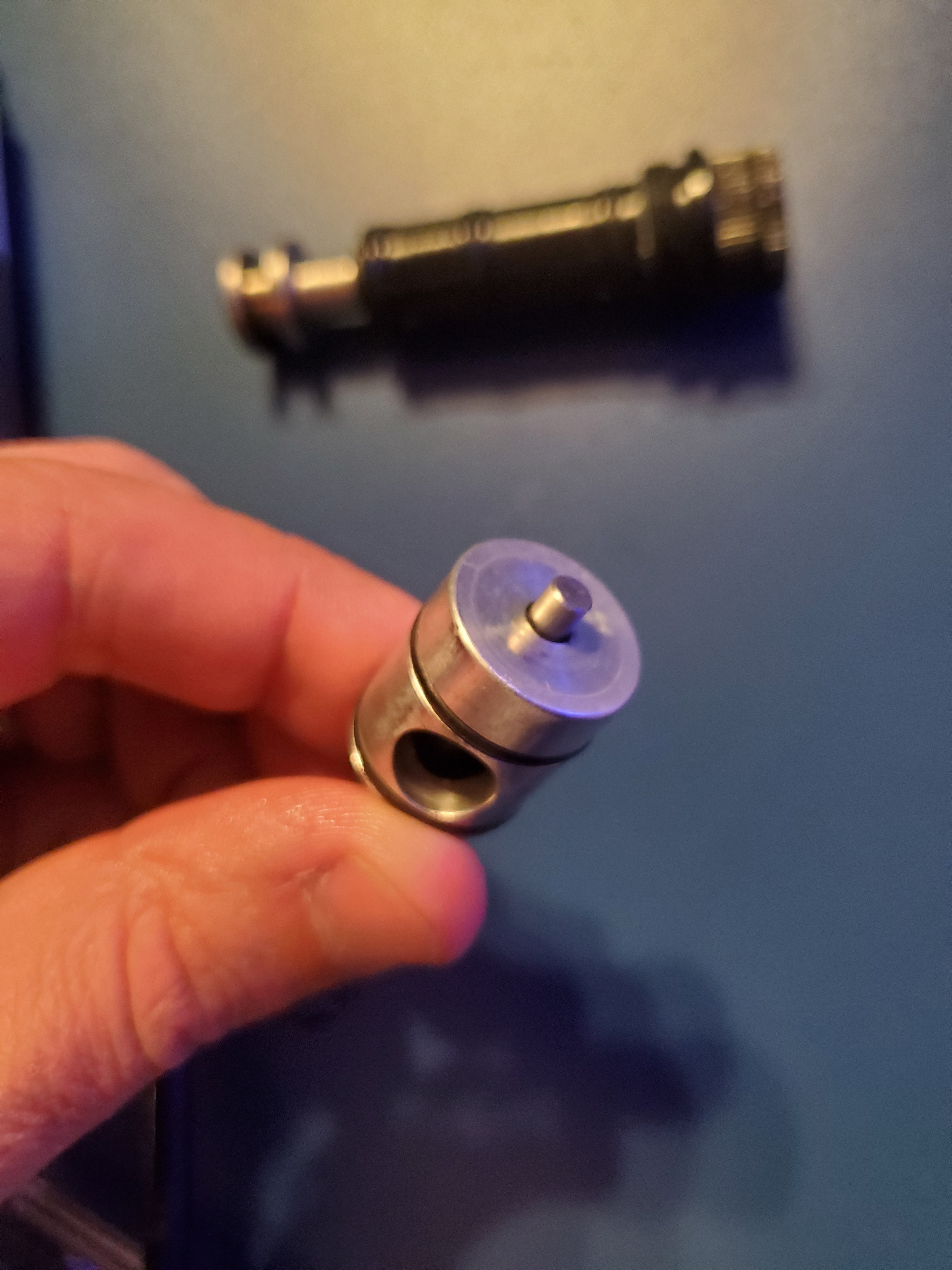

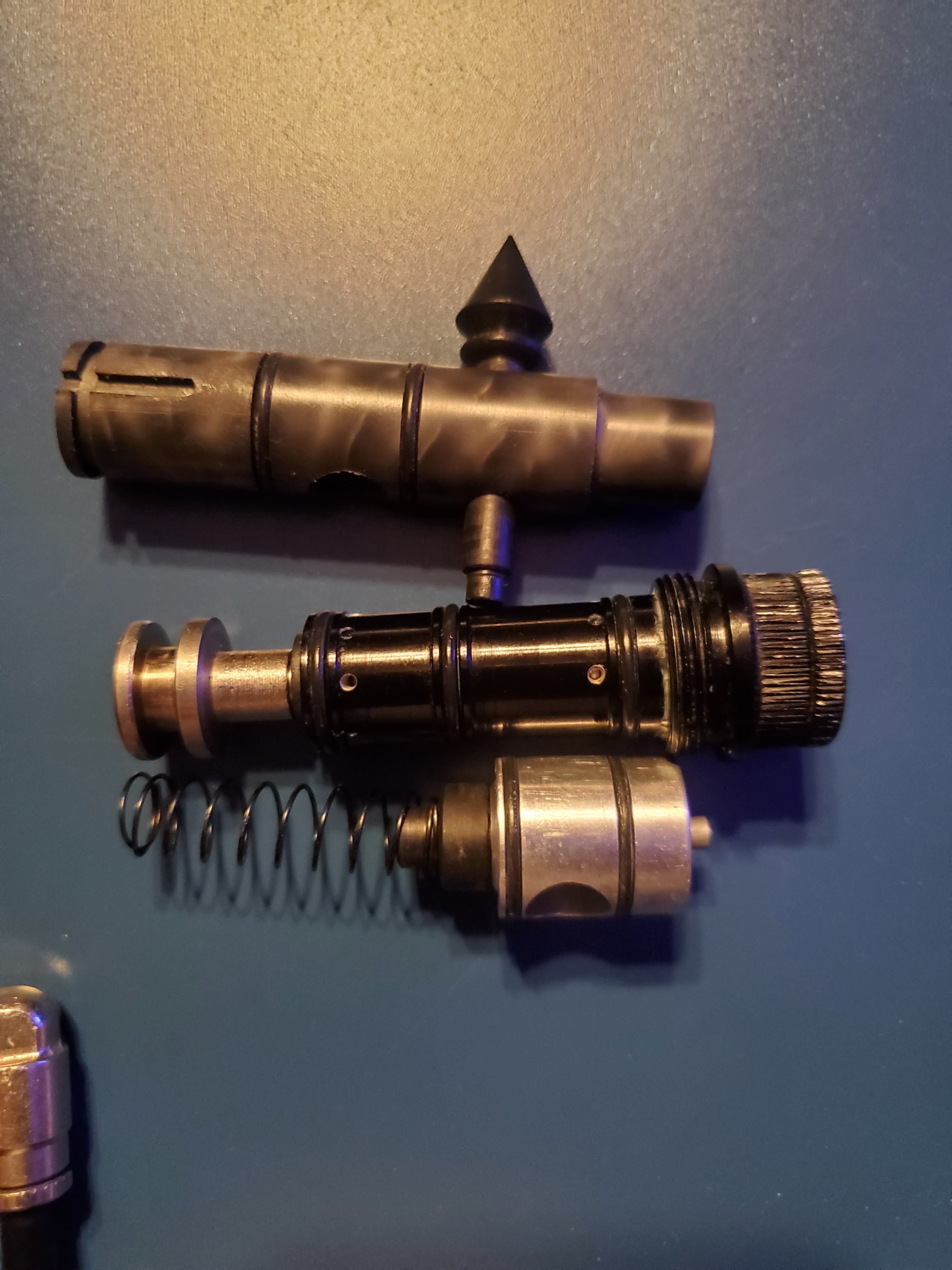

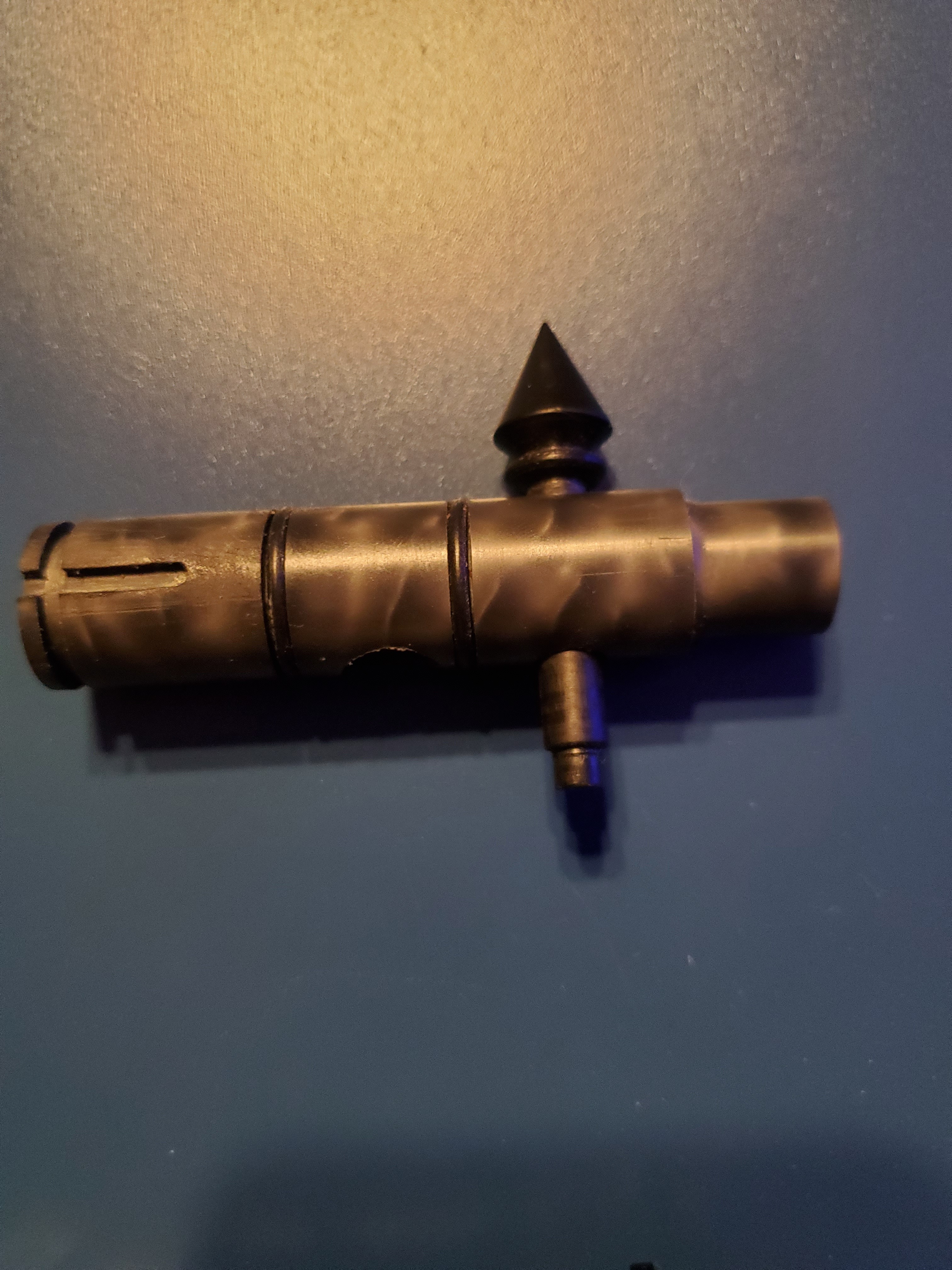

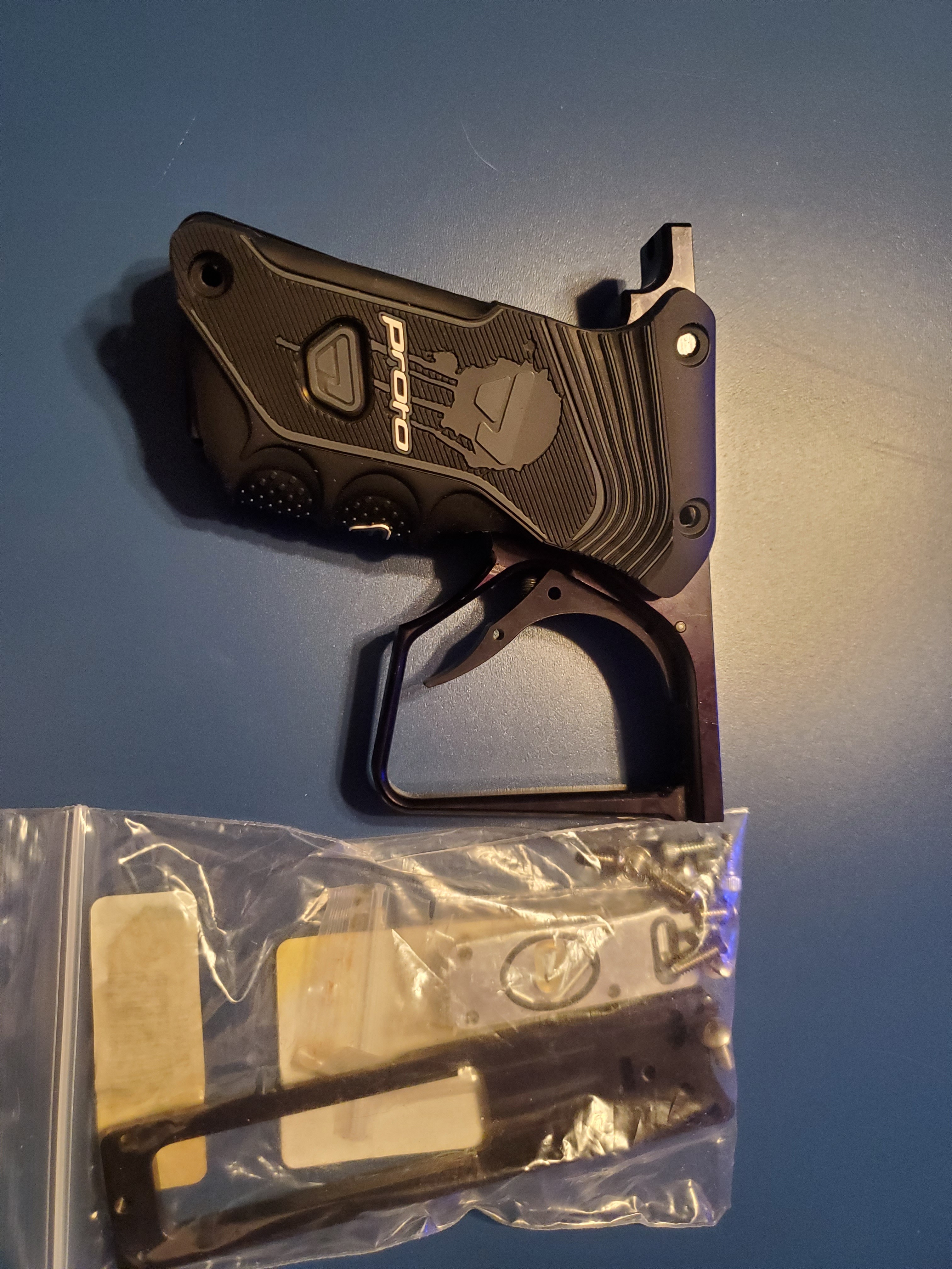

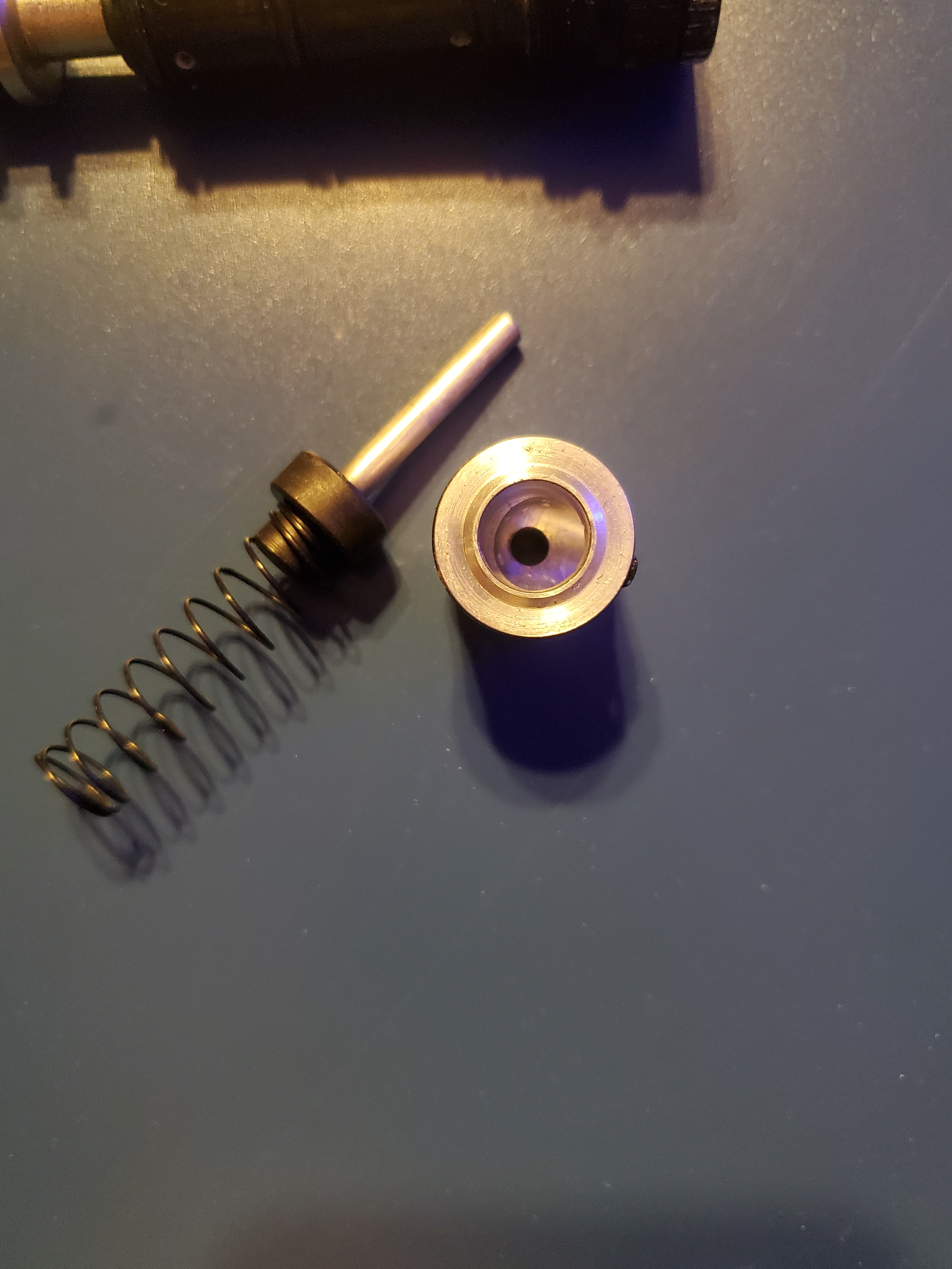

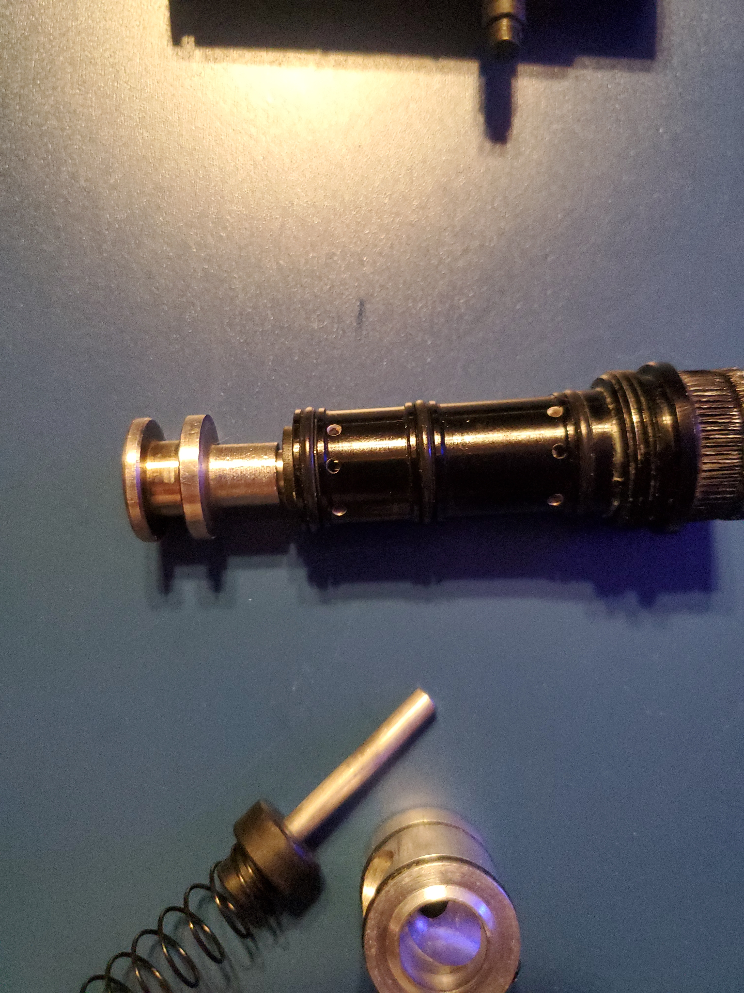

    Picked up a B2K with lots of upgrades. I can ID most of them but have a few questions. Also came with a trayless kit but I believe this one you have to swap to a different noid for it to work. Any clue what noid it needs?

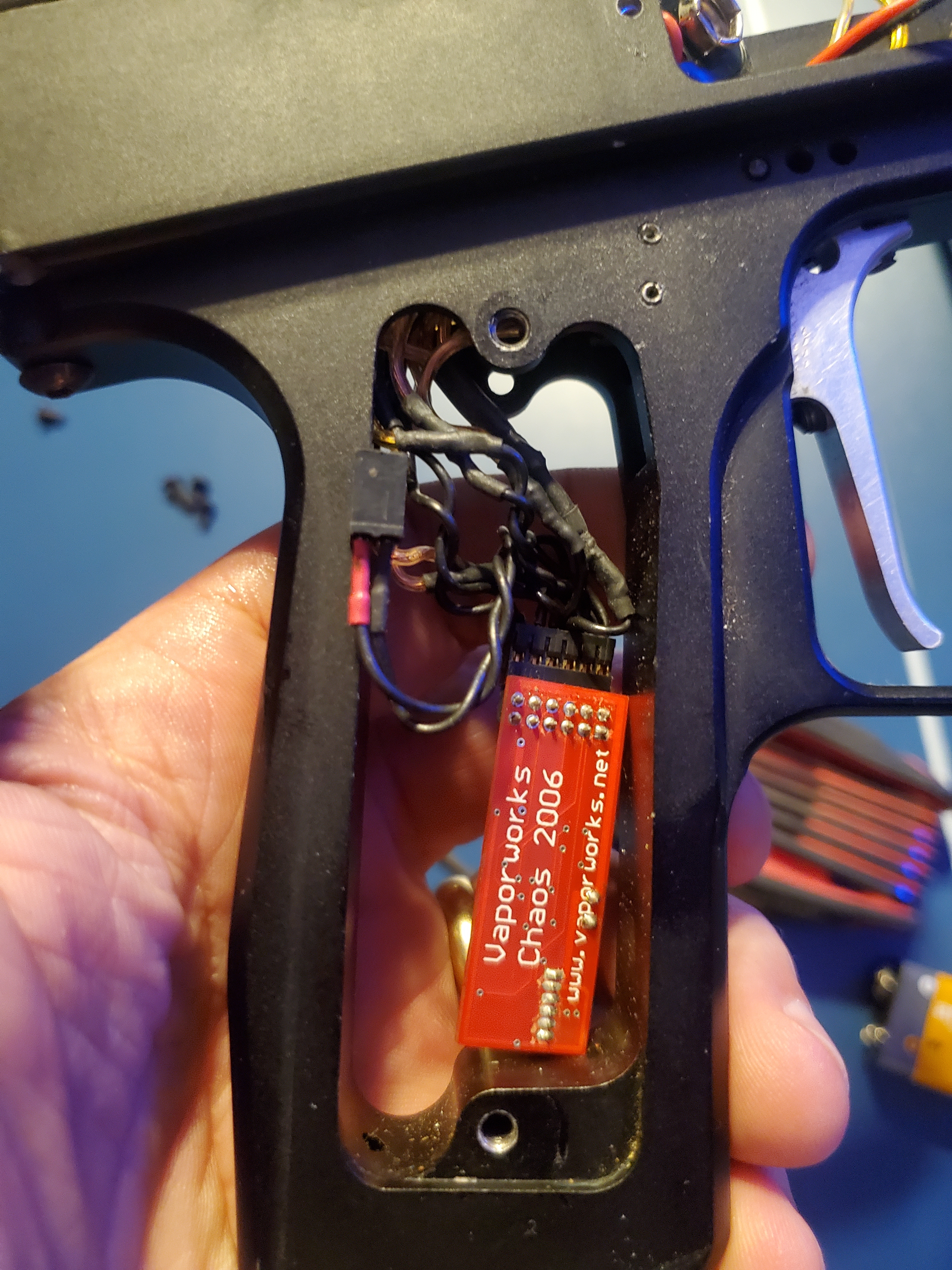

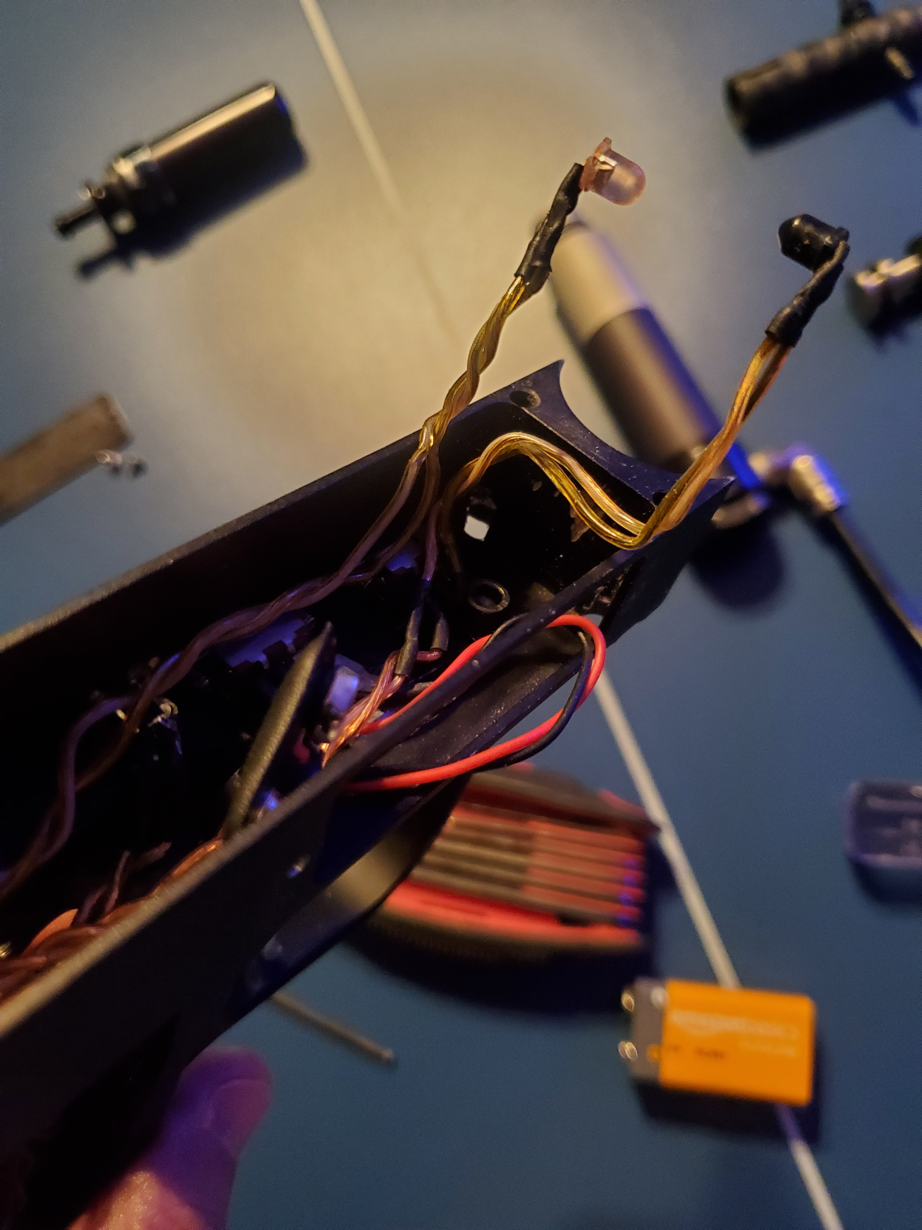

    Main questions on ID are the bolt, hammer/ram assembly and rhe valve. Also are the eyes and wiring harness original?

        I wanna say that bolt is a tantrum?
        As far as the T2 kit it should be a 2k2 style timmy solenoid. Basically the barbed version of the bushy Humphrey solenoid.

        So that T2 frame's manifold will be for a parker solenoid or a humphrey solenoid. Greg made manifolds for both because ICD used both, but the kit only came with one manifold. ICD started with parker solenoids and switched to humphrey around 2004. The T1 kit used the timmy style solenoids, but not this guy. The manifold in your picture looks different from the one I have with my T2, but mine is for parker solenoids. Yours might be for a humphrey, or it might be the wrong manifold for the frame kit. The T2 manifold might also be installed on the gun.
        The ram is a ported stock ram with a lightened hammer. The bolt and valve look like vapor parts.
        The harness is not stock and looks like it has been rebuilt/repaired many times.
        If you want more help figuring out your T2, let me know.

        vapor bolt and valve
