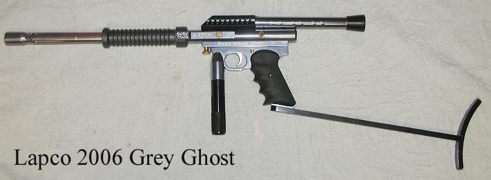

    Seeing a few Grey Ghosts, I think the color scheme with a phantom springpheed would look very slick, along with some black components to compliment. Problem I see is I have not observed a center feed body. Has it been done? To much effort? My knowledge of Lapco markers is zero.

    Original LAPCO? No, I don't think so. Later (IE, '06-ish?) Spyder-threaded bodies? Yes, I think so.
    Open to correction, though.

      If you are interested in Old School LAPCO Grey Ghosts then the answer, as Doc stated, is an emphatic no on center feed. Almost all were Right Feed though I have heard, but not seen, a Left Feed Grey Ghost. IIRC all of the 2006 and later Ghosts were center feed stock class that will take CCI parts.

      The 2006 ghost has phantom mount and another hole for a hopper adapter also.
      however you can’t use phantom feeds without neglecting the spyder nubbin ball retainer that makes you not need to bore match .
      you could just tape it up though or ignore the hole
