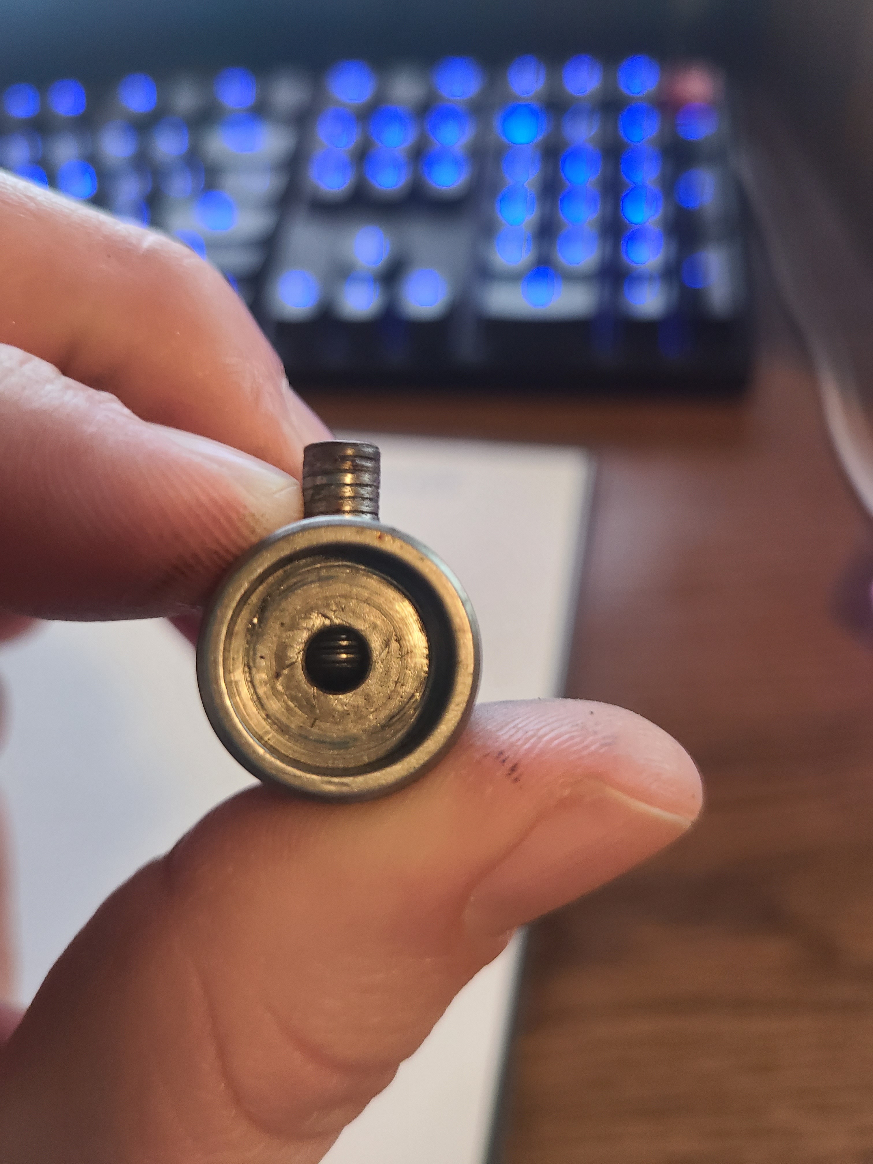

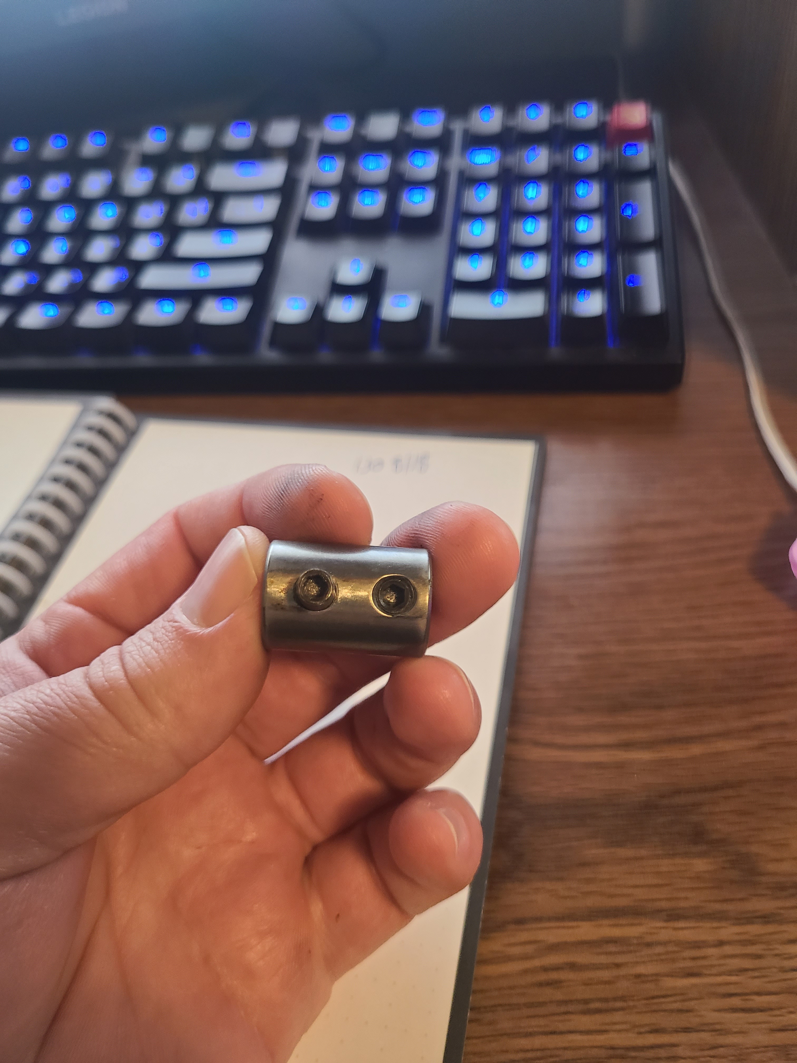

    I have a Micrococker build I am working on. I have just about everything ready, except for the hammer. I do have several backblocks I could use, but they don't color match. So I could use a sled and bolt, either option works for me at this point. Problem is I have never seen a Micrococker hammer. Can someone send me pics of what I need? Any info would be great.
    From what glimpses of installed hammers (youtube videos) it looks similar to a normal hammer with a allen screw threaded into it. Could I have a local machinist tap a hammer for a Allen screw?
    If anyone has one to sell, please pm me!
    Also, if anyone happens to have a matching barrel, frame, front block, backblock, please let me know!

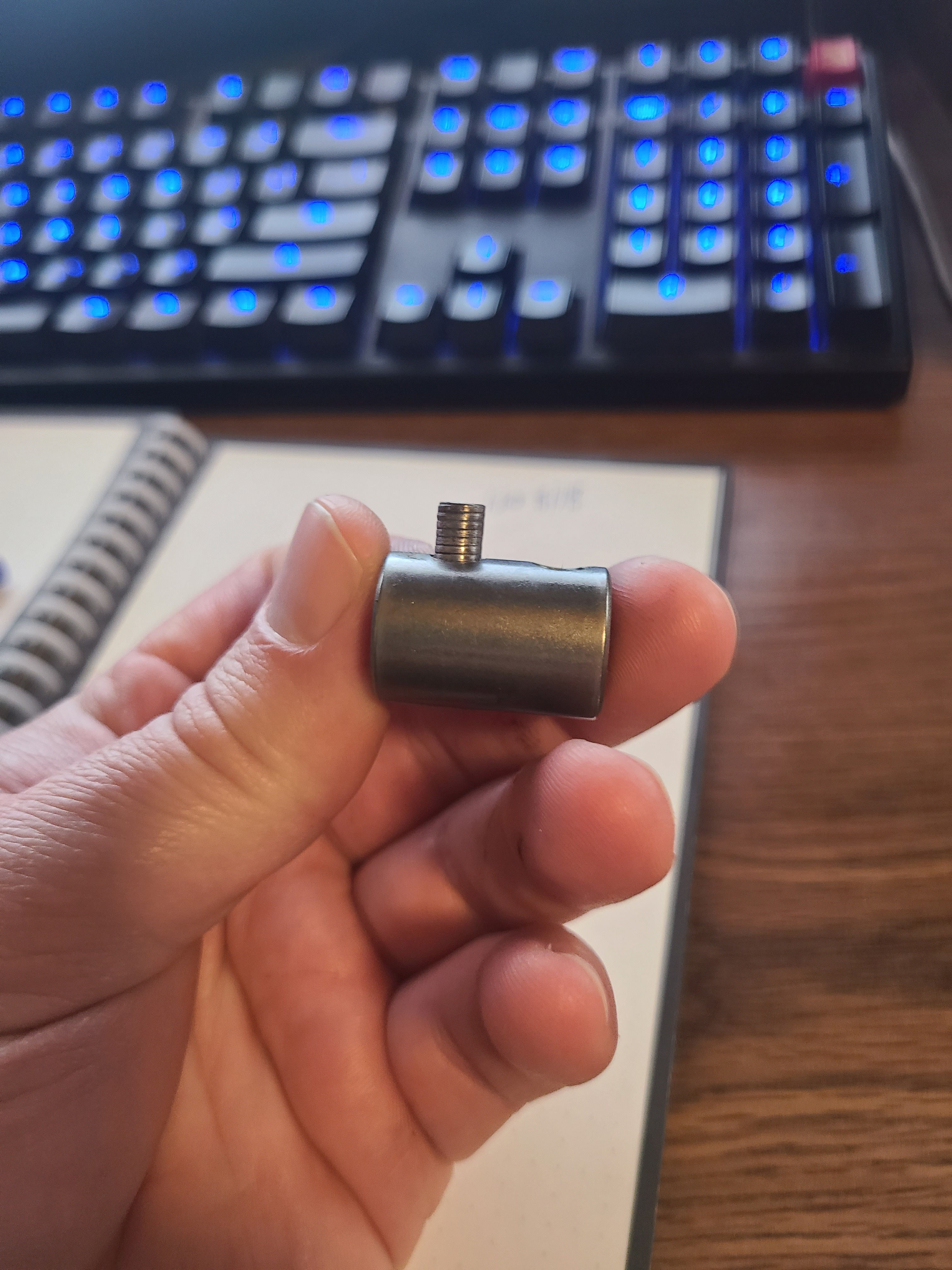

    I got you, I'm uploading photos from my phone as I type.
    • blitz121
      Pocket full of Sunshine
      • 42
      Mine is a little different from others. Doesn't have a PTP detent but should help some at least.

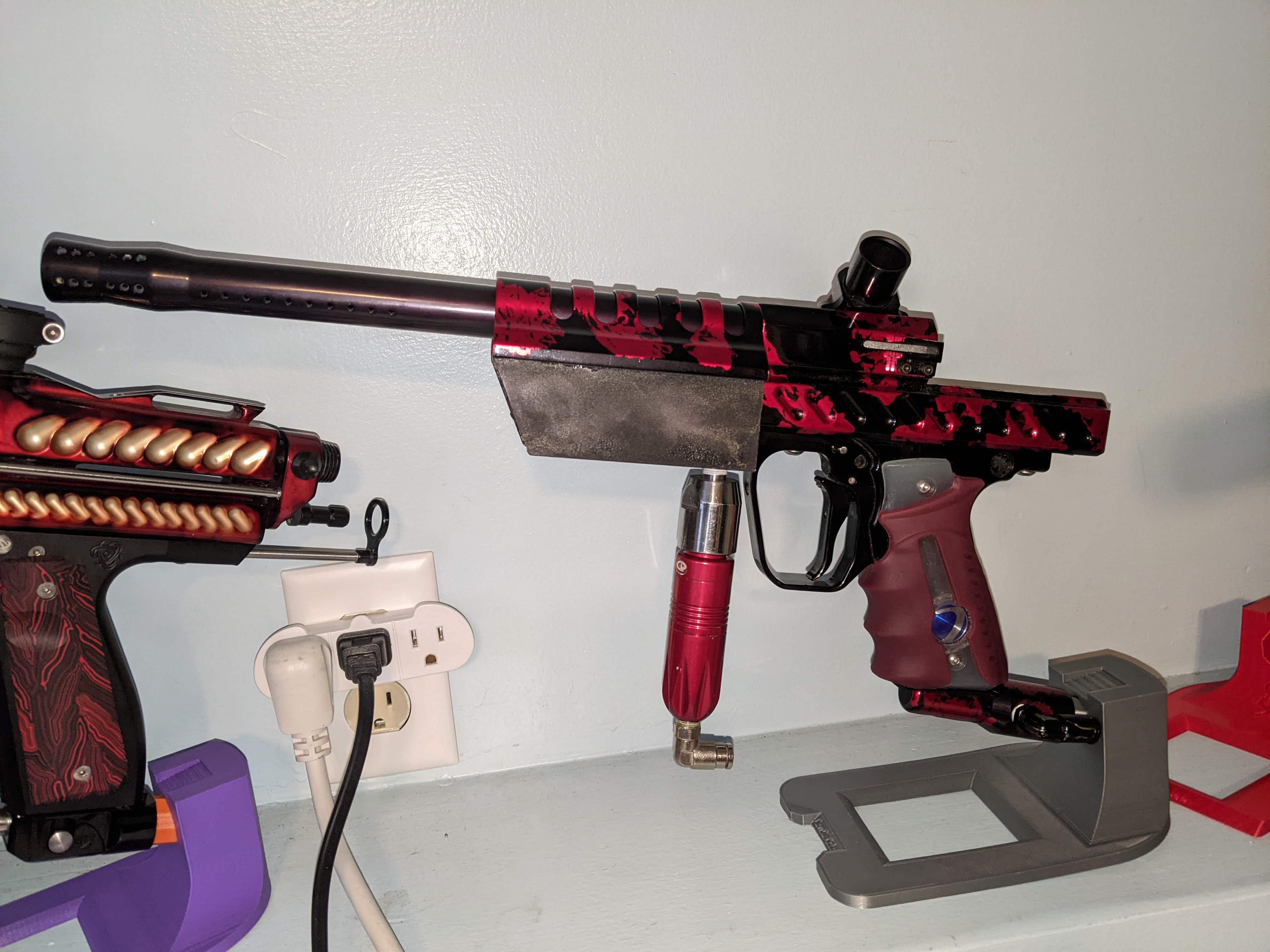

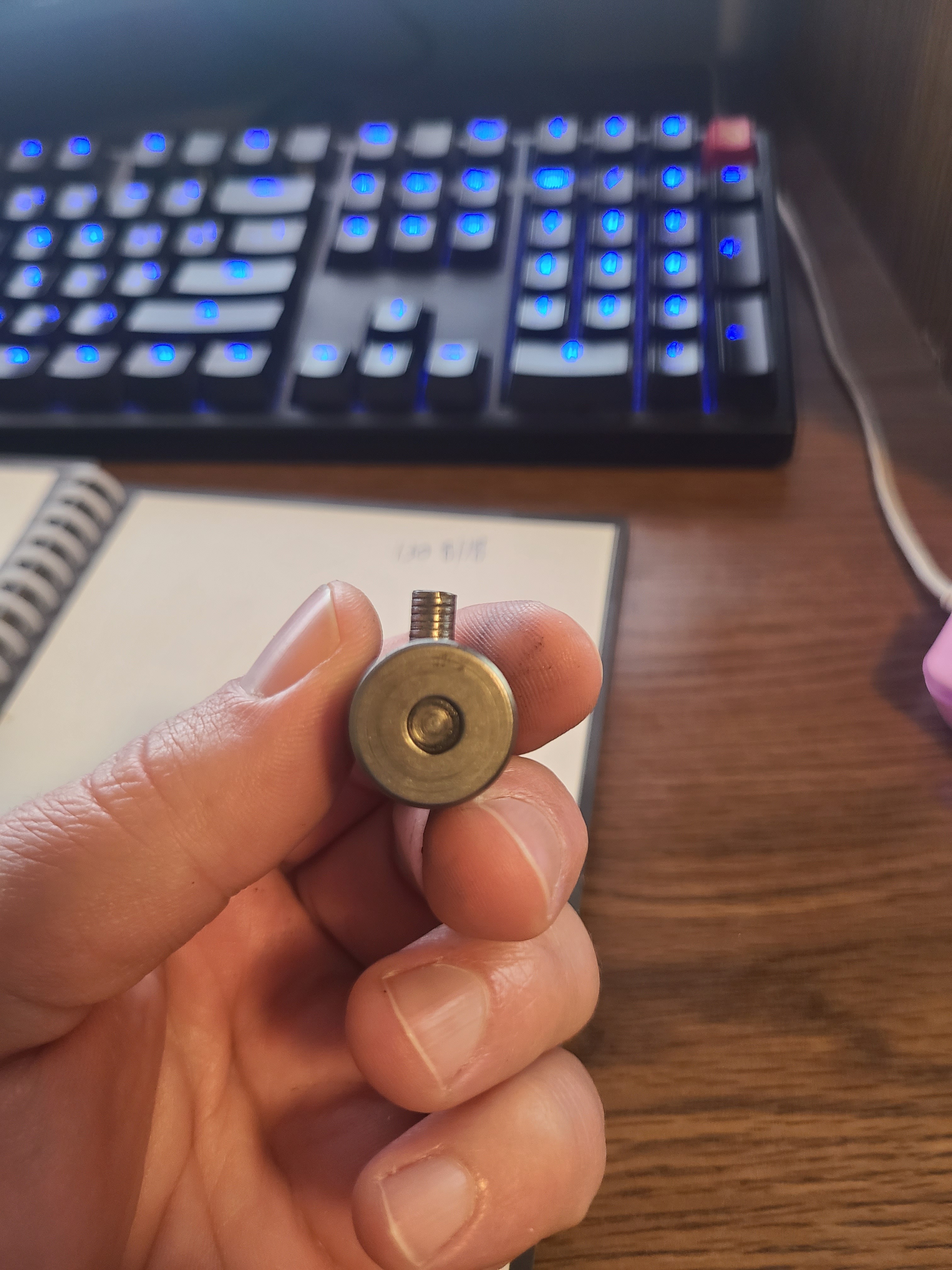

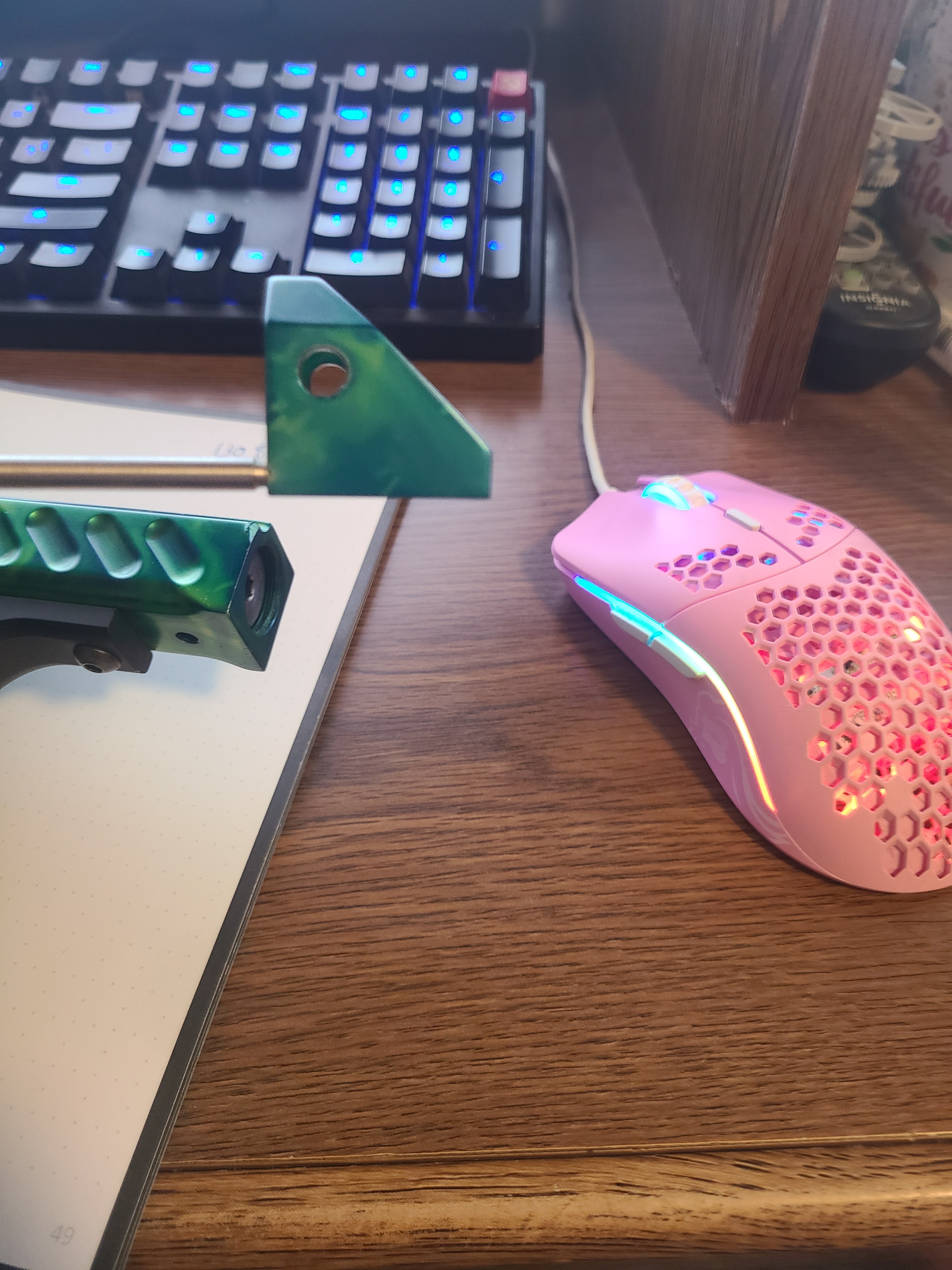

      Just some additional I took for reference

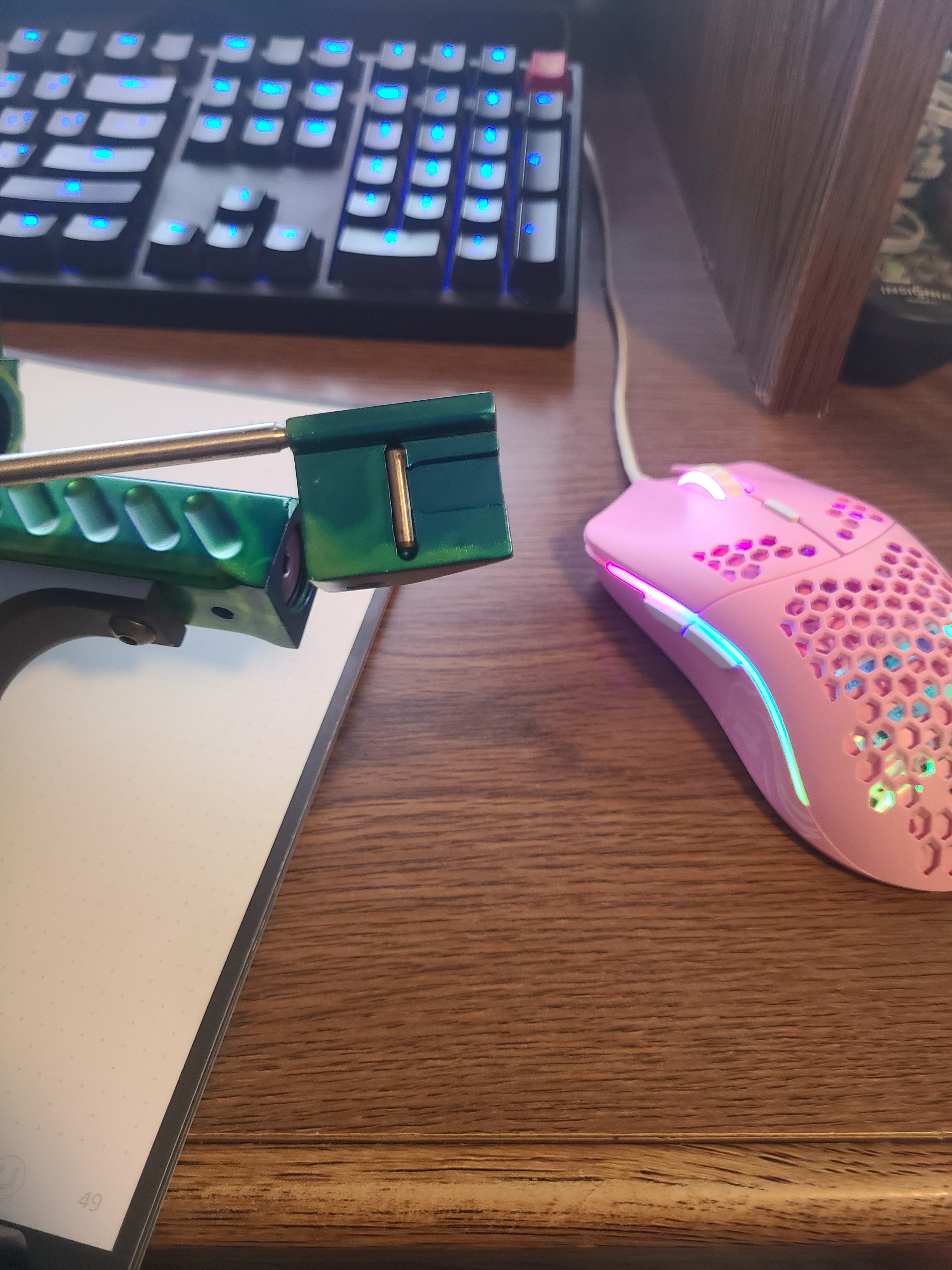

        blitz121 Thank you, that is just what I needed! I assume that Stainless rod in the back block is what I am looking for as well! I'll have to reach out to BMC and see if he can do something like that as well.
        Also, the stainless rod on the body that the back block slides on, does that just lay in there, or is that attached somehow? I need one of those as well.
        Is that marker from PTP? I know Air Soldier made Micromags with cocker detents, did they also make a Micrococker?
        Thanks again for the info!!!

          You know I'm not 100% sure, it looks like both might possibly be glued in. gravity doesn't push them out but I'm scared to mess with it.
          From what I know its a PTP but I could be wrong. Sorry I'm not sure on much, I just bought it from someone of here many moons ago.

        I think i might have a hammer with two holes in it
        • shooter311
          shooter311 commented
          Awesome, that would save me some work! Pming!

        First time I've seen the stainless piece in the backblock, very smart. Note that this owner did what everyone with a micrococker should do - at least grind down the extra threads on the lug in the hammer. That alone will prevent a lot of wear.

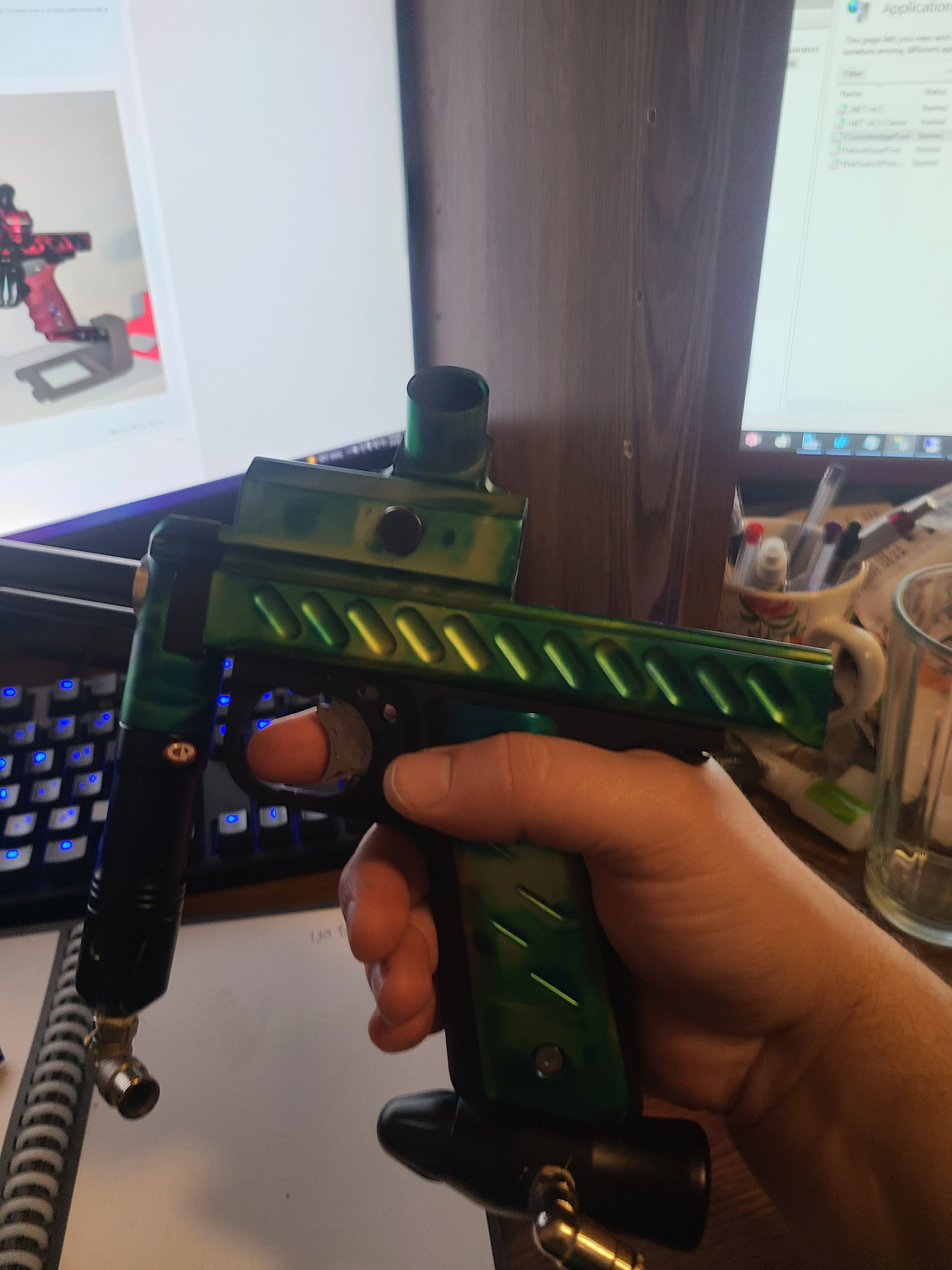

          Ah ok mines not like that. But if you PM Chris Fosnacht on Facebook he can make you one custom
