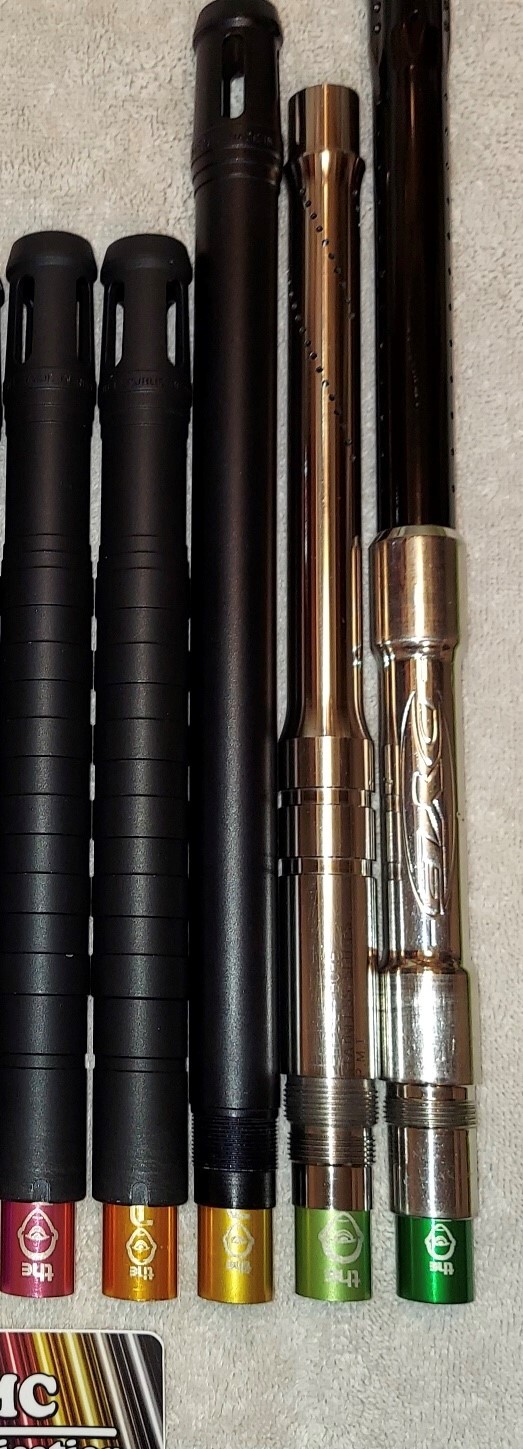

            Just depends on the barrel. Brandon at BMC was able to bore and rethread this Spyder PMI SS barrel into AC threads for me. But as you can see he had to go above the old threads where the barrel was thicker and beacuse of that the barrel is also slightly shorter now. That barrel has a pretty large O.D. though.
