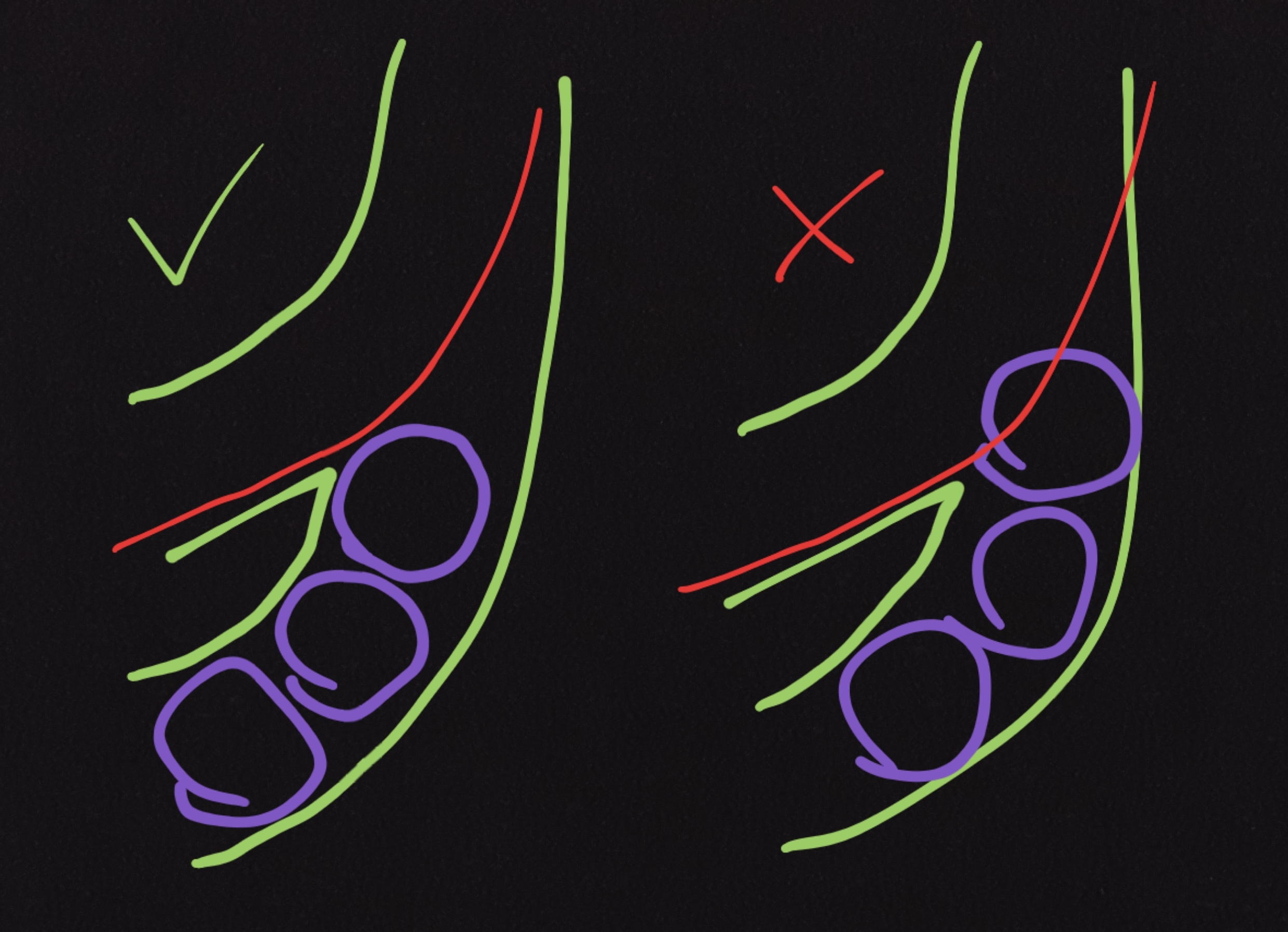

              Here is the screenshot of the feed discussion that I had saved from the desertT1 “Double barrel feed options....” thread. I tried to re-find a copy of the thread on Wayback Machine, but I don’t know how to work the search properly. Maybe someone else can try to resurrect it.
              I am also interested in pursuing a (small) single hopper solution for my double barrel Phoenix Phantom(s)....for science, and would love to collaborate. I have every feed option, but none of the Hopper fed options appeal to me...AT ALL.
              I can’t find the pictures, but I got playing with the idea of swapping the left and right Stock Class feed bodies, so the feed hole is tilted in towards the center, and it looks like it could work. It could result in an absolute minimum size feedneck, with the majority of the sight picture being similar to that of a normal center feed hopper setup.
              At that angle, There is no space for each body to have a ball positioned above the bolt at the same time for both to drop at once when pumped, so one would be sitting on the bolt, and the other would be above it in the stack. I don’t think a static divider could be counted on to successfully have the second ball choose the correct path consistently.
              I DO think a moving divider actuated by the pump stroke could very well work though!
              There is enough space between the barrels that a 3d printed link could connect the pump handle or rod to a rod above the centerline of the barrels to actuate the feedneck.
              That is the way I planned to tackle it...”eventually”, so if I can help/participate in any way, it will help me move along also.

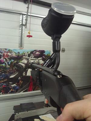

                        When I made my over-under Trracer, also made a hopper adapter. It worked fine. I had carefully measured the ball stacks and it fed well without jams, but it was also very tall and I preferred running 10rd tubes with it in the end.

                          Cool "traccer", where do you have the 10round tubes?
                          Any advice on what to measure? I assume make sure the y is in between the ball in the stack?

                              Something like that, it's been a long time... When the bottom stack is "full" to the Y, there should still be room for balls to tip into the other channel. I might've been overthinking it, but I never had a jam either.
                              But tubes were just cooler, and lightened up a very bulky, forward heavy package.
