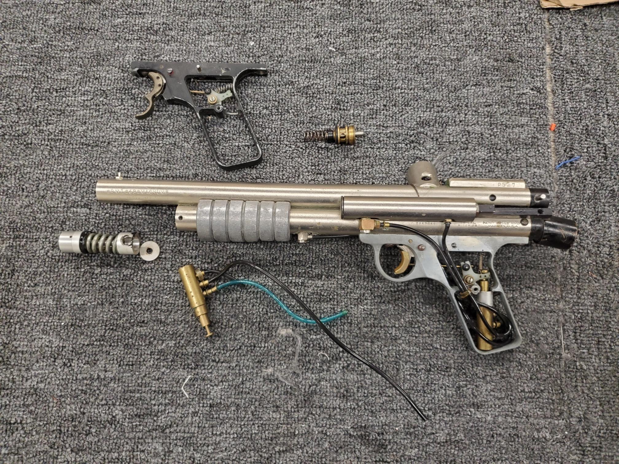

              I just finished a pirate PGP for Alexndl, and was able to use the stock hammer with a modified (cut shorter and rewelded) KP trigger.
              I can grab a picture of how a Hurricane setup looks later, if you guys want one... I'll pop mine out of the stock.

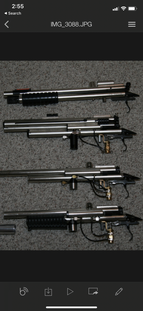

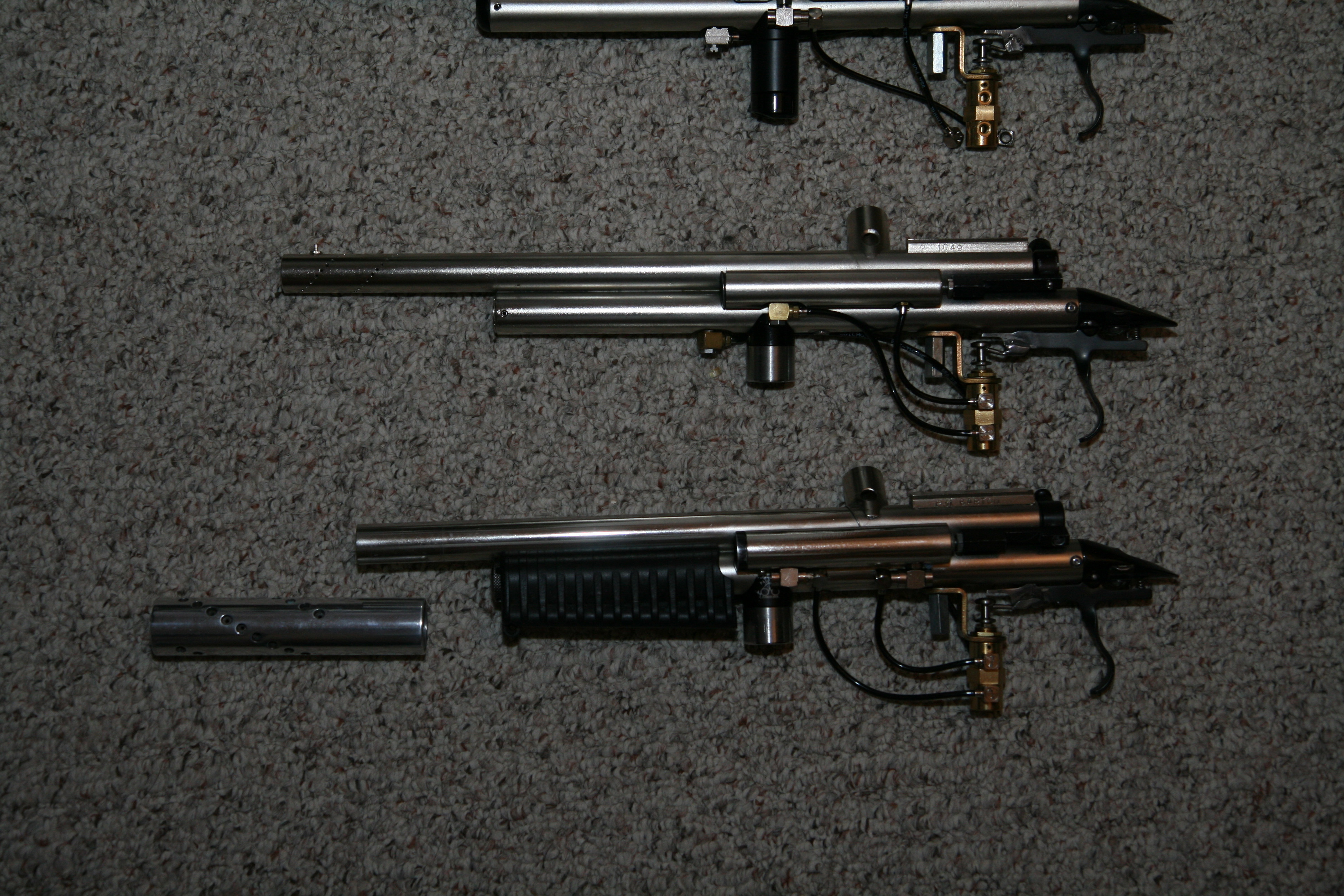

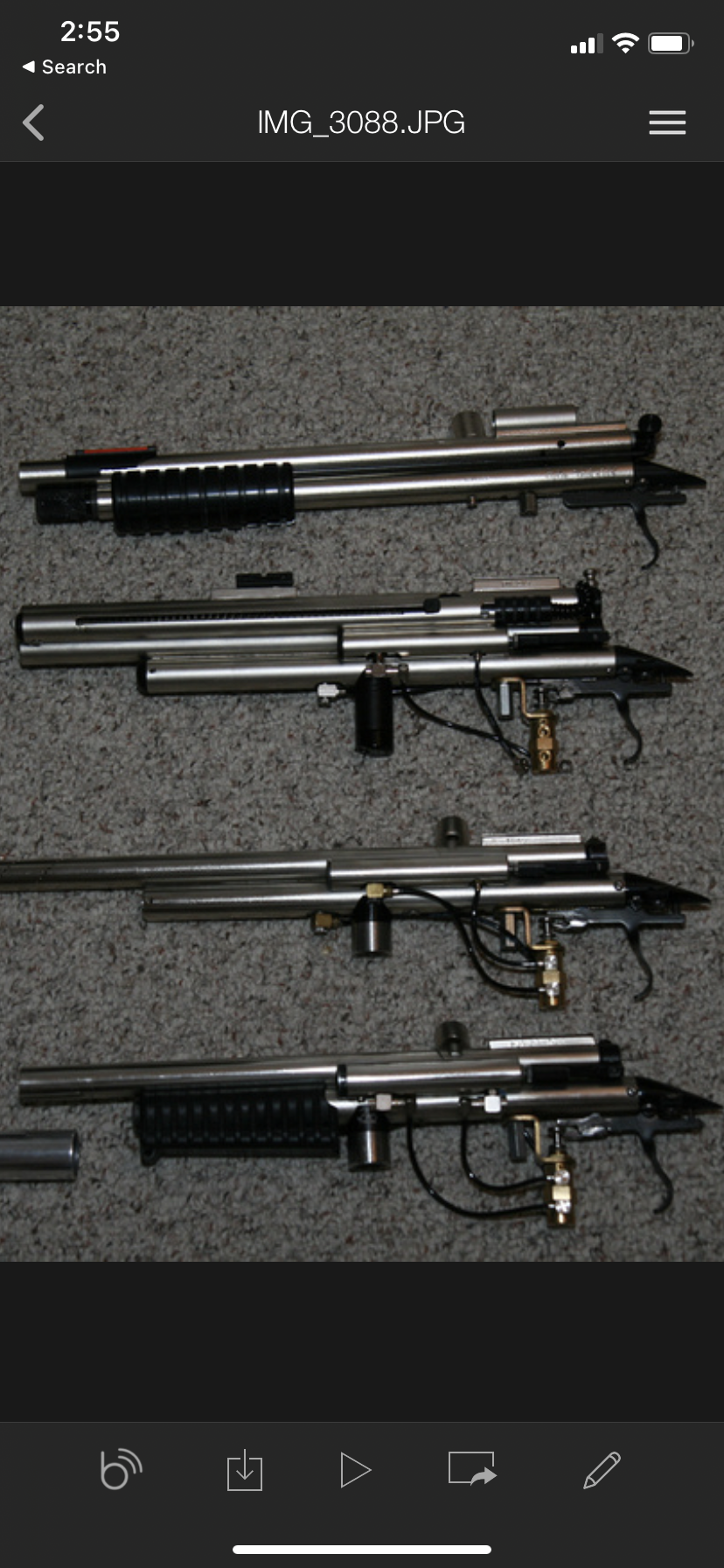

              • jeramiej
                • 222
                Phooncanes, bottom two. 2nd was a o/u nasty hurcClick image for larger version  Name:	91729B45-B9E5-46BD-B1B3-470247148C0A.png Views:	0 Size:	3.69 MB ID:	231209 I had PPS do many moons ago
                Click image for larger version  Name:	22001CA8-1300-446B-9DC8-F0E3CD2A5FEC.jpeg Views:	0 Size:	2.27 MB ID:	231213

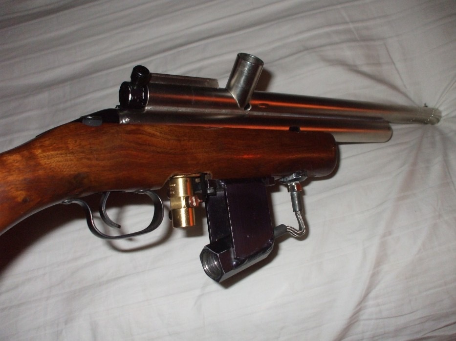

                stock modifications for the pneumatics
                Click image for larger version  Name:	95B7E036-7168-4682-BC68-907FEFCDB0AF.jpeg Views:	0 Size:	112.3 KB ID:	231212
