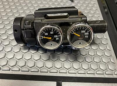

    Reason I ask, is that I just won an old-school in line Max Flo on ebay. It is just a bare regulator right now.
    Id like to put a tank on it, but dont know if this is something I can do, then take it to be tested. Or if this should be brought to someone to do it "correctly".

    This is the pic from eBay. Not sure what burst disk is in it. I was thinking its a 4,500 due to the right gauge, but I could be wrong. Ill double-check either way.

    I don't think those inline maxflows were made in 3k so it should be 4.5k.
