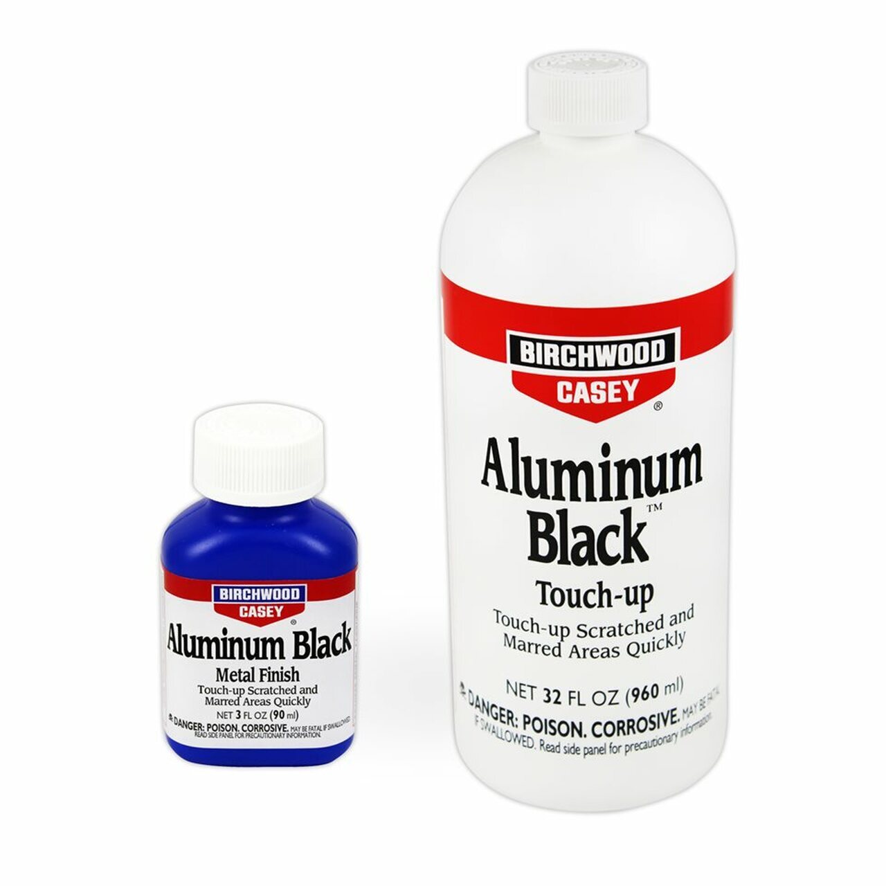

    Hello MCB,
    any one has experience using "aluminium black" for small parts?
    I'm talking about this stuff:
    Thanks,

    I use it all the time for my metalworking projects. For me, its main use is to make aluminum look like steel. You can lightly dip it a few times and then sand or steel wool it to get a steel like finish.
    That little bottle goes a long way. Don't let parts sit in the solution too long or it will leave a corroded porous finish on the parts.

      Its designed to cover scratches, and it works way better than a sharpie marker. As long as you don't expect it to look like factory anodizing from close up, it's great.
      I used it a lot when I recrowned barrels, anything with a larger surface area than that looked like an obvious cover up. I never really thought of using it like Netsurfers pic above, I'm not that creative.

        Thanks guys, that's good enough for me to give it a go and see how it turns out 👍

          I use this regularly to touch up stuff for resale, have for years. Apply with q-tip, let it sit 30sec, work it in more, sit 30sec, wipe off. Open a window & protect skin. I don't have this container specifically, I have a sample bottle from some large supplier.
          Far from perfect coverage results in isolation but, fantastic as a quick permanent touchup to get scratches from "OMG the shiny silver scratches" to "if you look up close there's damage".
          Scratches & barrel tips is really where it's at.
          Unfinished surfaces, don't bother unless you're going for a patina look.
