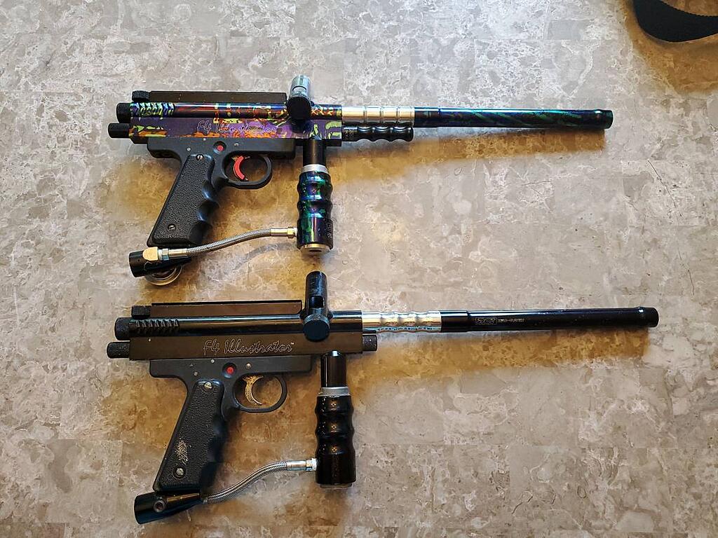

          Here's a pic of them.

                  Well, I picked up both the F4's yesterday, and of course there's good and bad! They were kept loose in an ancient rubbermaid container, along with old loaders and tanks, in this guy's garage and hadn't been used in about twenty years or more. However, they were in remarkably good cosmetic condition, especially the ano'd one, despite being caked internally with old paint, dirt, and disintegrating orings. Neither would actually dry fire correctly when I cocked the bolt via the charging handle, but the ano'd one did at least lock the bolt back. I decided to concentrate on the pretty one! I did a complete take down, let all the parts soak in hot water and dish soap, and did a detail clean with a toothbrush and plastic pick. I replaced every single oring, and it airs up with no leaks. However, when I went to work on the trigger frame I found a problem. I had read here and in other threads on the internet that apparently these single trigger F4's have weak sears, or something in the design that causes premature wear. I found abnormal wear on the trigger sear and it simply would not engage the striker properly. That's probably one of the reason the guy quit using them, and he said he moved on to better guns. I also read that the F4 double trigger fixed this sear issue somehow, and is superior to the single trigger frame, so now I'm on a casual hunt for a F4 double trigger frame.
                  All in all, I quite like the marker design. It's different than my usual Mags and old Tippmann's, the build quality actually seems decent for what was a budget offering at the time, and even the composite trigger frame feels much more refined than the one on my Tippmann ProCarbine. It's a shame about the sear wear, because the trigger itself is quite nice, and has a very nice, smooth pull. I think the ano'd one is pretty nifty looking, and if I can get a working trigger frame on it then I would gladly use it on the field occasionally. That's all for now!

                    Can you use the sear from the other gun?

                      #29
                      I did swap them out, and they look slightly different in design, but it does the same thing. I may swap out the strikers and see if the sear catches on that one. The original striker looks fine though, no rounded or worn down edges for the sear to roll past without catching. I'll figure something out.
